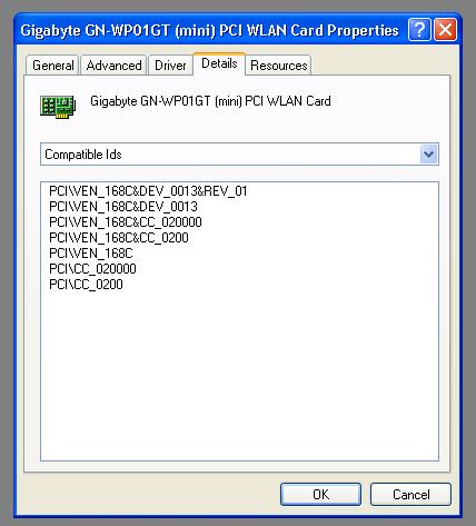

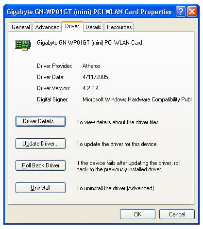

AlphaCool Posted January 28, 2007 Share Posted January 28, 2007 Hi everyone, How are you? I am having big problems getting my wireless card to work with 10.4.8 Intel AMD SSE2 SSE3 DVD. I am trying to post as much information as I can. I am using Gigabyte GN-WP01GT (Mini) PCI WLAN Card. It is running on Atheros AR5005GS Chipset. I read through many forum and tried to modified all the plist files without any success. I tried http://forum.insanelymac.com/index.php?sho...mp;#entry238508 and http://forum.insanelymac.com/index.php?s=&...st&p=263367 Nothing seem working. I also attacted files that I modified. First one is info.plist. It is from /System/Library/Extensions Second is within the /Library/Preferences/SystemConfiguration (I can not find Networkinterfaces.plist, so I modified preferences.plist) And I also attach two images regarding my wireless network card. Can anyone please help me I would like to go online.... Irwin K. Info_plist.txt preferences_plist.txt Link to comment https://www.insanelymac.com/forum/topic/40198-gigabyte-wireless-card/ Share on other sites More sharing options...
DiaboliK Posted January 28, 2007 Share Posted January 28, 2007 you have to edit the info.plist of the AppleAtheros5XXX.kext you can find that by opening finder and selecting your HD> System> Library> Extensions> IO80211Famliy.kext once you get to the IO80211Family.kext control-click or right click and show package contents> Contents> Plugins then do the same. show package contents of the AppleAtheros5XXX.kext and then open up the info.plist in text edit find this string: >168c,XX</ and insert your's which is: >168c,13</ then save it or save as and save it to the desktop as info.plist now open terminal and type in: sudo -s then you password (hit enter) now type in: sudo chmod -R 755 /System/Library/Extensions/IO80211Family.kext (hit enter) sudo chown -R root:wheel /System/Library/Extensions/IO80211Family.kext (hit enter) Now type in: diskutil repairPermissions / (hit enter) let it do its thing now when its done. quit terminal then reboot now if you get the airport diamond in the menubar, open System Preferences (you can do that from the apple menu) now goto Network, if all went well a window should popup saying new port found : airport (click ok, then click apply now) then you have workin wireless if not you have to change the bsd name of the airport from en1 to en0 in the networkinterfaces.plist found in: your hd> Library> Preferences> SystemConfiguration> NetworkInterfaces.plist do the edit in text edit then save it then do another: diskutil repairPermissions / (in terminal) then reboot and try the Network Preference pane step again. Link to comment https://www.insanelymac.com/forum/topic/40198-gigabyte-wireless-card/#findComment-286969 Share on other sites More sharing options...
