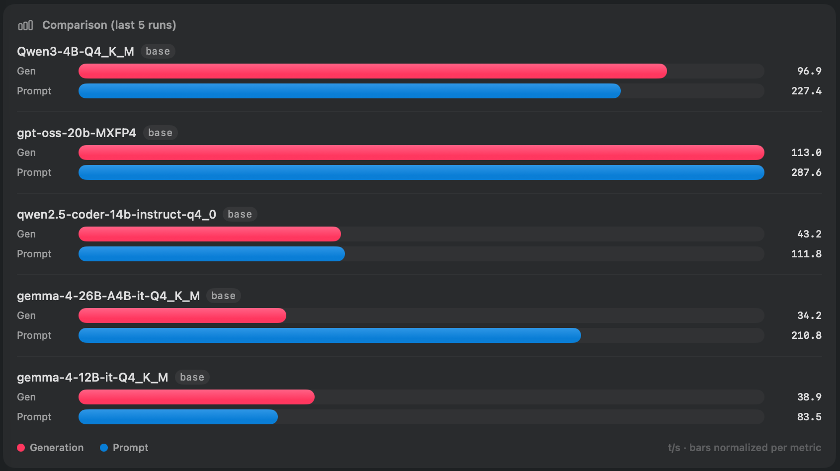

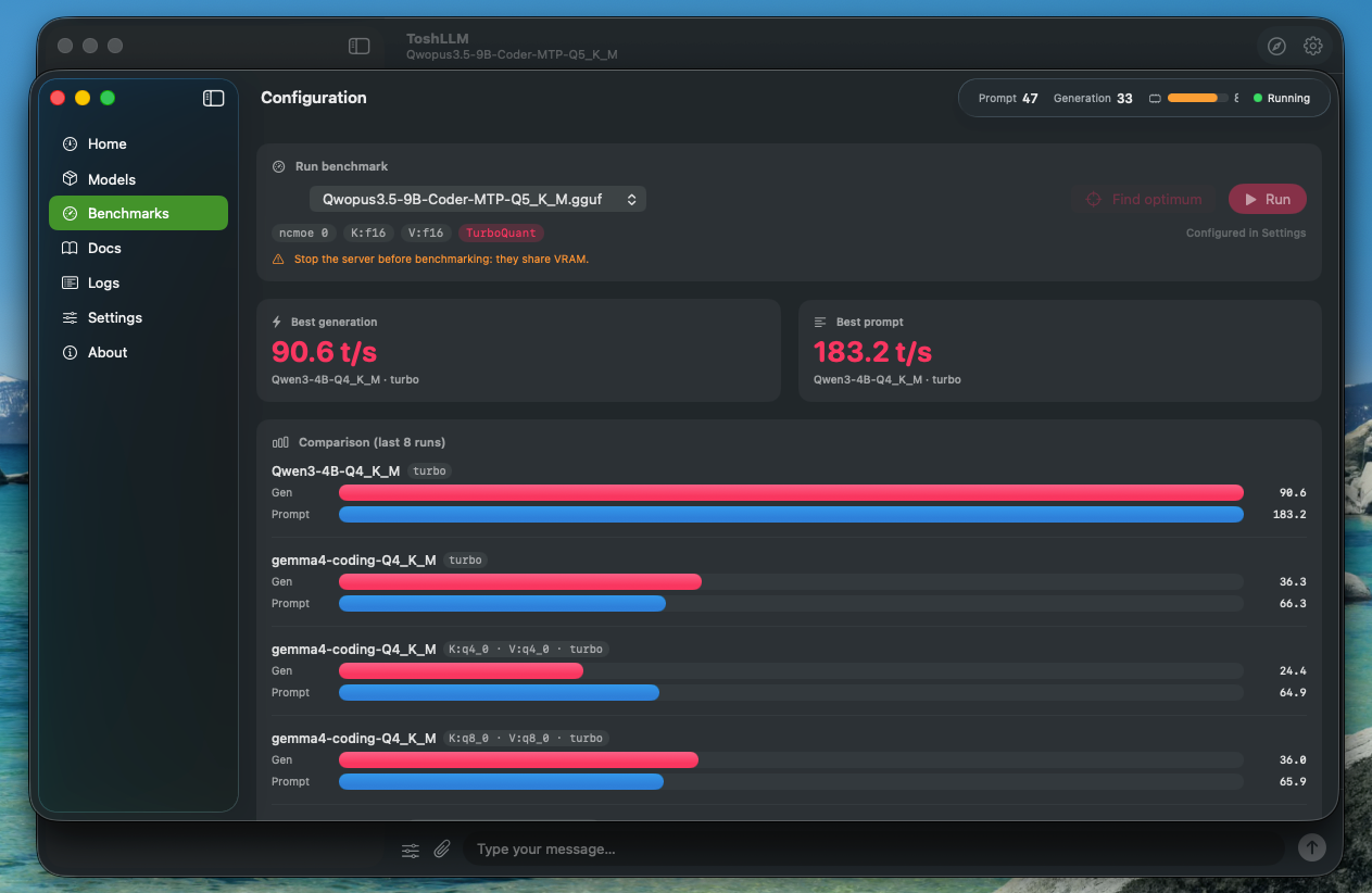

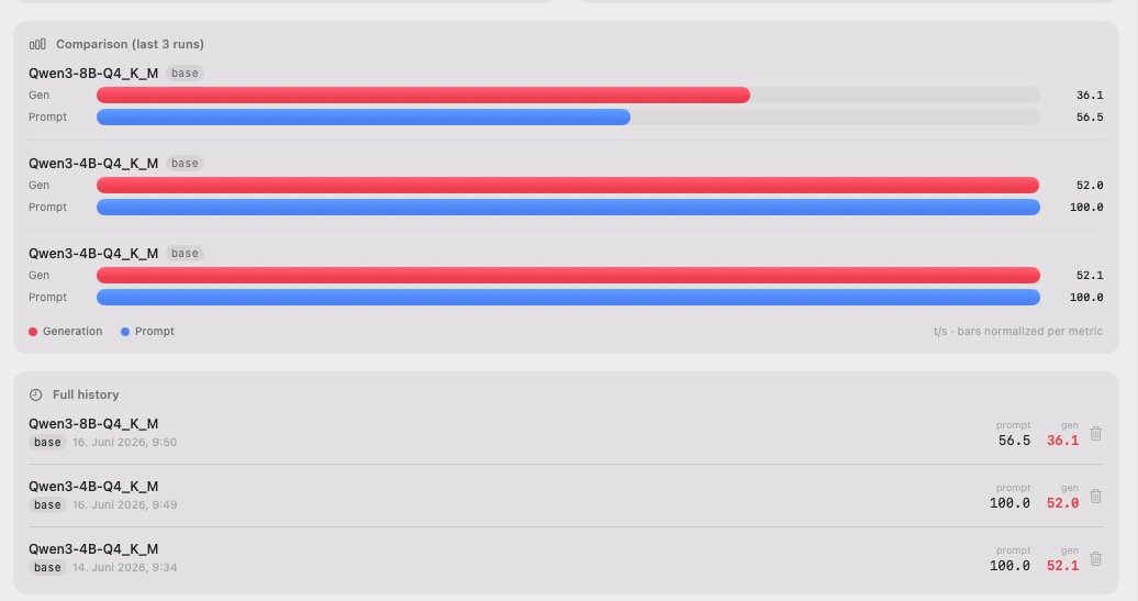

mitch_de Posted 6 hours ago Share Posted 6 hours ago Hi, worked on my Hackintosh with RX 5600 XT - I5 12400F 4,8 GHZ OC DDR5 ( and Macbook Pro RX560x - but very slow) The smallest LLM gave 52.1 / 100.0 in the benchmark . close to your 6700XT? Mobile RX 560X on MacbookPro Quote Link to comment https://www.insanelymac.com/forum/topic/362881-app-toshllm-%E2%80%94-local-llms-on-intel-amd-gpu-metal-amd%E2%80%91patched-llamacpp-open-source/#findComment-2851061 Share on other sites More sharing options...
engeldlgado Posted 3 hours ago Author Share Posted 3 hours ago (edited) Nice, thanks for testing! That RX 5600 XT result is genuinely great. Just a heads-up for the comparison: you ran Qwen3-4B, while my 101/57 numbers are for the bigger Qwen3-8B — so not quite the same test. Your prompt speed basically matches my 6700 XT; generation is a bit lower because it's bandwidth-bound and the 5600 XT has less memory bandwidth (no Infinity Cache). It'll fit the 8B fine too (4.7 GB) if you want a direct apples-to-apples run — and your DDR5 + 12400F will really shine on the bigger MoE models. The MacBook's RX 560X being slow is expected — that's an old Polaris chip with very little VRAM and bandwidth, so generation falls off a cliff (the model can't really stay resident on the GPU). Prompt still looks OK because it's batched, but ~1 t/s gen is just the card showing its age. The 5600 XT is the one to use. For that 4B model i got 68 t/s | 146 t/s on the RX 6700 XT If you grab the 8B and share the numbers, I'd love to add the RX 5600 XT as a tested card. Appreciate the report! Edited 3 hours ago by engeldlgado Quote Link to comment https://www.insanelymac.com/forum/topic/362881-app-toshllm-%E2%80%94-local-llms-on-intel-amd-gpu-metal-amd%E2%80%91patched-llamacpp-open-source/#findComment-2851062 Share on other sites More sharing options...
