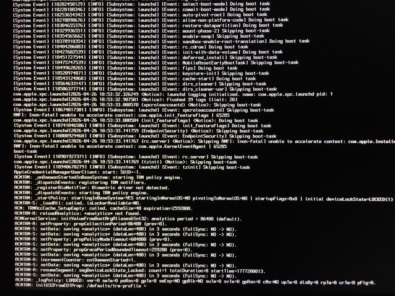

I upgraded from Sequoia to Tahoe via Software Update and I can't get the computer to finish booting. It was working perfectly with Sequoia.
I already tried updating OpenCore to the latest version 1.0.7 with its respective kexts. I previously updated the USBMap.kext to be compatible with Tahoe.
I also tried configuring the BIOS as if I were installing from a USB drive, disabling VT-d and everything else.
It gets to the point where the verbose boot shows it loading the ACMTRM stage and then it gets stuck. The same thing happens when booting from a USB installer.

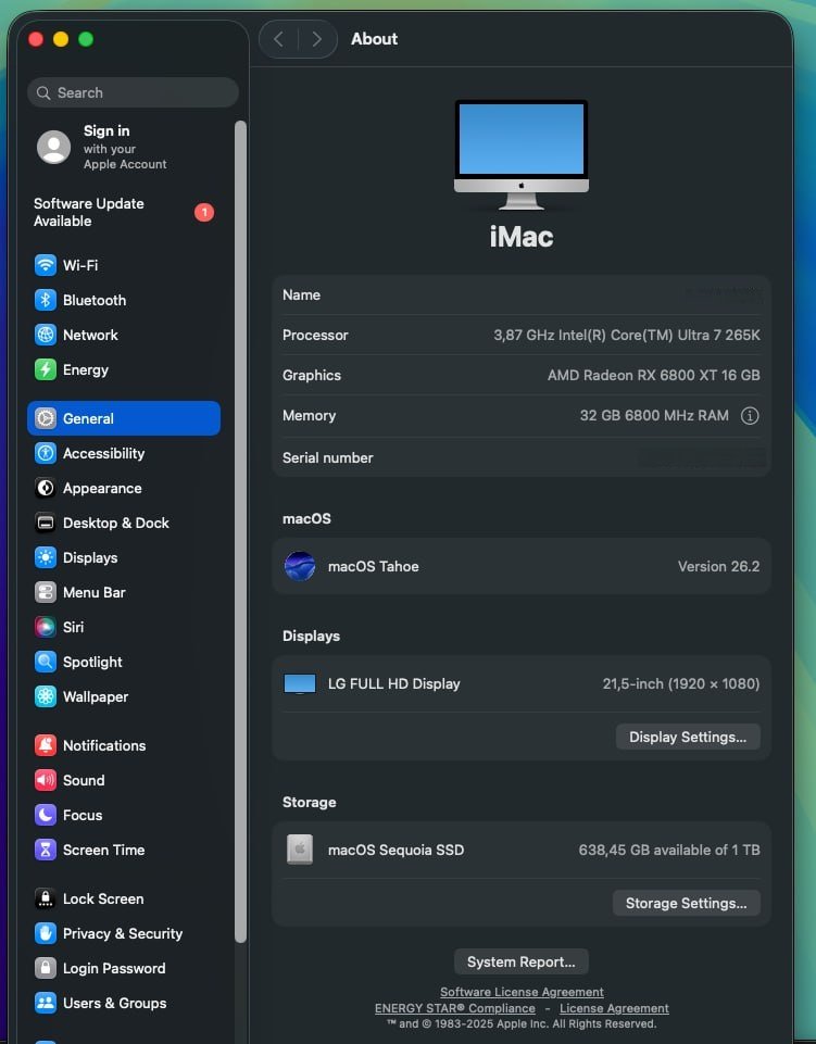

But I followed a recent suggestion from a user on a well-known forum to change the model from MacPro7,1 to iMac20,2, and to my surprise, it worked, displaying the Tahoe welcome assistant.
I only had to disable my previous USB mapping and enable USBInjectAll + XHCI-unsupported and the XhciPortLimit quirk.

Solved with AppleMCEReporterDisabler.kext.
ProvideCurrentCpuInfo now supports Arrow Lake according to the commits of the latest OpenCore version, so no more need for CPUTopologyRebuild.kext.
In my case, using OpenCore MOD, the ACPI conditional patch is also unnecessary.

Booting was impossible except with iMac20,2 smbios. When added AppleMCEReporterDisabler.kext there was no more hang by ACMTRM, if I deactivate the AppleMCEReporterDisabler.kext it does not boot with MacPro7,1.
Days later, doing research in the latest github commits, I activated the ProvideCurrenCpuInfo quirk that was updated in OC 1.0.7 for Arrow Lake and yesterday after installing OC MOD 1.0.8 I deactivated the patch that removes the ACPI conditionals present in the BIOS of the 800 series motherboards, since OC MOD 1.0.8 supposedly includes more features than the official version, and for my surprise it booted.
