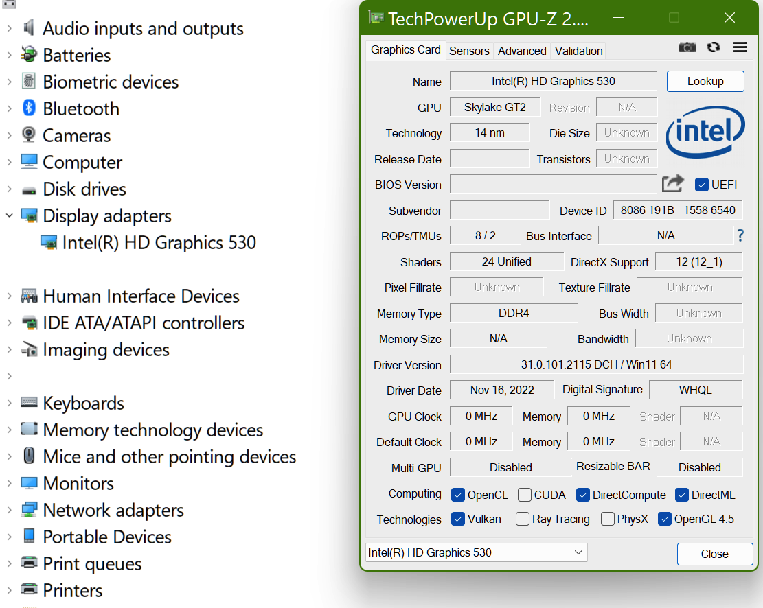

Sabotender Posted April 5 Author Share Posted April 5 Hello Vertech, I am thankful of your interest in my thread. It is the strangest thing. I tried that USB tool that would create a kext for my setup (ya know, where you plug a USB 2.0 device in all ports, and the 3.0 device in only those specific ports) to no avail, so I might need to patch it myself, or try a different tool. The iGPU is 💯 active, because I went into my BIOS to verify that the video adapter is in shared mode. Then, while booted in Windows 11, I first verified that in the Device manager, it first showed my irrelevent dGPU, and the Generic VGA Adapter. I downloaded the intel HD530 Graphics driver directly from the Intel website, installed, and finally showS the correctly named iGPU, which I have attached below. II need to disable the worthless dGPU, and fake the HD530 to the Kaby Lake HD630 Graphics. I am not fully certain which SMBIOS to use because those who had success were using different ones from 14.1 to 14.3, 16.x, etc. Not sure which VRAM to set. I have a SD card slot that worked in my previous High Sierra setup, so I would like to get it working again. My Laptop has 64GB DDR3 RAM, 4 slots. I am installing Ventura to a non-NVME M.2 SSD. I have a Touch-ID keyboard, which should work via bluetooth or USB since its just a driver, but I'm not completely certain. I've attached that screenshot from Windows Device Manager to prove this iGPU is present, and the Clover config.plst I had been working on. At the moment, I had been reading the general docs for Clover and guides for faking Skylake to Kaby Lake. Oh, I verified this with GPU-z, which I have also attached for reference. I hope this helps, Sabotender config.plist Link to comment https://www.insanelymac.com/forum/topic/362594-booting-ventura-using-clover-with-technically-unsupported-hardware-faking-required/#findComment-2848746 Share on other sites More sharing options...
