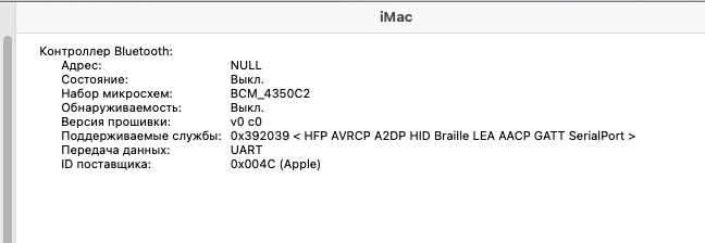

AlfredoM Posted March 4 Share Posted March 4 (edited) Ghost Apple Bluetooth UART Device in Hackintosh System Information. in macOS Sequoia 15.7.4 This is how it appears in the system report for Bluetooth. Bluetooth-Controller: Adresse: NULL Status: Aus Chipsatz: BCM_4350C2 Sichtbar: Aus Firmwareversion: v0 c0 Unterstützte Dienste: 0x392039 < HFP AVRCP A2DP HID Braille LEA AACP GATT SerialPort > Transport: UART Hersteller-ID: 0x004C (Apple) In my newly set up Hackintosh (see signature), I'm unable to install any Bluetooth USB devices from various manufacturers, some with Broadcom chips and others with Realtek chips. Whether I use an SMBIOS like MacPro7,1, iMac 19,2, or iMac19,1, an Apple UART Device always appears in the system information. It's set to "off" and isn't related to any Bluetooth hardware, which my motherboard doesn't have. This ghost Bluetooth device blocks all attempts to install a Bluetooth USB stick, and USB is correctly mapped using a 100% working USPPorts.kext. Does anyone here have the same motherboard running with Bluetooth working? I would greatly appreciate any information on this. Regards, AlfredoM Edited March 4 by AlfredoM Link to comment https://www.insanelymac.com/forum/topic/362471-ghost-apple-bluetooth-uart-device-in-hackintosh-system-information/ Share on other sites More sharing options...

Slice Posted March 24 Share Posted March 24 I also have this ghost although I never had bluetooth and my history is clear as the conscience of a newborn baby. As well as any type of cache. 2 Link to comment https://www.insanelymac.com/forum/topic/362471-ghost-apple-bluetooth-uart-device-in-hackintosh-system-information/#findComment-2848386 Share on other sites More sharing options...
AlfredoM Posted March 24 Author Share Posted March 24 (edited) Thanks, good friend Scheibe, and how can I solve this problem? I've already tried three different SMBIOS versions: Mac Pro 7.1.1, iMac 19.1, and iMac Pro 1.1.1. This Bluetooth entry simply won't disappear and is now blocking my Intel A210 PCI Express card. What kind of motherboard do you have? Edited March 24 by AlfredoM Link to comment https://www.insanelymac.com/forum/topic/362471-ghost-apple-bluetooth-uart-device-in-hackintosh-system-information/#findComment-2848393 Share on other sites More sharing options...
