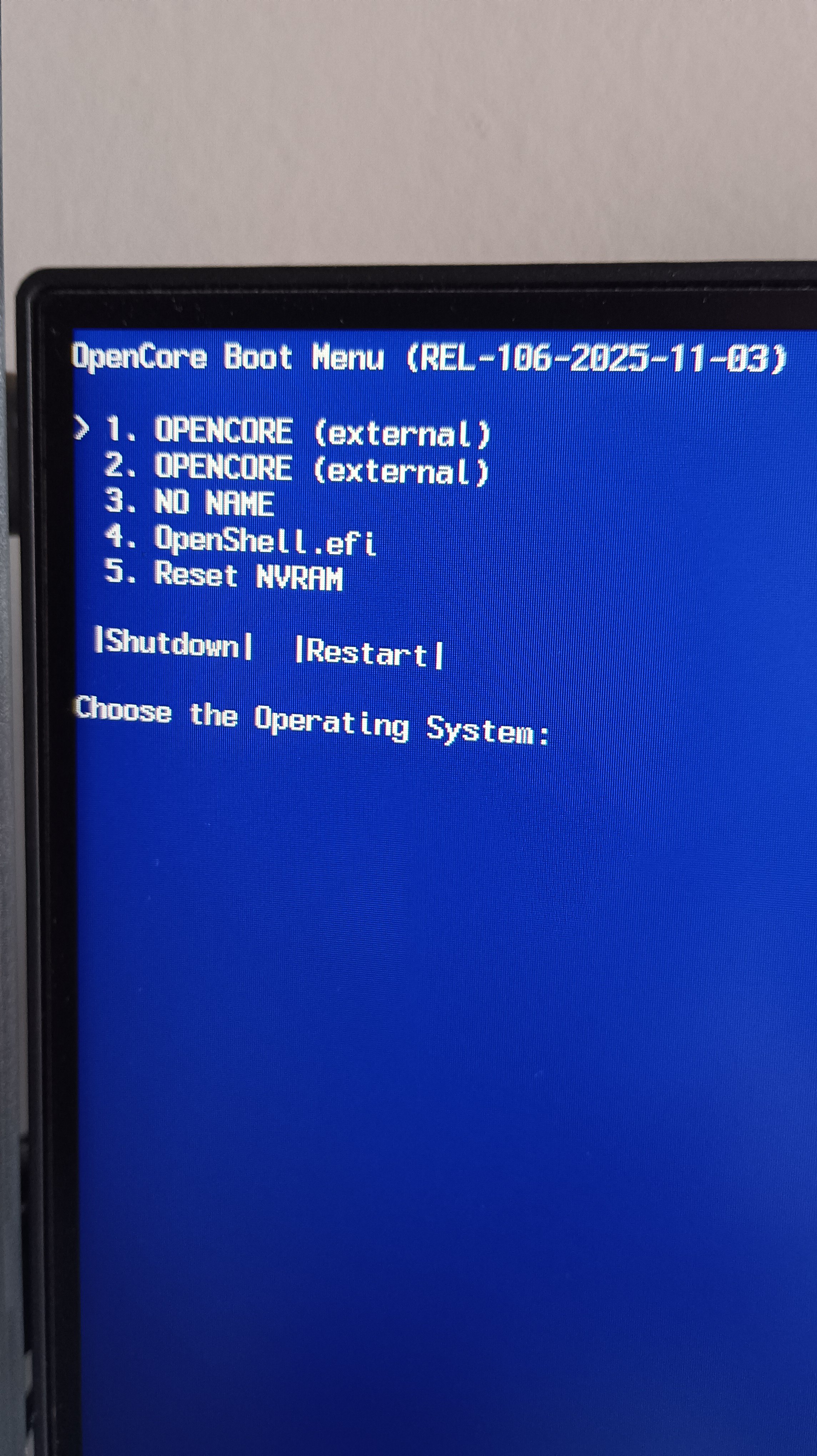

indibil Posted January 18 Author Share Posted January 18 Hi, I've been making "fixes" to the errors OCAuxiliaryTools was giving me regarding the config.plist file, and I've also updated the kext and OpenCore to the latest version. But now I can't boot from the DMG file. I only have two options: External, and neither of them boots from the .dmg file on the USB drive. Do you know what I might have changed that's preventing it from recognizing the recovery folder? Thanks EFI Revised Link to comment https://www.insanelymac.com/forum/topic/362214-a-newbies-problems-with-opencore-prodesk-g4-400-sff/#findComment-2846571 Share on other sites More sharing options...
Asural Posted January 18 Share Posted January 18 50 minutes ago, indibil said: Hi, I've been making "fixes" to the errors OCAuxiliaryTools was giving me regarding the config.plist file, and I've also updated the kext and OpenCore to the latest version. But now I can't boot from the DMG file. I only have two options: External, and neither of them boots from the .dmg file on the USB drive. Do you know what I might have changed that's preventing it from recognizing the recovery folder? Thanks The OpenCore Menu is displayed, but it seems the USB is not recognized. If you create UTBMap.kext in Windows with USBToolx, it will be compatible with Catalina through Sequoia. It appears you're booting with OpenCore 1.6.0, but the EFI configuration is different, so try duplicating OpenCore-1.0.6/X64/EFI and building it again. We recommend reading this guide and creating the required ACPI with SSDTTime post-install in Windows. Link to comment https://www.insanelymac.com/forum/topic/362214-a-newbies-problems-with-opencore-prodesk-g4-400-sff/#findComment-2846572 Share on other sites More sharing options...
indibil Posted January 18 Author Share Posted January 18 21 minutes ago, Asural said: The OpenCore Menu is displayed, but it seems the USB is not recognized. If you create UTBMap.kext in Windows with USBToolx, it will be compatible with Catalina through Sequoia. It appears you're booting with OpenCore 1.6.0, but the EFI configuration is different, so try duplicating OpenCore-1.0.6/X64/EFI and building it again. We recommend reading this guide and creating the required ACPI with SSDTTime post-install in Windows. Thanks for replying. The problem is that I only have Linux on this machine, and I'll only be replacing it with Ventura. Before repairing config.plist, it showed me the option to boot from DMG. So, with OpenCore 1.0.6, do I need a different folder structure? I'm really bad at this stuff. Link to comment https://www.insanelymac.com/forum/topic/362214-a-newbies-problems-with-opencore-prodesk-g4-400-sff/#findComment-2846573 Share on other sites More sharing options...
Asural Posted January 18 Share Posted January 18 25 minutes ago, indibil said: Thanks for replying. The problem is that I only have Linux on this machine, and I'll only be replacing it with Ventura. Before repairing config.plist, it showed me the option to boot from DMG. So, with OpenCore 1.0.6, do I need a different folder structure? I'm really bad at this stuff. If you're using Linux, you should be able to create a USB installation of Windows 10 or 11 from FireFox by going to the Microsoft download page. If you're using an HP machine, you can authenticate it for free automatically or with HP Support Assistant, so give it a try. Link to comment https://www.insanelymac.com/forum/topic/362214-a-newbies-problems-with-opencore-prodesk-g4-400-sff/#findComment-2846574 Share on other sites More sharing options...

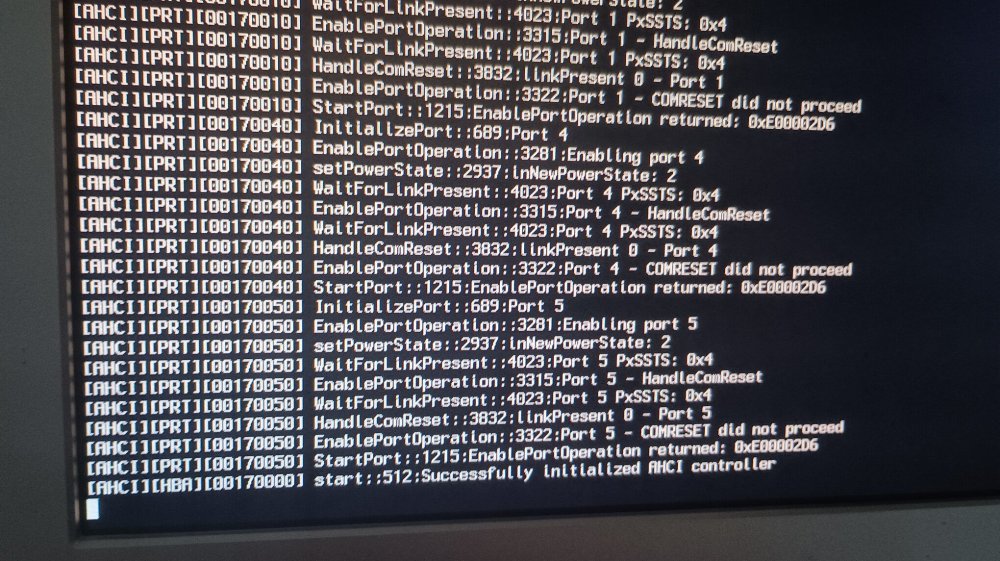

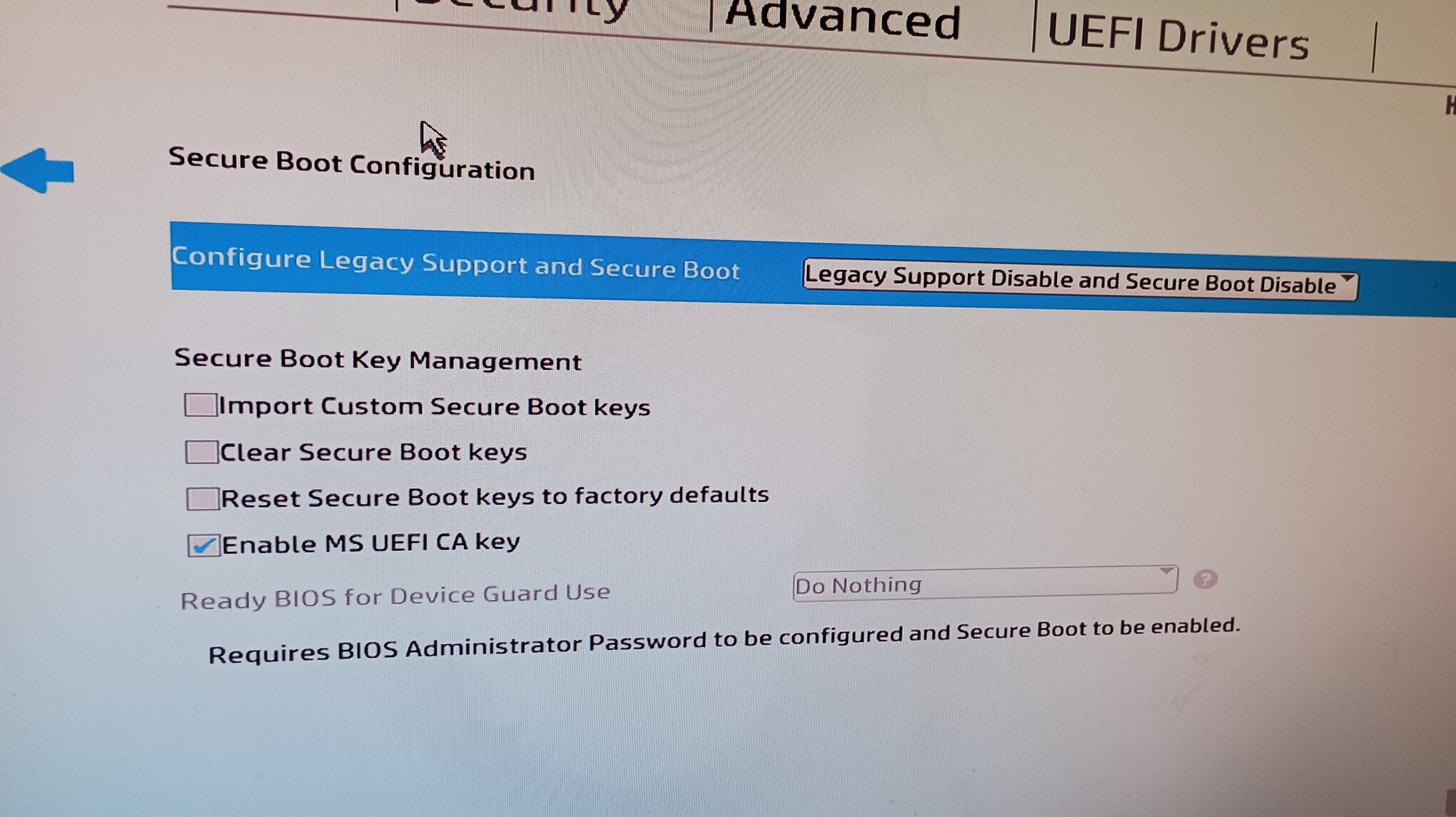

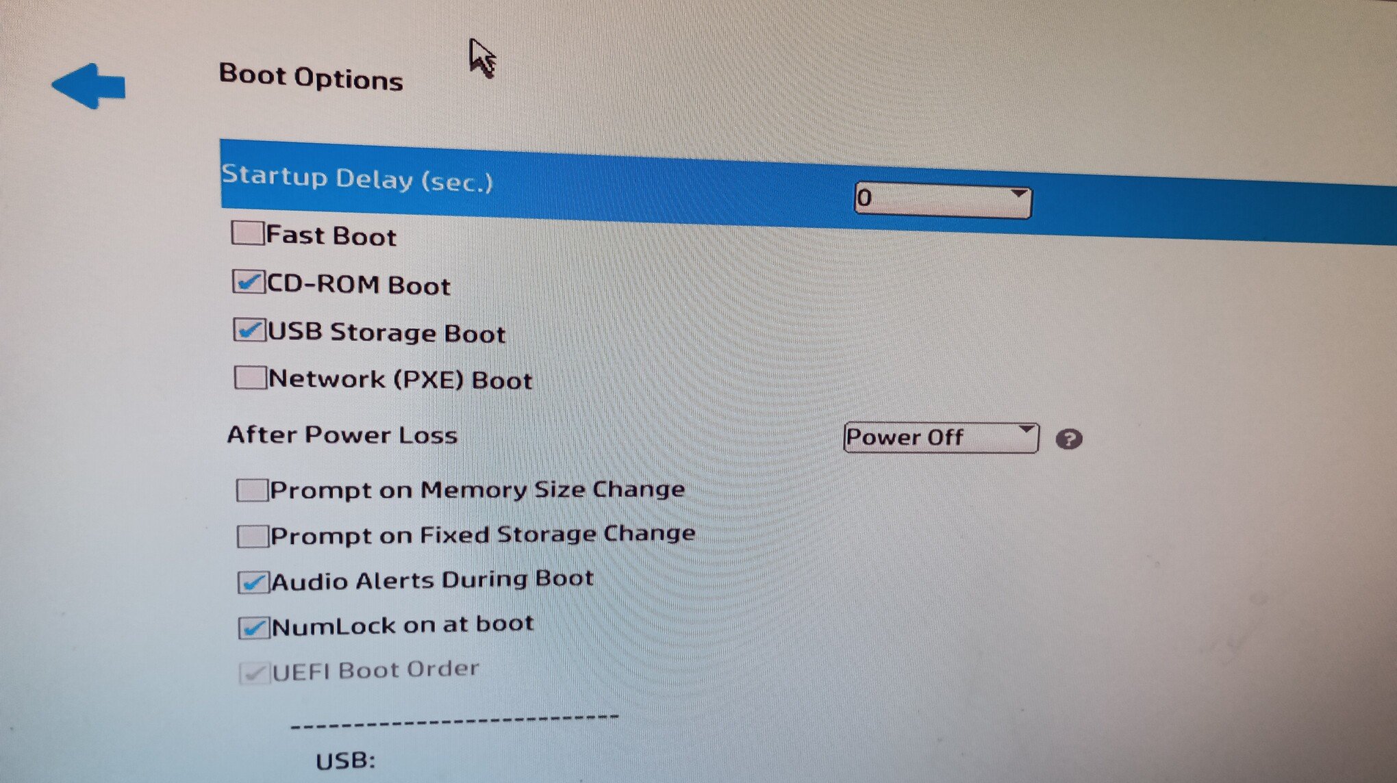

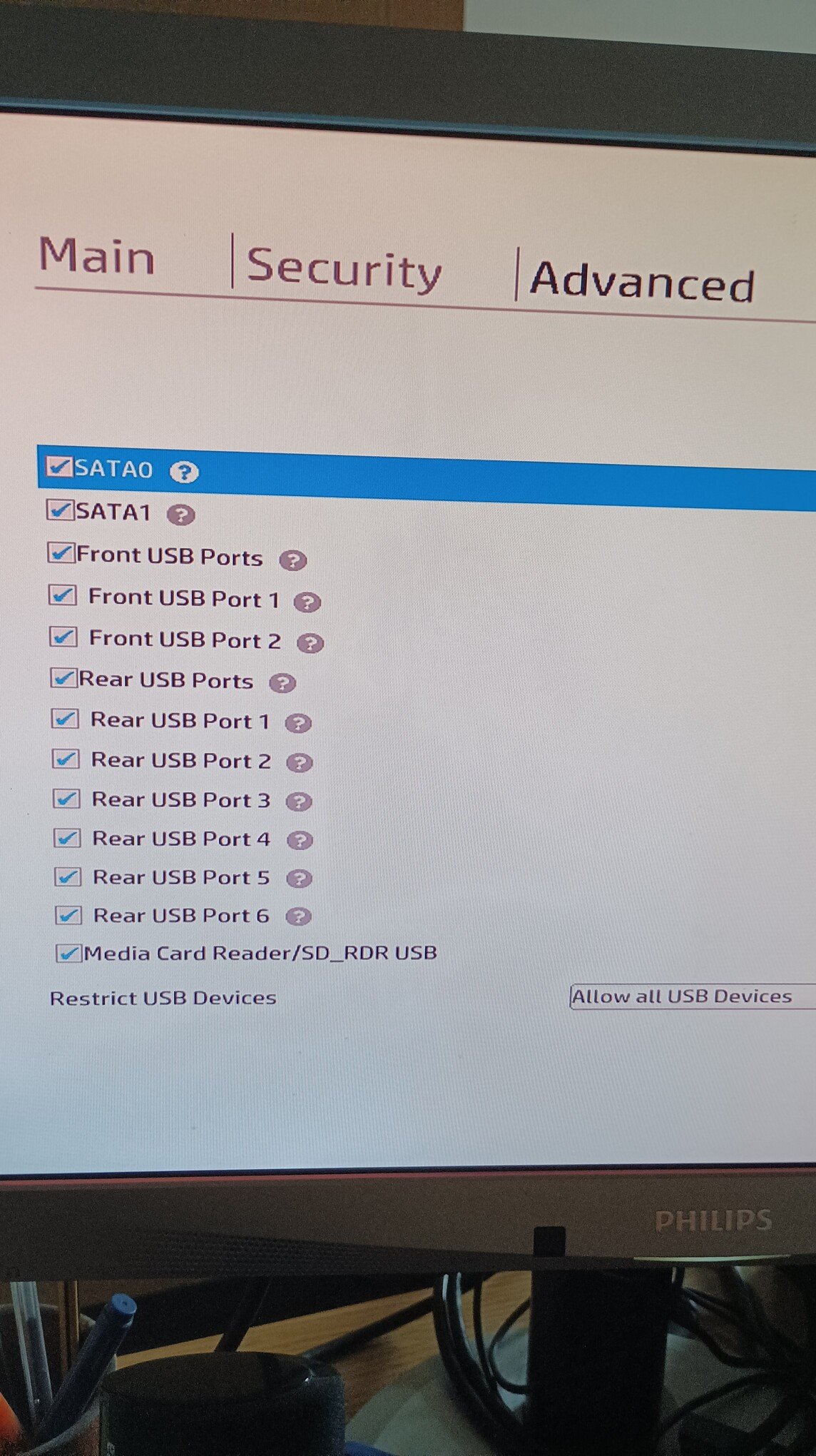

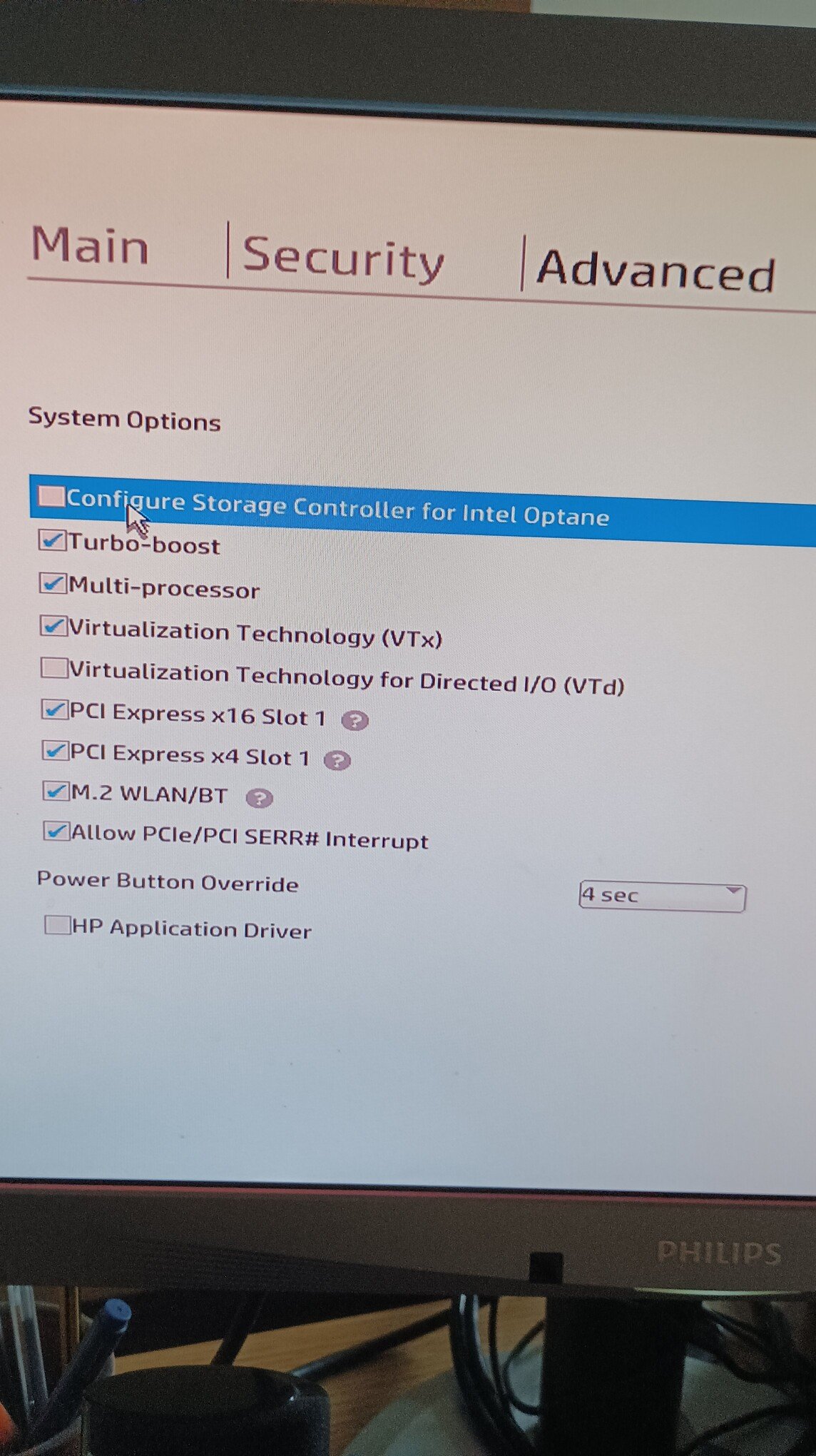

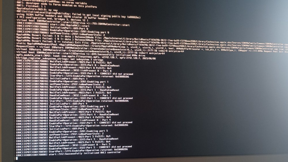

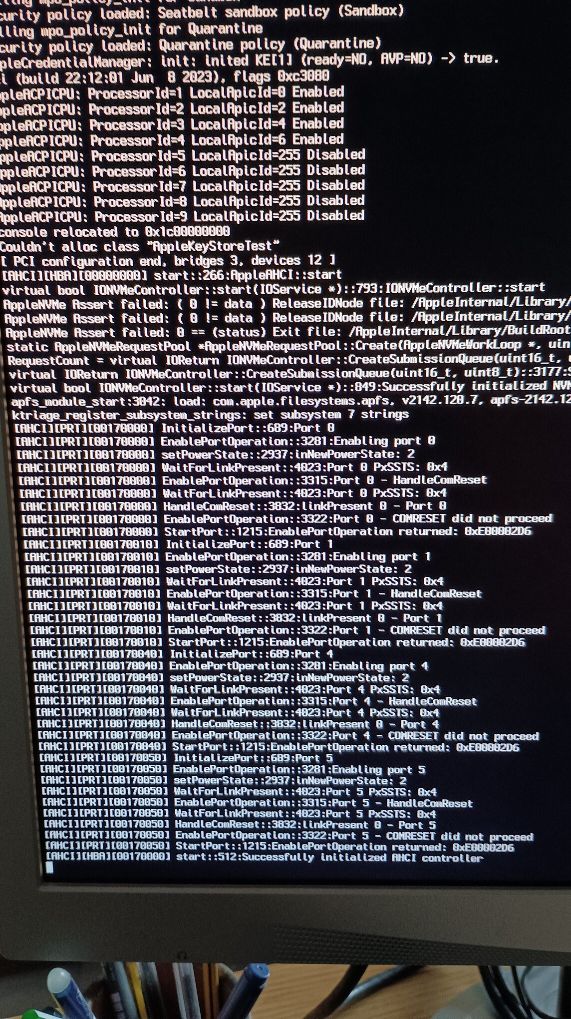

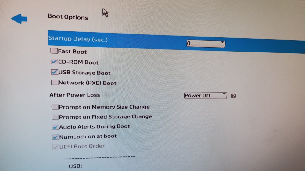

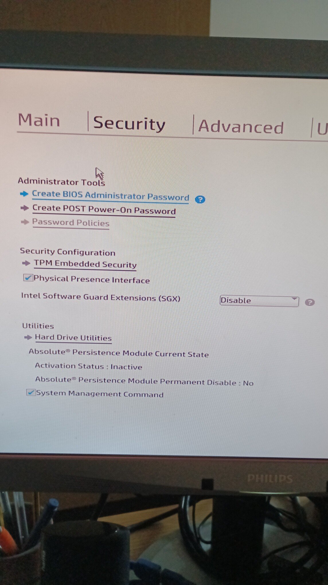

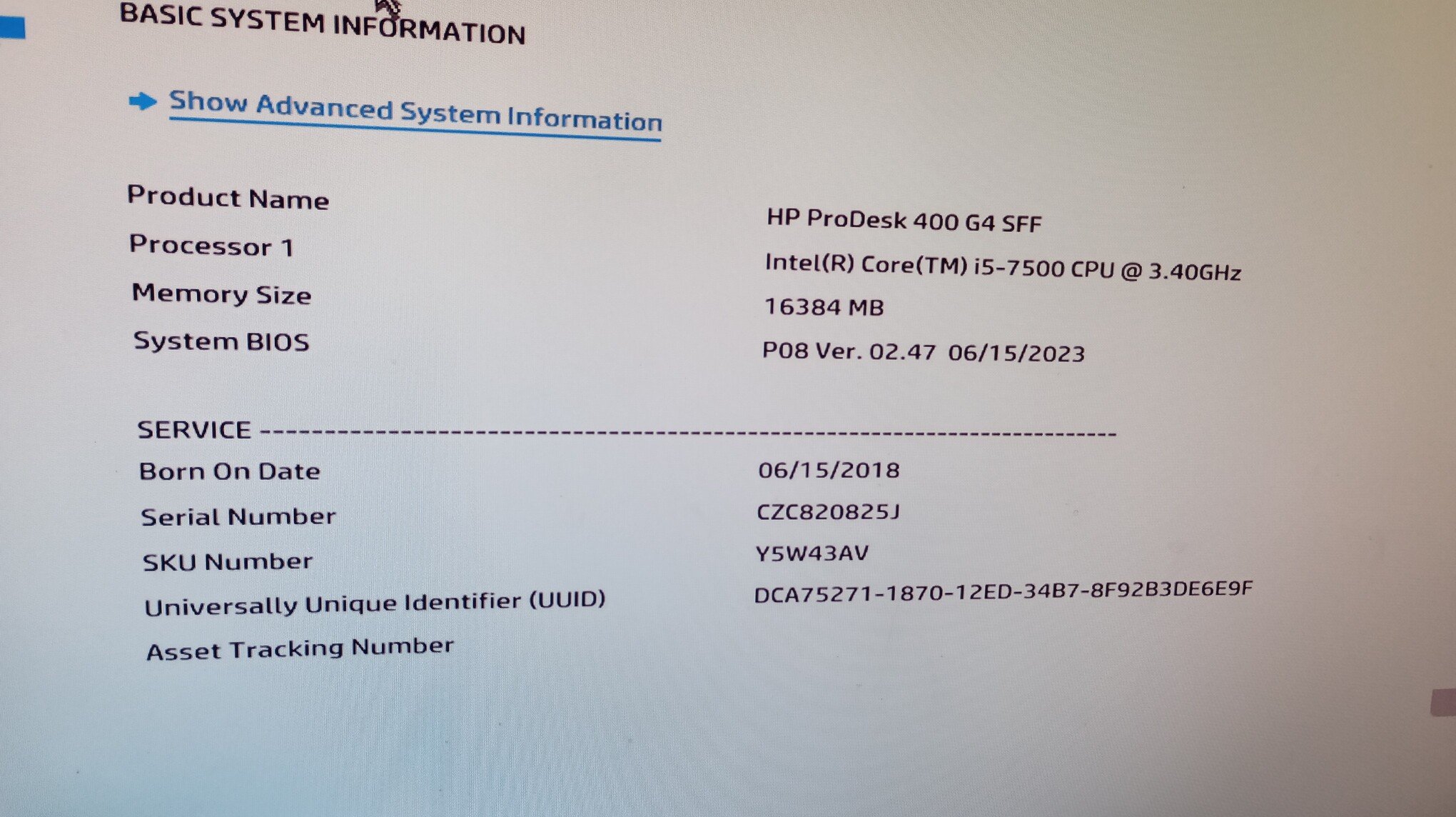

indibil Posted January 19 Author Share Posted January 19 Hello. I've been testing it, and every time I manage to get it to start, I always get stuck at the same point: I'm starting to suspect there might be something wrong with the BIOS. I've taken some pictures. Could you take a look and see if I have any incorrect settings? I've lost count of how many things I've changed. Thanks!! Link to comment https://www.insanelymac.com/forum/topic/362214-a-newbies-problems-with-opencore-prodesk-g4-400-sff/#findComment-2846662 Share on other sites More sharing options...

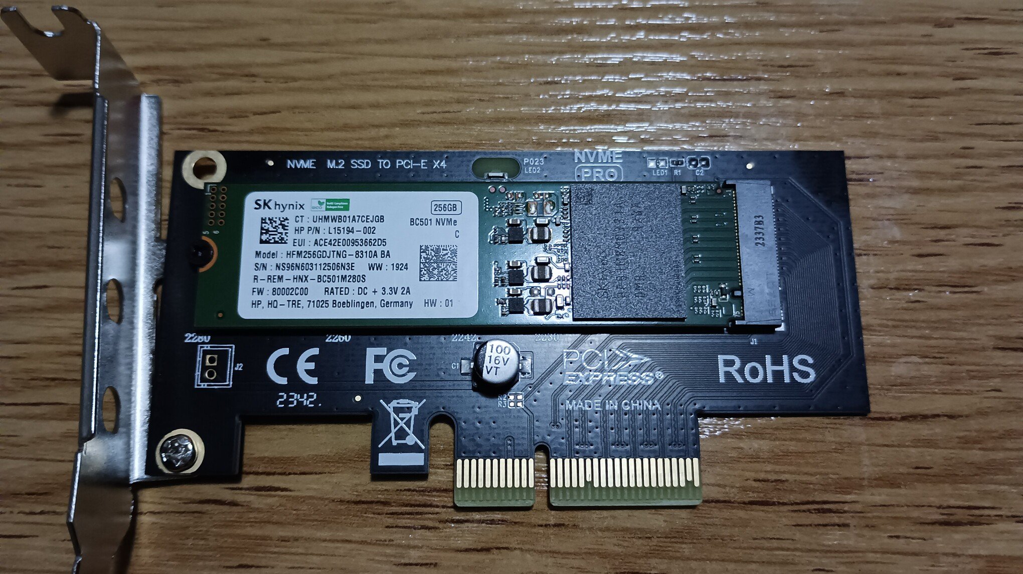

indibil Posted January 19 Author Share Posted January 19 I tried removing the NVMe drive and the result is the same. This is my NVMe hard drive. 1 Link to comment https://www.insanelymac.com/forum/topic/362214-a-newbies-problems-with-opencore-prodesk-g4-400-sff/#findComment-2846664 Share on other sites More sharing options...
deeveedee Posted January 19 Share Posted January 19 (edited) 8 minutes ago, indibil said: I tried removing the NVMe drive and the result is the same. If you removed the NVMe drive and you still can't boot your USB, then you have eliminated the NVMe drive as your immediate problem. Just know that SK Hynix drives have been known to cause problems with macOS. You may want to boot Windows with your NVMe drive and check to see if there are any firmware updates for it. EDIT: Have you tried booting with other USB thumb drives? EDIT2: Have you tried booting the Big Sur installer just to see if that works (since the repo you copied appears to have last been tested with Big Sur)? Edited January 19 by deeveedee Link to comment https://www.insanelymac.com/forum/topic/362214-a-newbies-problems-with-opencore-prodesk-g4-400-sff/#findComment-2846665 Share on other sites More sharing options...
indibil Posted January 20 Author Share Posted January 20 14 hours ago, deeveedee said: If you removed the NVMe drive and you still can't boot your USB, then you have eliminated the NVMe drive as your immediate problem. Just know that SK Hynix drives have been known to cause problems with macOS. You may want to boot Windows with your NVMe drive and check to see if there are any firmware updates for it. EDIT: Have you tried booting with other USB thumb drives? EDIT2: Have you tried booting the Big Sur installer just to see if that works (since the repo you copied appears to have last been tested with Big Sur)? Alright. For now, I'm going to focus on getting the installer to start, then I'll see if the NVME works for me or if I need to look for another one. I installed this one because I had it unused, it's not a high-performance drive. From the previous BIOS photos, I don't know what could be wrong. Link to comment https://www.insanelymac.com/forum/topic/362214-a-newbies-problems-with-opencore-prodesk-g4-400-sff/#findComment-2846678 Share on other sites More sharing options...
Asural Posted January 20 Share Posted January 20 19 hours ago, indibil said: Hello. I've been testing it, and every time I manage to get it to start, I always get stuck at the same point: I'm starting to suspect there might be something wrong with the BIOS. I've taken some pictures. Could you take a look and see if I have any incorrect settings? I've lost count of how many things I've changed. Thanks!! It seems to be stuck on WEG, what is the connection between the PC and the monitor? Link to comment https://www.insanelymac.com/forum/topic/362214-a-newbies-problems-with-opencore-prodesk-g4-400-sff/#findComment-2846687 Share on other sites More sharing options...
