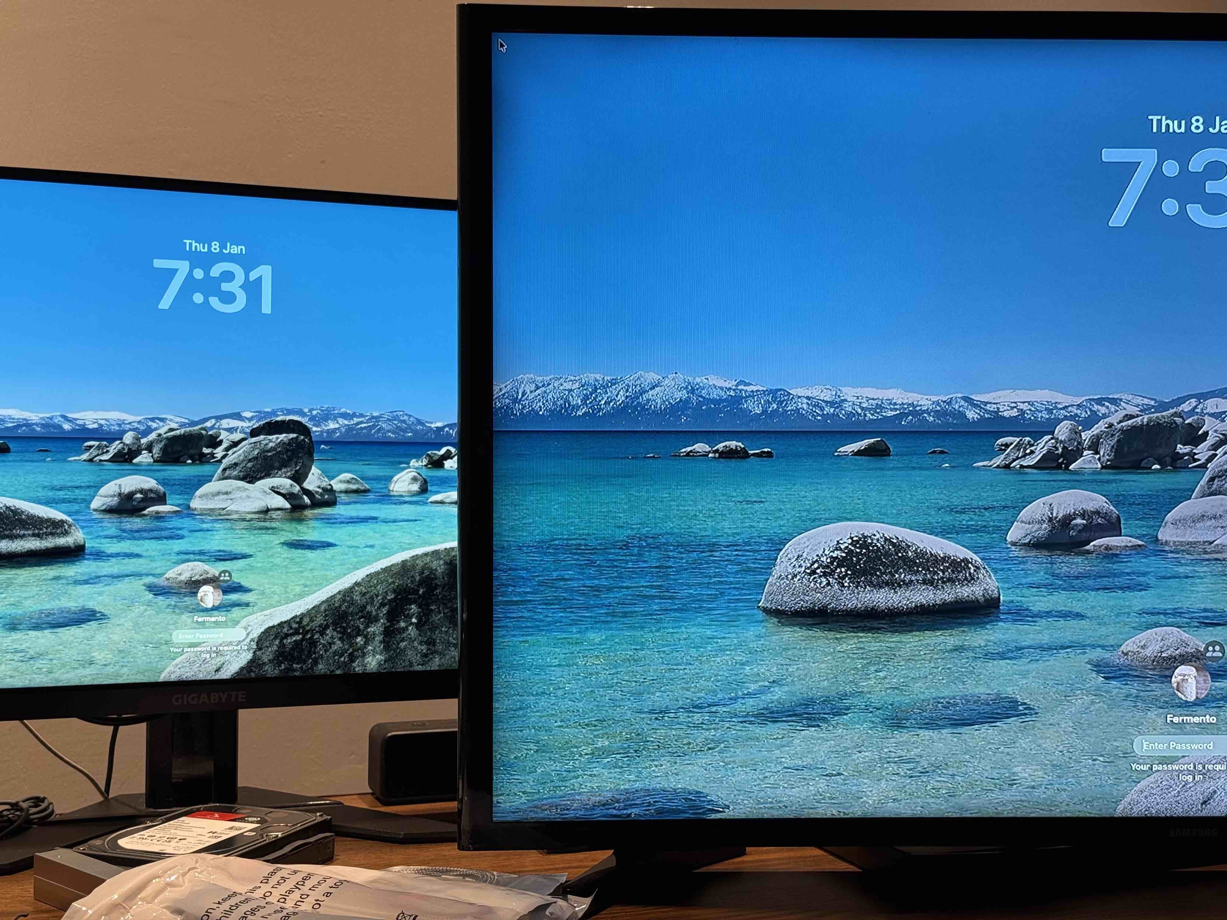

fermento Posted January 8 Author Share Posted January 8 (edited) Hello, how are you? Since I can't understand how @verdazil came to these conclusions, I ran multiple tests again with your configuration (config-UH60). Single Display Tests: Gigabyte M27Q through DP -> working flawless Gigabyte M27Q through HDMI -> working flawless Samsung Tv through HDMI -> working flawless Dell through HDMI -> DVI adapter -> working flawless Multi Display Tests: Gigabyte M27Q through DP + Samsung Tv through HDMI -> flickering issues .... endlessly loop to stabilize (3 minutes and counting), ended up unplugging the HDMI from the motherboard and plugging again with occurs in an instantly stabilization. Gigabyte M27Q through DP + Dell through HDMI -> DVI -> flickering issues, stabilized around 1 minute. So, after the tests, MY CONCLUSION is that there are no hardware problems, neither the Dell monitor, neither the adapter, neither the cable. @deeveedee Let me know if you come to the same conclusion or a different one. Demos attached below in SUPER low quality and fps dropped for size purpose. If someone needs the real data we can see how to share them. multi-display-gigabyte-dell.mp4 muti-display-gigabyte-samsung.mp4 Edited January 8 by fermento Typo 1 Quote Link to comment https://www.insanelymac.com/forum/topic/362084-tahoe-intel-udh-630-dual-monitor-problems/page/8/#findComment-2846091 Share on other sites More sharing options...

fermento Posted January 9 Author Share Posted January 9 8 hours ago, verdazil said: There are hardware issues, but they're not critical. During boot, macOS struggles to find a working video mode. While it's doing this, there are delays, flickering, and so on. My monitors are new and more compatible with macOS. I use high-quality cables and don't use any adapters. macOS boot is smooth, synchronous on both monitors, without delays or flickering. Ok, seems that you have a Mac without logo not a hackintosh because your hardware is high quality and 100% compatible with macOS. Despite that, I don't see any oficial list from Apple for External monitors compatibility. I assume they support all, not only the super new monitors, because that's the purpose of that feature "external monitors" not "external APPLE monitors". By the way, you are saying that the hardware has issues because, during the boot process, my computer has delays, flickering and so on. So, how do you explain that when I have only one display connected, I'm already logged in, and I connect the Dell display, has not issue at all, works flawlessly? I assume if my hardware has issues that should not be possible. @verdazil Beyond that, I think you've been a little rude to @deeveedee, and I don't see the need for it. We're all here trying to solve a problem with the hackintosh, contributing possible solutions. I don't see the point in fighting or thinking you're better or worse than someone else. Especially not in treating someone else badly. I hope we can all continue to seek solutions by treating each other well and, if we have any criticism, that it be constructive rather than destructive. 2 Quote Link to comment https://www.insanelymac.com/forum/topic/362084-tahoe-intel-udh-630-dual-monitor-problems/page/8/#findComment-2846155 Share on other sites More sharing options...
