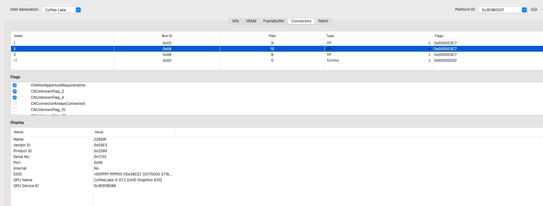

fermento Posted December 14, 2025 Share Posted December 14, 2025 (edited) UPDATE 2 - HDMI cable 2.1 - Displays - Gigabyte M27Q - 2560 x 1440 (QHD) - Dell E248WFP - 1920 x 1200 (FHD) UPDATE 1 Change the motherboard model to the correct one. Hi! I'm having issues with Tahoe in my Hackintosh, the second monitor power off when Tahoe starts. All previous versions of macOS work in my computer with dual monitor. HARDWARE DESCRIPTION Motherboard Gigabyte Z490 VISION G ATX LGA1200 revision 1.1 CPU Intel Core i7-10700 2.9 GHz 8-Core Processor Memory G.Skill Trident Z RGB 32 GB (2 x 16 GB) DDR4-3600 CL16 SSD Western Digital SN750 500 GB M.2-2280 NVME X 2 Wifi/BT fenvi FV-T919 PCIe x1 802.11a/b/g/n/ac Wi-Fi Adapter BCM94360CD Case Gigabyte C200 Glass ATX PSU SeaSonic FOCUS 750 W 80+ Gold Certified Semi-modular Here is my config.plist What I tried: igfxonln=1 igfxfw=2 cdfon no_compat_check I would appreciate any help 🙏 Edited January 7 by fermento Change motherboard model 2 Quote Link to comment https://www.insanelymac.com/forum/topic/362084-tahoe-intel-udh-630-dual-monitor-problems/ Share on other sites More sharing options...

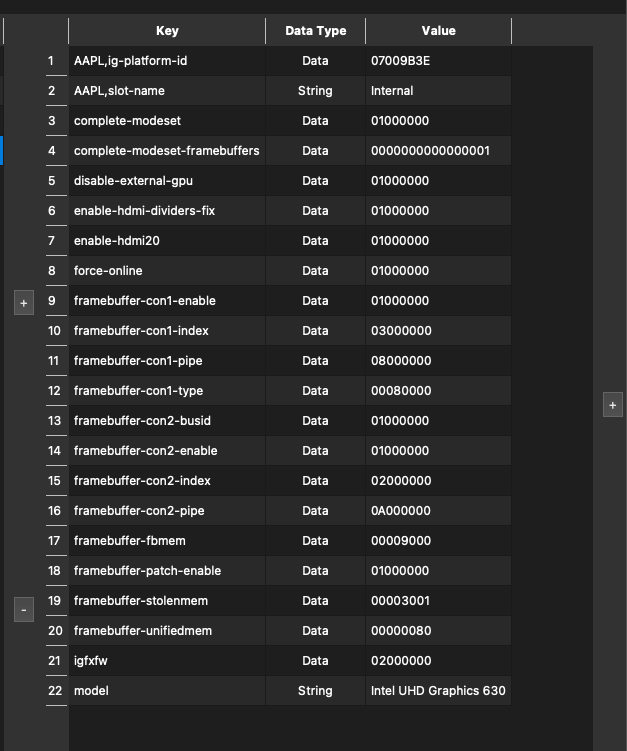

fermento Posted December 15, 2025 Author Share Posted December 15, 2025 What do you mean @MaLd0n? Is not what I have in my config? <key>PciRoot(0x0)/Pci(0x2,0x0)</key> <dict> <key>AAPL,ig-platform-id</key> <data>BwCbPg==</data> <key>AAPL,slot-name</key> <string>Internal</string> <key>device-id</key> <data>mz4AAA==</data> <key>force-online</key> <data>AQAAAA==</data> <key>framebuffer-con0-busid</key> <data>BQAAAA==</data> <key>framebuffer-con0-enable</key> <data>AQAAAA==</data> <key>framebuffer-con0-flags</key> <data>xwMAAA==</data> <key>framebuffer-con0-index</key> <data>AQAAAA==</data> <key>framebuffer-con0-pipe</key> <data>CQAAAA==</data> <key>framebuffer-con0-type</key> <data>AAQAAA==</data> <key>framebuffer-con1-busid</key> <data>BAAAAA==</data> <key>framebuffer-con1-enable</key> <data>AQAAAA==</data> <key>framebuffer-con1-flags</key> <data>xwMAAA==</data> <key>framebuffer-con1-index</key> <data>AwAAAA==</data> <key>framebuffer-con1-pipe</key> <data>CAAAAA==</data> <key>framebuffer-con1-type</key> <data>AAgAAA==</data> <key>framebuffer-con2-busid</key> <data>AQAAAA==</data> <key>framebuffer-con2-enable</key> <data>AQAAAA==</data> <key>framebuffer-con2-flags</key> <data>xwMAAA==</data> <key>framebuffer-con2-index</key> <data>AgAAAA==</data> <key>framebuffer-con2-pipe</key> <data>CgAAAA==</data> <key>framebuffer-con2-type</key> <data>AAQAAA==</data> <key>framebuffer-fbmem</key> <data>AACQAA==</data> <key>framebuffer-patch-enable</key> <data>AQAAAA==</data> <key>framebuffer-stolenmem</key> <data>AAAwAQ==</data> <key>framebuffer-unifiedmem</key> <data>AAAAgA==</data> <key>model</key> <string>Intel UHD Graphics 630</string> </dict> Quote Link to comment https://www.insanelymac.com/forum/topic/362084-tahoe-intel-udh-630-dual-monitor-problems/#findComment-2845024 Share on other sites More sharing options...
deeveedee Posted December 15, 2025 Share Posted December 15, 2025 @fermento I examined your graphics DeviceProperties. To help us understand your frame buffer patching strategy, please explain why you are doing the following: Swap the indices of con1 and con2, so that con1 index is 3 and con2 index is 2 Change con2 busid from 6 to 1 Swap con1 and con2 pipes, so that con1 pipe is 8 and con2 pipe is 10 Change con1 type from DP to HDMI set fbmem, stolenmem, unified mem Also, your DeviceProperties specify properties that don't change anything from the original definition of 3e9b0007. I have modified your config.plist (attached) to simplify the DeviceProperties, so that your properties are easier for me to understand. config.plist.zip 2 Quote Link to comment https://www.insanelymac.com/forum/topic/362084-tahoe-intel-udh-630-dual-monitor-problems/#findComment-2845030 Share on other sites More sharing options...

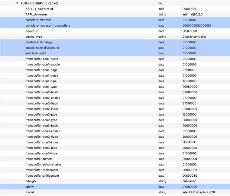

Max.1974 Posted December 15, 2025 Share Posted December 15, 2025 @fermento Maybe if you try using these patches in blue, you might be able to make it work. Remove all boot-args related to the iGPU, because they cause conflicts (they are the same as those in the device properties). 1 Quote Link to comment https://www.insanelymac.com/forum/topic/362084-tahoe-intel-udh-630-dual-monitor-problems/#findComment-2845036 Share on other sites More sharing options...

Max.1974 Posted December 15, 2025 Share Posted December 15, 2025 (edited) Hi my dear. After months and weeks of work, my final device-properties configuration is working perfectly. USB-C, Thunderbolt, and HDMI video output are all working on my Lenovo T14 ports. I believe this configuration works because, after studying it many times and running several tests, everything is now functioning correctly. 😃👊🏻 I also remember that the patches highlighted in blue in the left column must be followed, not the numbers of each iGPU. The bus ID sequence and port mapping, as well as the HDMI model (DVS / DP etc), must be respected. For each configuration, we need to know our own hardware details Edited December 15, 2025 by Max.1974 1 Quote Link to comment https://www.insanelymac.com/forum/topic/362084-tahoe-intel-udh-630-dual-monitor-problems/#findComment-2845049 Share on other sites More sharing options...

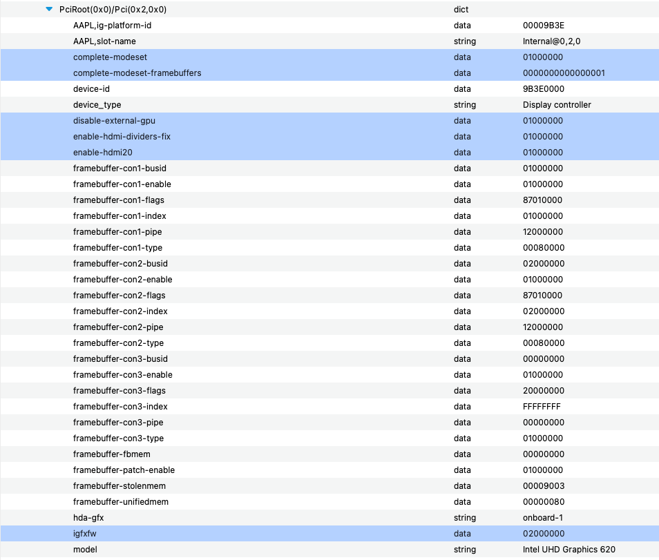

deeveedee Posted December 17, 2025 Share Posted December 17, 2025 (edited) @fermento I didn't notice before that you have MaxKernel set to 24.99.99 for WhateverGreen in your config.plist. This prevents WhateverGreen.kext from loading in Tahoe. Remove MaxKernel (leave blank) in your config.plist and reboot. Do your displays both work now? If not... @fermento Based on what you provided, your Motherboard DP is connected to Display DP (via DP -> DP cable) and your Motherboard HDMI is connected to Display DVI (via HDMI -> DVI adapter). Is this correct? Since your motherboard BIOS allows you to configure DVMT, you shouldn't be specifying fbmem and stolenmem in config.plist DeviceProperties. However, you may need to configure DVMT more than 64MB (e.g., 96MB) (The need to increase DVMT was reported by another user when upgrading to Tahoe). You will need to experiment with this starting with 64MB. After you configure DVMT in BIOS, remove the following properties from your DeviceProperties: framebuffer-fbmem framebuffer-stolenmem framebuffer-unifiedmem After setting DVMT in BIOS and removing fbmem, stolenmem and unifiedmem from DeviceProperties, reboot. If you get a kernel panic or blackscreen, increase DVMT in BIOS to next incremental value and try again until you can boot with your revised DeviceProperties. Are both displays working now? If not... There are multiple ways to determine which displays are connected to which logical frame buffer connectors con0, con1, con2.... I typically use Hackintool. Download Hackintool if you don't already have it. Modify your config.plist so that you are not swapping the con1 and con2 indices/pipes as I have done in the attached config.plist. Change the con2 type to HDMI as I have done in the attached config.plist. Boot with the modified DeviceProperties (you should just be able to use my attached config.plist if you want to). Are both displays working now? If not... Open Hackintool and navigate to Patch > Connectors. The connectors con0, con1, con2... will be listed in order starting with con0. From the listing, can you tell which logical connectors (con0, con1, con2) are connected to displays? if not, can you boot with a previous "working" version of macOS and use Hackintool to determine which connectors are connected to displays? If not, post a screenshot of your Hackintool connectors window. EDIT: These are my notes for continued debugging. Ignore these for now: Increase DVMT pre-alloc (see here) Boot Sequoia with revised config.plist busid = 1? Confirm Active HDMI->DVI adapter OC/Kexts (versions) Add igfxfw=2 framebuffer-unifiedmem lspcon (unlikely) config.plist Edited December 17, 2025 by deeveedee 3 Quote Link to comment https://www.insanelymac.com/forum/topic/362084-tahoe-intel-udh-630-dual-monitor-problems/#findComment-2845105 Share on other sites More sharing options...
deeveedee Posted December 17, 2025 Share Posted December 17, 2025 @fermento I didn't notice before that you have MaxKernel set to 24.99.99 for WhateverGreen in your config.plist. This prevents WhateverGreen.kext from loading in Tahoe. I have modified my previous post to address this first before we continue. 3 Quote Link to comment https://www.insanelymac.com/forum/topic/362084-tahoe-intel-udh-630-dual-monitor-problems/#findComment-2845107 Share on other sites More sharing options...
