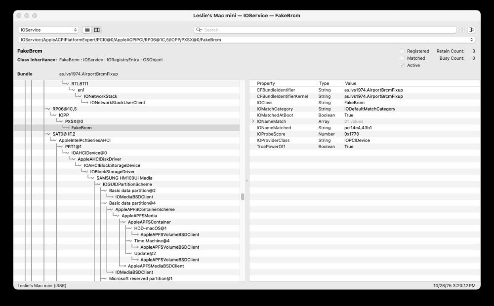

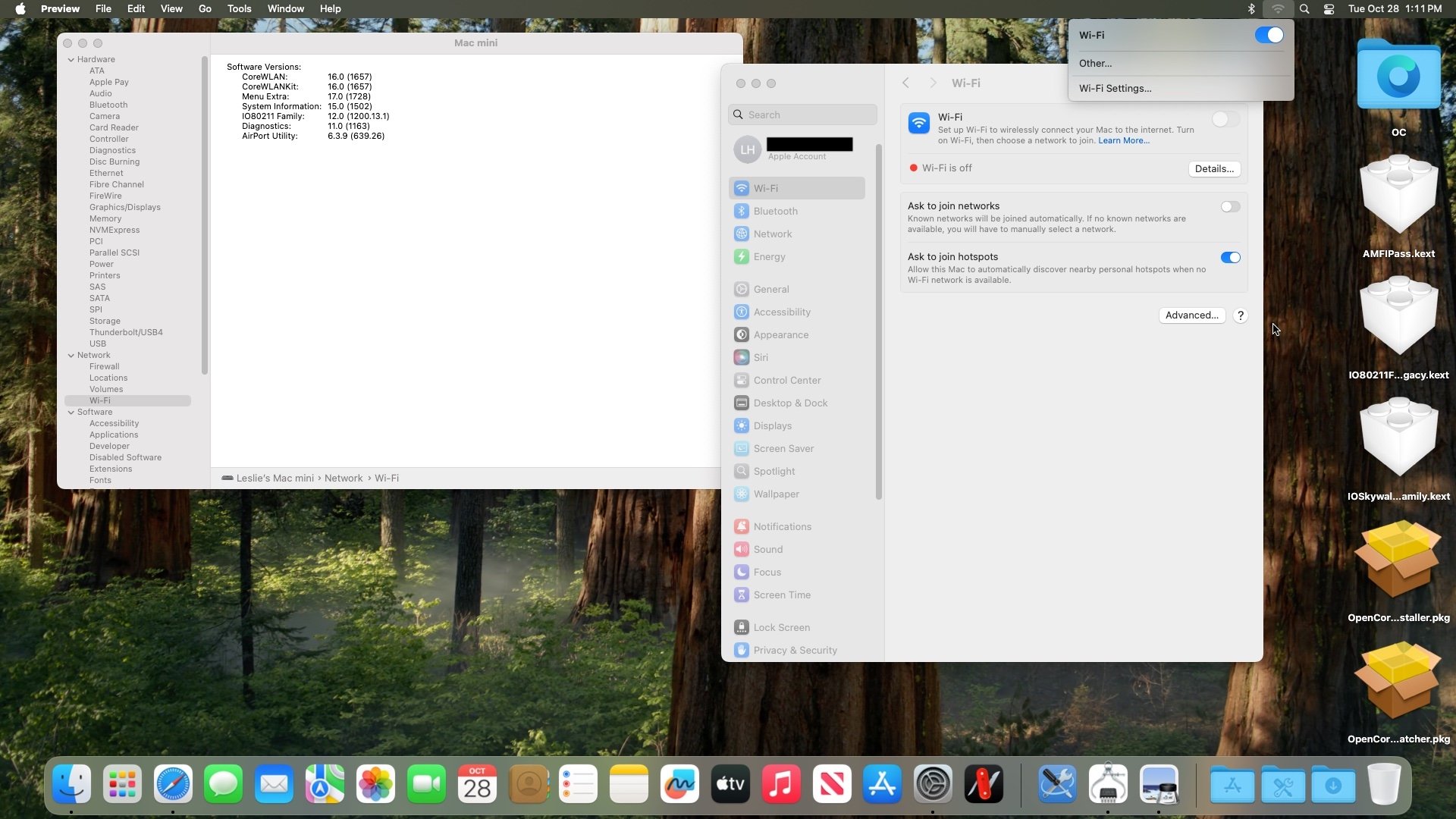

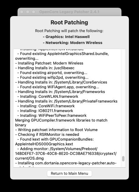

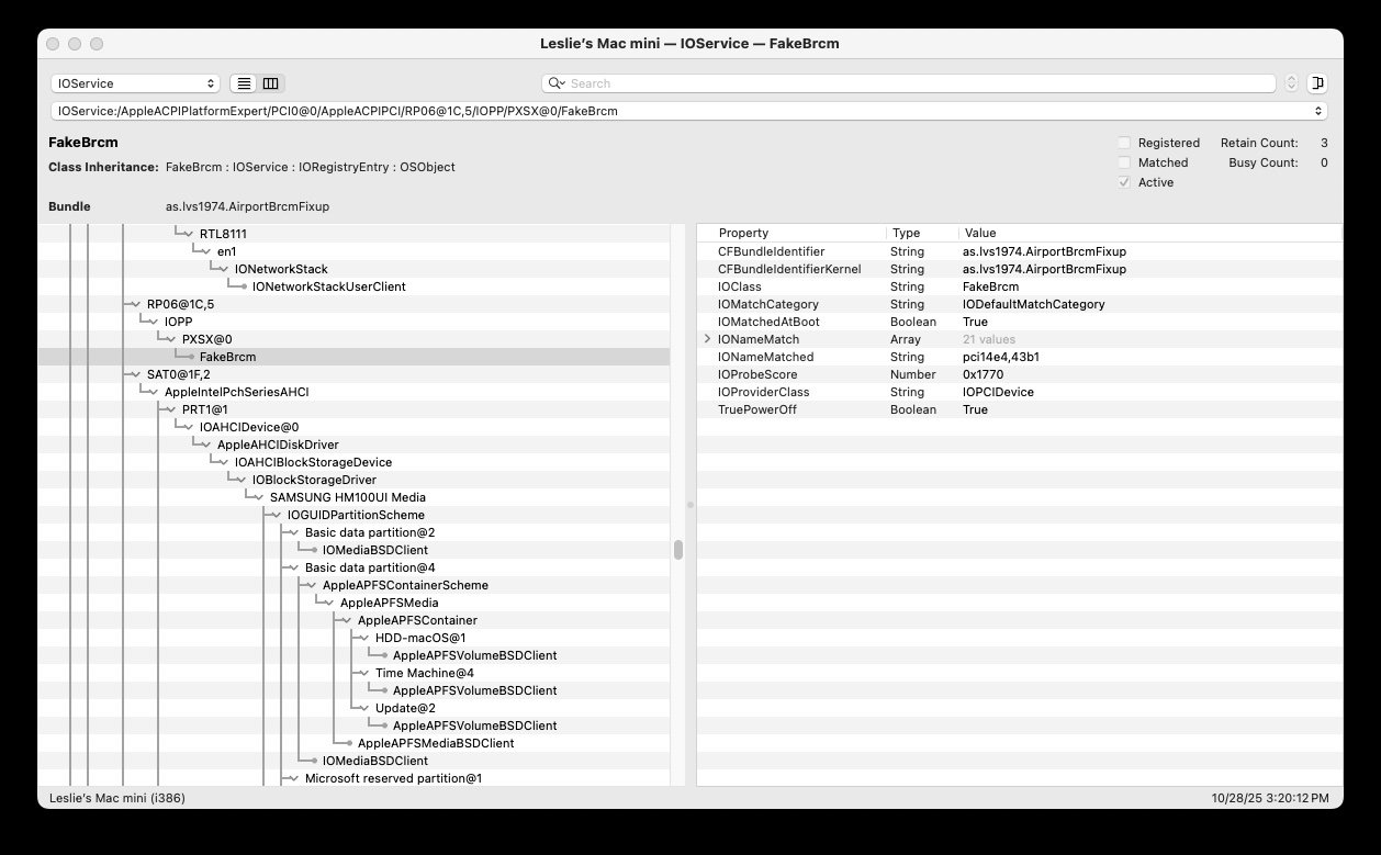

mnfesq Posted October 28, 2025 Share Posted October 28, 2025 I installed Sequoia 15.7.1 on a Zotac ID92 (Haswell) and everything is working except WiFi. It's a Broadcom 4352 WiFi/BT chip and it works in Windows and in macOS Ventura and earlier. I haven't tried it in Sonoma. I have added the IOSkywalkFamily.kext (blocked the Apple version) added the IO89211FamilyLegacy.kext and AMFIPass.kext and have them loaded in the correct order. I have followed the tutorials to the letter and have no typos. I applied the OCLP patch for Haswell graphics and Modern Wireless and both proceeded without any errors. I reset NVAM and rebooted but upon reboot, the WiFi is turned off in system preferences and cannot be turned on. Here are some photos to show what's going on. In IORegExplorer, the WiFi device does not appear but a device called FakeBrcm does where the WiFi device should be. I know that FakeBrcm is a part of the AirPortBrcmFixup.kext. But the WiFi driver does not load. Any ideas? Spoiler Link to comment https://www.insanelymac.com/forum/topic/361889-cant-turn-on-broadcom-4352-wifi-in-sequoia-1571/ Share on other sites More sharing options...

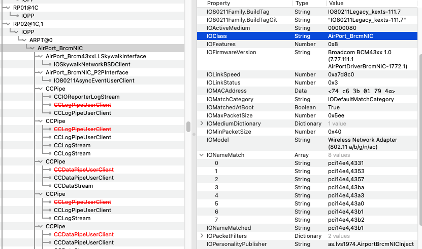

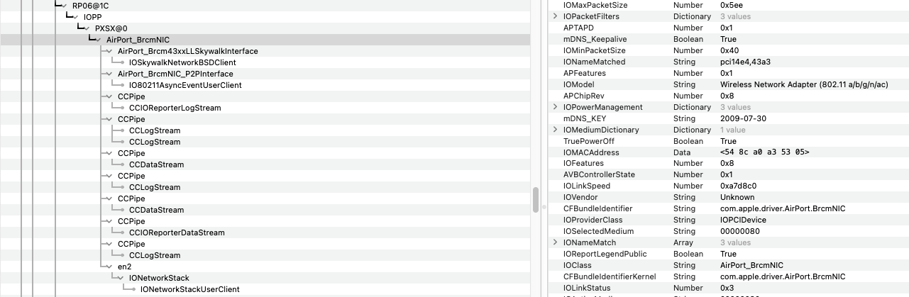

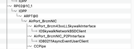

deeveedee Posted October 31, 2025 Share Posted October 31, 2025 (edited) @mnfesq I just took a close look at the screenshot you posted in Post #1. I've never seen Wi-Fi named "FakeBrcm" in IORegistry. Where did you get the Broadcom Wi-Fi kexts you're using? If you didn't get them directly from Acidanthera, replace your kexts with those directly from Acidanthera to eliminate the possibility of bad kexts. My I registry shows this: EDIT: By the way, it's my fault for not noticing the "FakeBrcm." You explained it clearly, I just didn't read. Edited October 31, 2025 by deeveedee Link to comment https://www.insanelymac.com/forum/topic/361889-cant-turn-on-broadcom-4352-wifi-in-sequoia-1571/#findComment-2842970 Share on other sites More sharing options...

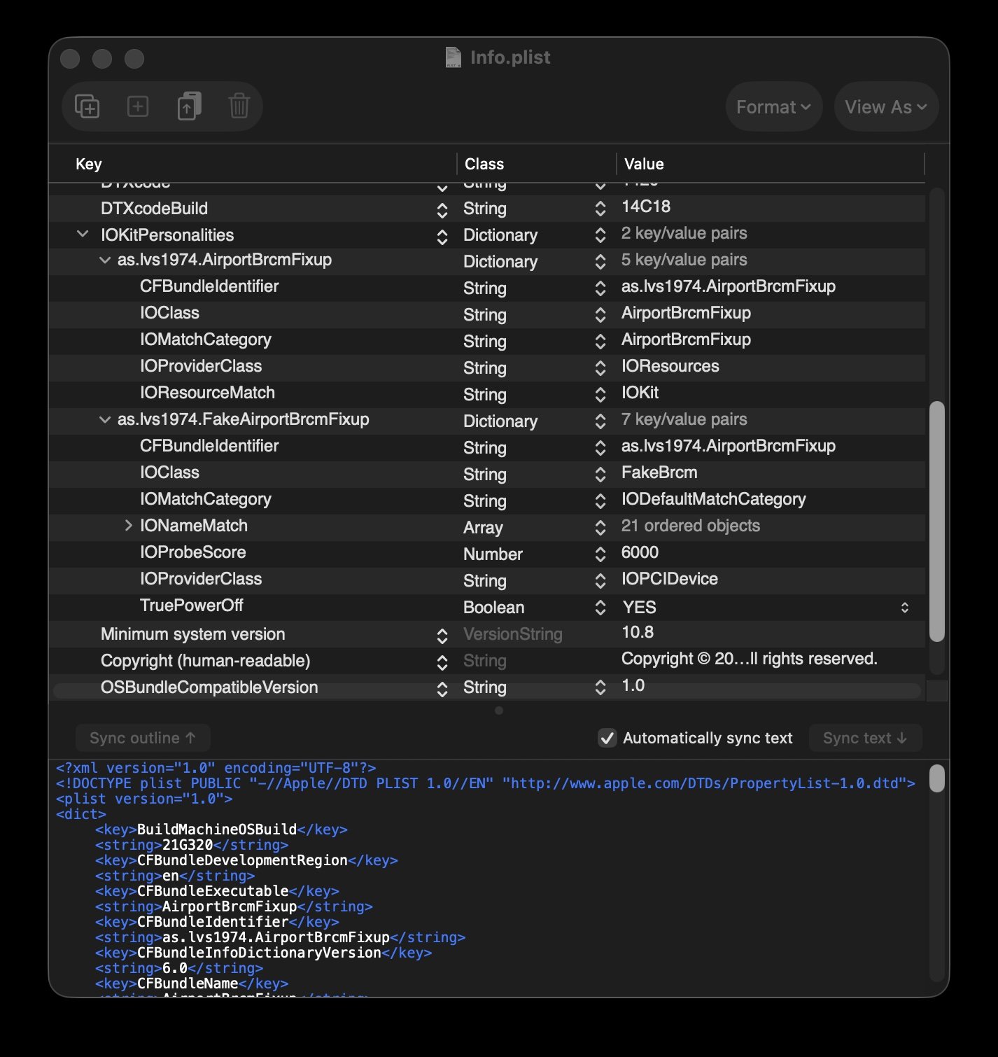

mnfesq Posted October 31, 2025 Author Share Posted October 31, 2025 Surprise, surprise, FakeBrcm is a part of the AirportBrcmFixup.kext. I'm not sure what its function is. See the screenshot below. For what it's worth, I tried installing another Broadcom WiFi/BT chip and an Intel WiFi/BT chip and they both had the same problem. I would think it was a hardware problem if it weren't for the fact that WiFi works in a Windows installation I have on the same computer. This is a real head-scratcher and I have spent the better part of 4 days trying to figure this out and come up with solutions for it. Link to comment https://www.insanelymac.com/forum/topic/361889-cant-turn-on-broadcom-4352-wifi-in-sequoia-1571/#findComment-2842973 Share on other sites More sharing options...

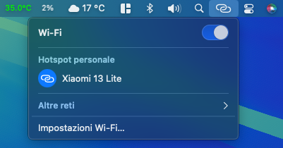

Anto65 Posted October 31, 2025 Share Posted October 31, 2025 (edited) This seems to work here , BMC4350 DW1820 I'm not using AirportBrcmFixup.kext or even AirPortBrcmNIC_Injector.kext Spoiler Edited October 31, 2025 by Anto65 Link to comment https://www.insanelymac.com/forum/topic/361889-cant-turn-on-broadcom-4352-wifi-in-sequoia-1571/#findComment-2842985 Share on other sites More sharing options...

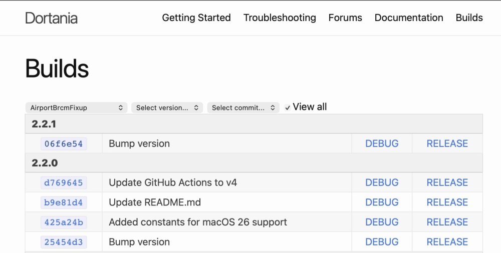

deeveedee Posted October 31, 2025 Share Posted October 31, 2025 (edited) 9 hours ago, mnfesq said: Surprise, surprise, FakeBrcm is a part of the AirportBrcmFixup.kext. I'm not sure what its function is. See the screenshot below. It's not a surprise - it's in the Info.plist. As I said, I've never seen FakeBrcm show up in IORegistry. I have the same 14e4,43b1 device. If you're certain of your kexts, I'm out of ideas. Spoiler EDIT: @mnfesq According to this, the "FakeBrcm" fix was implemented in a newer version of AirportBrcmFixup.kext. Again, I would recommend that you confirm that you're using the latest AirportBrcmFixup.kext from here. If you want more help, please post your entire EFI (with kexts). Also post your IORegistry explorer dump. Edited October 31, 2025 by deeveedee Link to comment https://www.insanelymac.com/forum/topic/361889-cant-turn-on-broadcom-4352-wifi-in-sequoia-1571/#findComment-2842988 Share on other sites More sharing options...

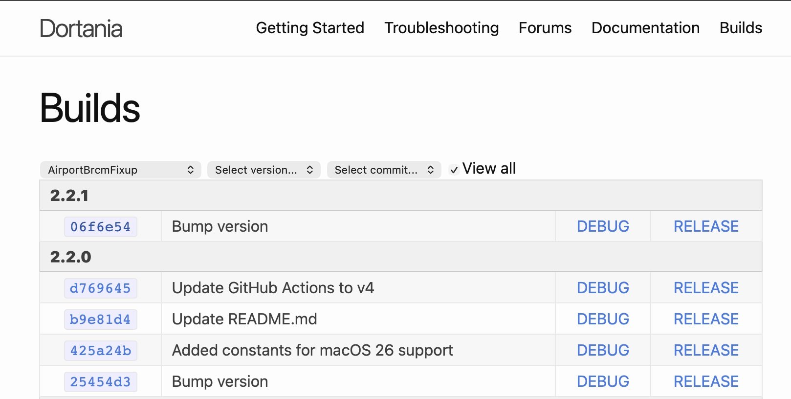

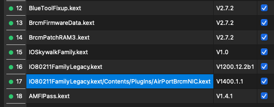

mnfesq Posted October 31, 2025 Author Share Posted October 31, 2025 I have been using AirPortBrcmFixup.kext version 2.2.1. See here: I am going to take a break from this so that I might once again be able to see the forest through the trees. But when I return to it, I am thinking that maybe the SSDT-EC-Desktop.aml might be causing this and that I could try the SSDT-EC-Laptop.aml instead. When I had WiFi working, I was using a DSDT.aml that was edited by MaLd0n. Now, the EFI I used to use with that DSDT no longer boots. Link to comment https://www.insanelymac.com/forum/topic/361889-cant-turn-on-broadcom-4352-wifi-in-sequoia-1571/#findComment-2843007 Share on other sites More sharing options...
deeveedee Posted October 31, 2025 Share Posted October 31, 2025 (edited) @mnfesq I don't use version 2.2.1, since it's not yet officially released and the only change (at the time of this post) is a version bump. If you are still stuck after you see the forest through the trees, revert to version 2.2.0 and test. If that doesn't work, post your full EFI and IORegistry dump for inspection. Edited October 31, 2025 by deeveedee 1 Link to comment https://www.insanelymac.com/forum/topic/361889-cant-turn-on-broadcom-4352-wifi-in-sequoia-1571/#findComment-2843010 Share on other sites More sharing options...
