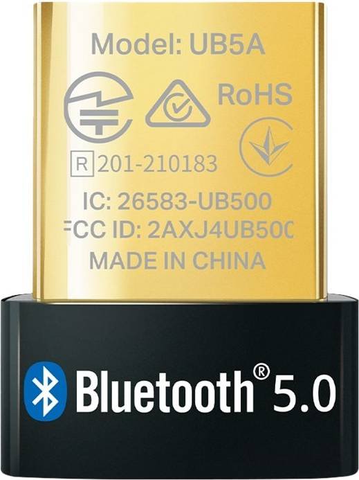

Ginger Geek Posted October 15, 2025 Share Posted October 15, 2025 (edited) It knows it is there but it does not want to play! The. firmware is not initialized the classification is wrong and it is given no address. Bluetooth Controller: Address: NULL State: Off Chipset: BCM_4350C2 Discoverable: Off Firmware Version: v0 c0 Supported services: 0x392039 < HFP AVRCP A2DP HID Braille LEA AACP GATT SerialPort > Transport: UART Vendor ID: 0x004C (Apple) TP-Link Bluetooth USB Adapter: Location ID: 0x14810000 Connection Type: Removable Serial Number: BC071D4805AD Link Speed: 12 Mb/s USB Vendor ID: 0x2357 USB Product ID: 0x0604 USB Product Version: 0x0200 Edited October 15, 2025 by Ginger Geek 2 Link to comment https://www.insanelymac.com/forum/topic/361845-any-way-to-make-this-usb-dongle-work-tahoe-26/ Share on other sites More sharing options...
Slice Posted October 18, 2025 Share Posted October 18, 2025 It is too new to be compatible with macOS. 1 Link to comment https://www.insanelymac.com/forum/topic/361845-any-way-to-make-this-usb-dongle-work-tahoe-26/#findComment-2842478 Share on other sites More sharing options...
Max.1974 Posted October 18, 2025 Share Posted October 18, 2025 On 10/15/2025 at 9:01 AM, Ginger Geek said: It knows it is there but it does not want to play! The. firmware is not initialized the classification is wrong and it is given no address. Bluetooth Controller: Address: NULL State: Off Chipset: BCM_4350C2 Discoverable: Off Firmware Version: v0 c0 Supported services: 0x392039 < HFP AVRCP A2DP HID Braille LEA AACP GATT SerialPort > Transport: UART Vendor ID: 0x004C (Apple) TP-Link Bluetooth USB Adapter: Location ID: 0x14810000 Connection Type: Removable Serial Number: BC071D4805AD Link Speed: 12 Mb/s USB Vendor ID: 0x2357 USB Product ID: 0x0604 USB Product Version: 0x0200 Are you try this? sudo nvram bluetoothInternalControllerInfo=0 && sudo nvram bluetoothExternalDongleFailed=0 && sudo nvram bluetoothHostControllerSwitchBehavior=always Check for exemple this video: https://youtu.be/fpz6uekZFlM 1 Link to comment https://www.insanelymac.com/forum/topic/361845-any-way-to-make-this-usb-dongle-work-tahoe-26/#findComment-2842479 Share on other sites More sharing options...
