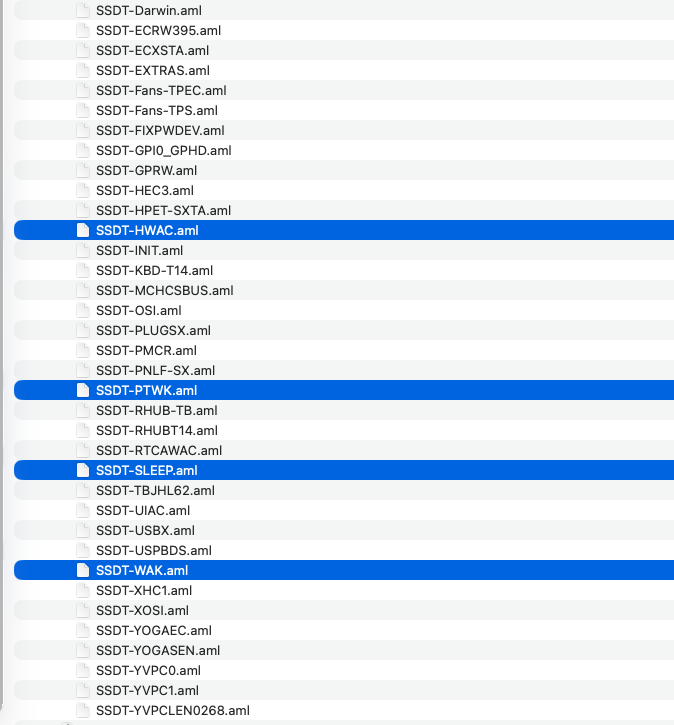

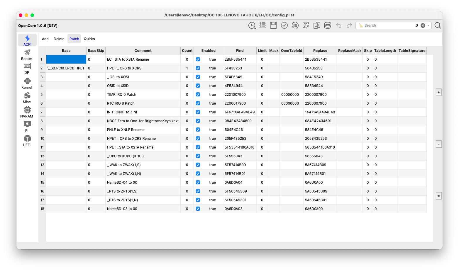

Max.1974 Posted September 16, 2025 Share Posted September 16, 2025 7 hours ago, Tech5G5G said: My ports are already mapped with USB Toolbox. Hello dear friend, welcome! There are so many factors that can cause this, especially the lack of a hot patch created by Rehabman for laptops. But nowadays, depending on the hardware and the macOS you intend to install, only by testing all the required patches step by step may this solve the problem. There are Bluetooth patches, patches for various SSDs, battery patches, Opencore and Clover (Kernel) patches, power nap settings, etc. I have two laptops that took me about five months each to get everything set up the way I wanted. So I suggest checking out this advanced tutorial, among others, and if you need it, I'll leave my EFI as a reference. https://github.com/jsassu20/OpenCore-HotPatching-Guide For exemple, in boot args I have been used this: rtcfx_exclude=80-AB ACPI Patch I use this: And many others can be necessary And this SSDTS is necessary too for fix Shutdown and Restart PTWK is Prepare to Wake 1 1 Quote Link to comment https://www.insanelymac.com/forum/topic/361677-sleep-turns-into-shutdown/#findComment-2840703 Share on other sites More sharing options...
