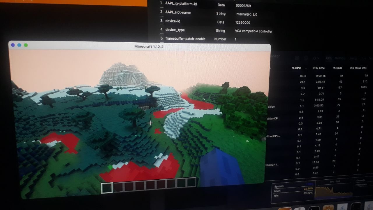

I have partically video accel in os (smoother mouse movements), but windows collapsing are laggy.
In game fps normal and no lags.
And i have colors bug, like a sepia:
This effect with this parameters:
  • AAPL,ig-platform-id : 00001259
  • device-id : 12590000
Without device-id save result.
Used SMBIOS - iMac18,2 and iMac18,3
Yes, i tried iMac18,1, with it no video input.
OS seeing Monitor EDID and showing it info correctly.

Its not working for me, black screen.
On this forum found:
  • SMBIOS: iMac18,1
  • AAPL,ig-platform-id: 00001259
  • Boot args: igfxagdc=0
The system works, but the behavior is strange.
For example, in Figma, Hearthstone, or Minecraft I see very high CPU usage while GPU usage stays low.
Surprisingly, on my old laptop with an i5-3337U and HD 4000 (with OCLP on Monterey), the same applications actually run with better performance.
Edited by Alex Fans
