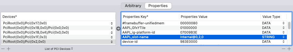

Anto65 Posted June 23, 2025 Share Posted June 23, 2025 1 hour ago, ichelash said: Let me call out @Anto65 @deeveedee or anyone who might see this post maybe they can see what i'm not seeing. I have a question...just install tahoe on my skylake..but it randomly freeze and you have to restart it...also this is not Tahoe issue..even in ventura it behaves the same...what's the issue here folks? The user you called may be absent or unavailable You will be contacted as soon as possible 😆 Spoiler @ichelash but did you install with my Clover EFI ? 1 1 Link to comment https://www.insanelymac.com/forum/topic/361162-pre-release-macos-tahoe/page/48/#findComment-2834535 Share on other sites More sharing options...
ichelash Posted June 23, 2025 Share Posted June 23, 2025 4 minutes ago, Anto65 said: The user you called may be absent or unavailable You will be contacted as soon as possible 😆 Hide contents @ichelash but did you install with my Clover EFI ? I did use you EFI..i only changed the platform id and Fbs 1 Link to comment https://www.insanelymac.com/forum/topic/361162-pre-release-macos-tahoe/page/48/#findComment-2834536 Share on other sites More sharing options...
strangeron Posted June 23, 2025 Share Posted June 23, 2025 (edited) 8 minutes ago, ichelash said: Do you think it's a graphics issues? I think there is a small possibility that the graphics card is causing the system to freeze. A faulty patch will not open the system or there will be no graphics acceleration. It can be opened and checked with -igfxvesa. Edited June 23, 2025 by strangeron Link to comment https://www.insanelymac.com/forum/topic/361162-pre-release-macos-tahoe/page/48/#findComment-2834537 Share on other sites More sharing options...
Anto65 Posted June 23, 2025 Share Posted June 23, 2025 (edited) Now I'm not Slice, but try enabling Apple RTC Spoiler Try using the FB here recommended by carlo_67 ... the EFI is always the same 😂 https://www.insanelymac.com/forum/topic/361162-pre-release-macos-tahoe/page/50/#findComment-2834453 Edited June 23, 2025 by Anto65 2 Link to comment https://www.insanelymac.com/forum/topic/361162-pre-release-macos-tahoe/page/48/#findComment-2834538 Share on other sites More sharing options...
ichelash Posted June 23, 2025 Share Posted June 23, 2025 5 minutes ago, strangeron said: I think there is a small possibility that the graphics card is causing the system to freeze. A faulty patch will not open the system or there will be no graphics acceleration. It can be opened and checked with -igfxvesa. For it not to freeze.. i have to disable use graphics acceleration on browsers 1 Link to comment https://www.insanelymac.com/forum/topic/361162-pre-release-macos-tahoe/page/48/#findComment-2834541 Share on other sites More sharing options...
strangeron Posted June 23, 2025 Share Posted June 23, 2025 13 minutes ago, ichelash said: i have to disable use graphics acceleration on browsers All of them or just Chrome? For example, are YouTube videos problematic? Link to comment https://www.insanelymac.com/forum/topic/361162-pre-release-macos-tahoe/page/48/#findComment-2834542 Share on other sites More sharing options...

ichelash Posted June 23, 2025 Share Posted June 23, 2025 14 minutes ago, strangeron said: All of them or just Chrome? For example, are YouTube videos problematic? i can even open settings..and boom freezes...and i have to force shutdown Link to comment https://www.insanelymac.com/forum/topic/361162-pre-release-macos-tahoe/page/48/#findComment-2834546 Share on other sites More sharing options...
ANTIKO Posted June 23, 2025 Share Posted June 23, 2025 7 minutes ago, strangeron said: Frankly, I don't think there will be an update regarding Rx400 and Rx500 series in Beta 2. Just as we said goodbye to Nvidia graphics cards and then AMD HD7000, HD8000, R7 and R9 series, it's time for RX400/500 series. I had an Rx590 Special Edition. It was replaced by RX6600XT with a small farewell ceremony. Still, I hope support comes in Beta 2. Do you think that removing support for AMD Radeon Pro 580X will not leave the Pro 5500 X, Pro 5700 X, Pro Vega II, Pro Vega II Duo, Pro W6800X and Pro W6900X, and Pro W6800X Duo? It's kind of illogical... 1 Link to comment https://www.insanelymac.com/forum/topic/361162-pre-release-macos-tahoe/page/48/#findComment-2834548 Share on other sites More sharing options...
ichelash Posted June 23, 2025 Share Posted June 23, 2025 9 minutes ago, eSaF said: I am no expert on the subject and there are people here far more knowledgeable than I am. If this freezing is happening while using the CPU inbuilt Graphic capability, I would also suspect that is the reason. The possible cause can also be either incomplete or incorrect FB entries for the Graphics in Device Properties. My own experience using Integrated Graphics for Tahoe went from freezing to a black screen. The problem was solved by @Anto65 who suggested to remove the Graphics Slot Entry in Device Properties. I think you should carefully look at your Graphics Entry again. Hope this helps. Good luck. Thanks for the info @eSaF Let me know consider..purchasing a supported AMD graphics card... Link to comment https://www.insanelymac.com/forum/topic/361162-pre-release-macos-tahoe/page/48/#findComment-2834549 Share on other sites More sharing options...
Anto65 Posted June 23, 2025 Share Posted June 23, 2025 I was not born in Silicon Valley either 🙈 @ichelash but if something similar in the properties of the graphics remove it Spoiler as recommended by eSaF 3 Link to comment https://www.insanelymac.com/forum/topic/361162-pre-release-macos-tahoe/page/48/#findComment-2834550 Share on other sites More sharing options...
ichelash Posted June 23, 2025 Share Posted June 23, 2025 2 minutes ago, Anto65 said: I was not born in Silicon Valley either 🙈 @ichelash but if something similar in the properties of the graphics remove it Hide contents as recommended by eSaF No traces of such... 3 Link to comment https://www.insanelymac.com/forum/topic/361162-pre-release-macos-tahoe/page/48/#findComment-2834551 Share on other sites More sharing options...

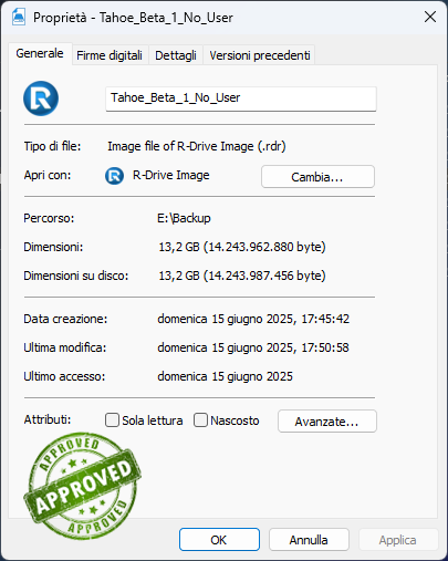

Anto65 Posted June 23, 2025 Share Posted June 23, 2025 (edited) 10 minutes ago, ANTIKO said: By the way, gentlemen, does anyone have a link to Tahoe in DMG format? not PKG? Can I get a RDR image without user To restore on disk, 5min reboot and you only have to create the account Spoiler Edited June 23, 2025 by Anto65 2 1 Link to comment https://www.insanelymac.com/forum/topic/361162-pre-release-macos-tahoe/page/48/#findComment-2834562 Share on other sites More sharing options...
ANTIKO Posted June 23, 2025 Share Posted June 23, 2025 2 minutes ago, Anto65 said: Can I get a RDR image without user To restore on disk, 5min reboot and you only have to create the account I have my own idea, I have to test it myself, so I need a DMG. 4 minutes ago, Anto65 said: Can I get a RDR image without user To restore on disk, 5min reboot and you only have to create the account Hide contents Excuse me, do you need my Email? translation difficulties) Link to comment https://www.insanelymac.com/forum/topic/361162-pre-release-macos-tahoe/page/48/#findComment-2834564 Share on other sites More sharing options...
