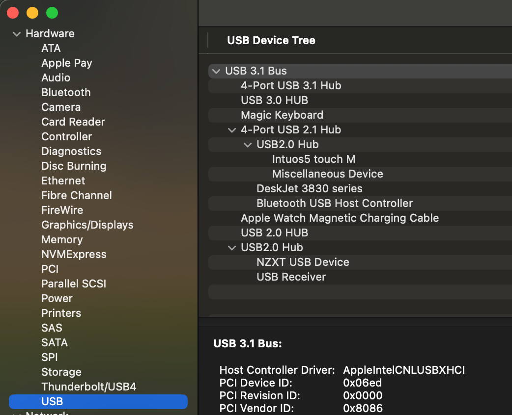

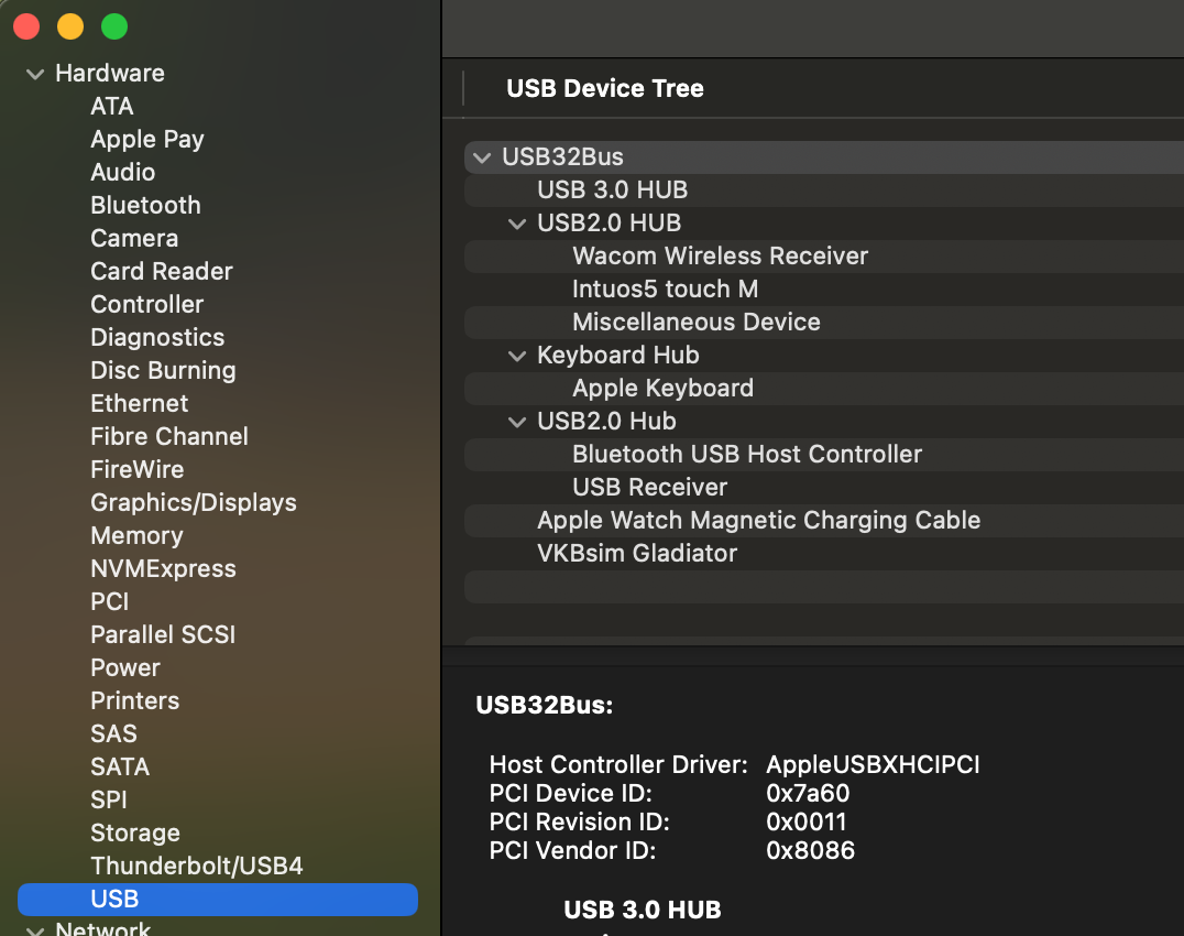

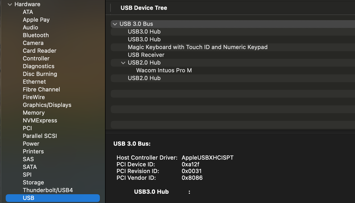

Henties Posted May 5, 2025 Author Share Posted May 5, 2025 42 minutes ago, verdazil said: I also have 4 USB3.2 ports on the board. They work after setting up using USBMap. And without settings for Thunderbolt! So have I on my other hacks, screenshots refer. Note that the root of the USB tree for the GA-Z490-Vision G mobo is USB 3.1 based and that of the GA-Z790 D is 3.2 based whereas for the GA-Z170X Gaming mobo it is USB 3.0 based. I therefore believe that something software/configuration wise needs to be done to get these ports to work on the Skylake hack. I also used USBMap for port discovery on the other hacks, actually being quite familiar with it's workings. A controller for the 2 x USB 3.1 ports is just not discovered on the Skylake hack, with the standard 26 x ports being discovered for controller XHC@14 and as defined within the original and unmodded SSDT-3-xh_rvp10.aml file. None of the 26 discovered ports show that anything gets connected when probing these ports during the mapping exercise, therefore something seems amiss. Greetings Henties Link to comment https://www.insanelymac.com/forum/topic/360980-trying-to-install-sequoia-or-sonoma-on-a-replacement-mobo/#findComment-2832061 Share on other sites More sharing options...
