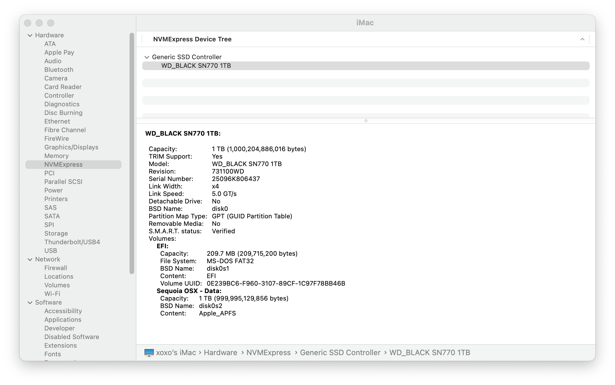

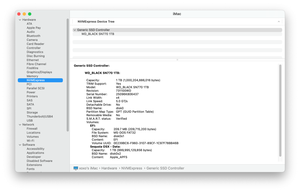

vamose Posted April 28, 2025 Share Posted April 28, 2025 (edited) Been using SATA SSD no issues at all. Recently, mounted NVME SSD via PCIe adapter. System freezes at random. Installation of Sequoia was no issue, but on using system freezes. Attached: Send to apple report upon restart Request if you can also clean my EFI folder. Kext in OC folder: BlueToolFixup.kext IntelBluetoothFirmware.kext (deleted from the shared EFI site 11.5mb) IntelBTPatcher.kext Lilu.kext RealtekRTL8111.kext VirtualSMC.kext WhateverGreen.kext System details: Intel 4 GHz Quad-Core Intel Core i7 Hanswell LGA1150 MOBO: Gigabyte GA-B85M-D3H (rev. 1) PCIe x4 gen 2 - Adapter Sabrent GPU AMD Radeon RX 580 8 GB RAM 32 GB 1333 MHz DDR3 NVME WD SN770 1TB EFI.zip Send to apple report upon restart.rtf Edited May 5, 2025 by vamose Additional items Link to comment https://www.insanelymac.com/forum/topic/360955-nvme-ssd-sequoia-random-freeze-help-required/ Share on other sites More sharing options...

vamose Posted May 1, 2025 Author Share Posted May 1, 2025 (edited) Thanks eSaF for highlighting this. Admin, let me know if you want me to take off the links. Unfortunately no were did I find any reference to compatible NVME cards, hence posted the links. Receieved WD SN770, 1TB, my mackintosh still random freeze. Can any one check my EFI, posted at the start of the thread? After crash rebbot.rtf Edited May 2, 2025 by vamose crash report Link to comment https://www.insanelymac.com/forum/topic/360955-nvme-ssd-sequoia-random-freeze-help-required/#findComment-2831968 Share on other sites More sharing options...
