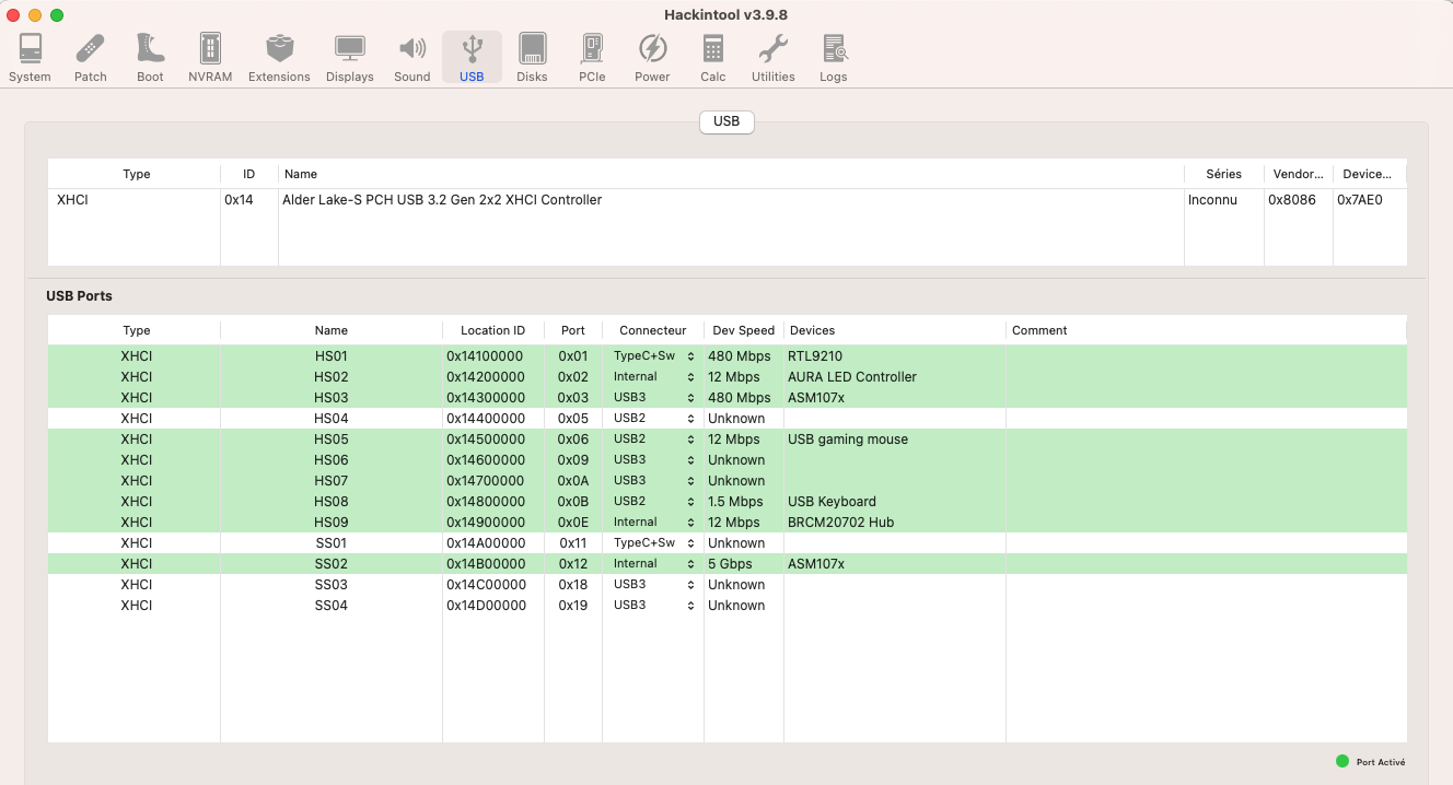

hugo070601 Posted January 26, 2025 Share Posted January 26, 2025 Hello everyone !  As described in the title, my Ventura install contains some broken things 😕 I'm on Ventura 13.5 and my config is  Wireless Bt card: BCM94360NG MB: ASUS ROG STRIX B660-I GAMING WIFI CPU: i9 13900KF GPU:AMD 6800XT  Everything works appart these features, I've done the usb mapping (screenshot) with Usbtoolbox on windows and use USBToolBox.kext, UTBMap.kext on my EFI I'm now lost I don't have ideas of what's wrong  Thanks for your answers Have a nice day :)  Link to comment https://www.insanelymac.com/forum/topic/360578-bcm94360ng-bluetooth-features-doesnt-works-airdrop-only-send-handsoff-and-continuity/ Share on other sites More sharing options...
