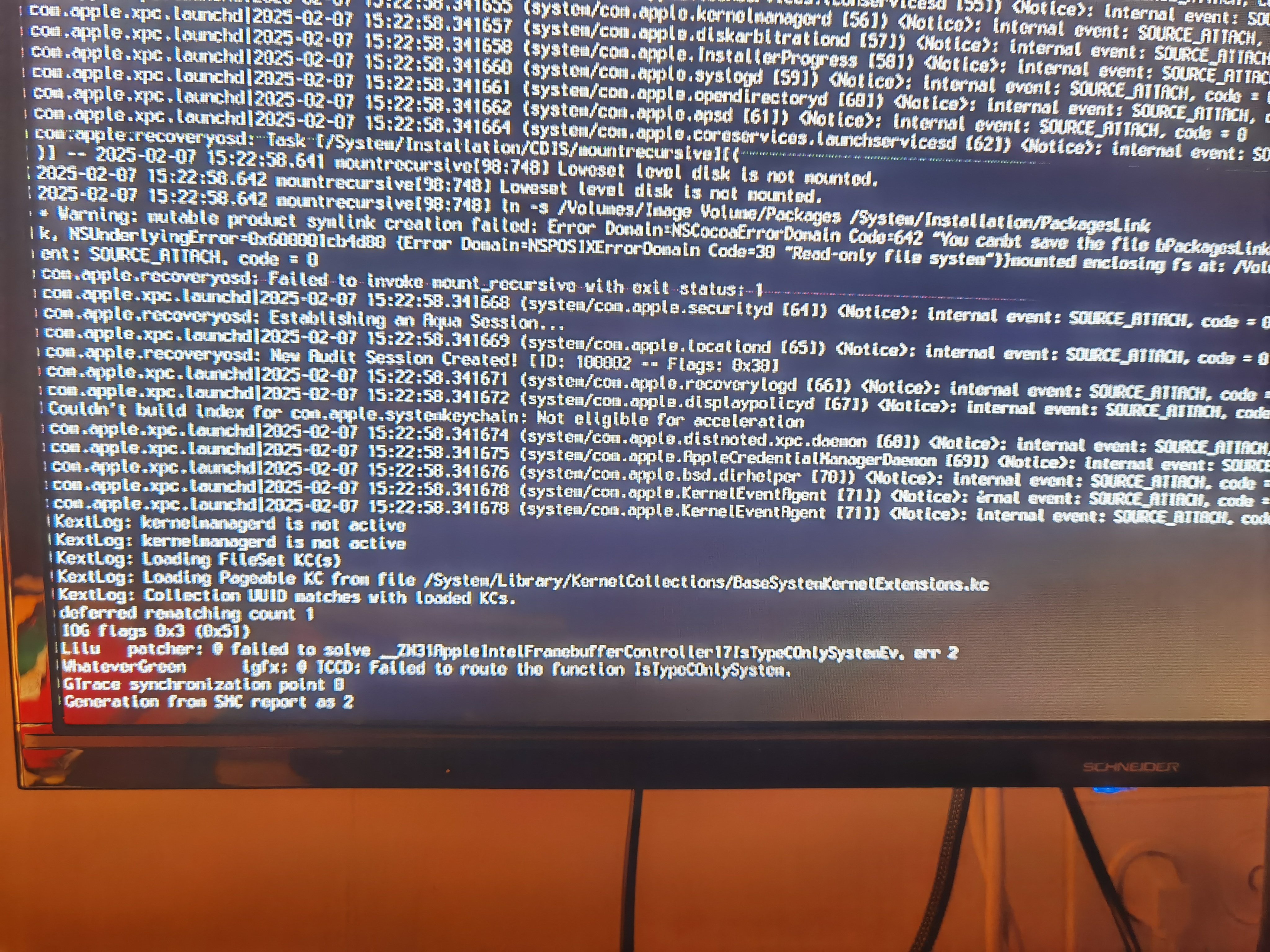

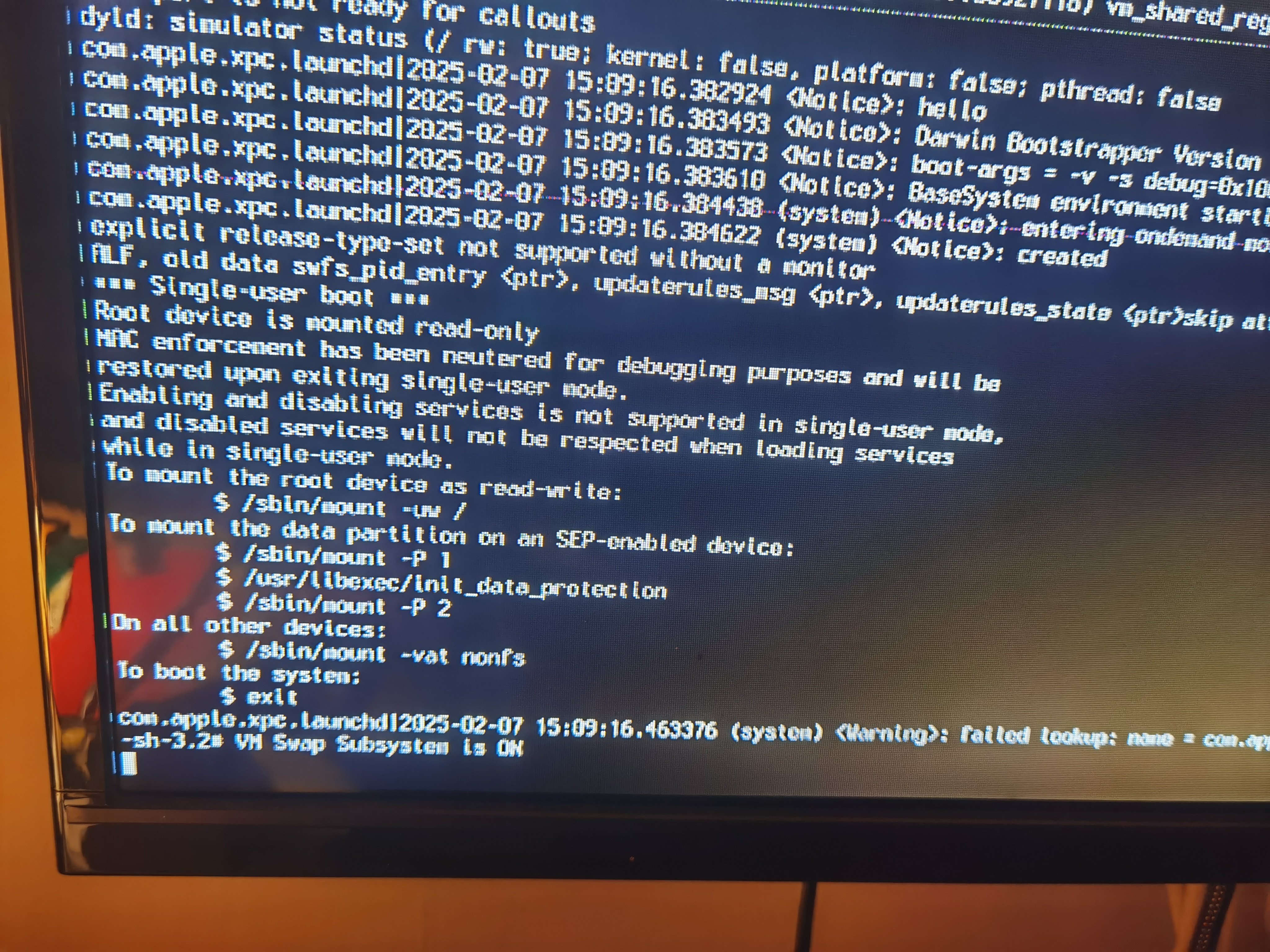

Sk4z Posted Friday at 03:23 PM Author Share Posted Friday at 03:23 PM (edited) Hi, I succeed to build my USB installer because I had access to an iMac the last weekend. So Opencore is booting fine. The apple logo appear but the loading stop at 50%. Do I have the possibility to launch Opencore with somes boot args like we used to with Chameleon and Clover ? In verbose mode maybe ? I can not have access to a genuine Mac as I whish so.. Thank you Edited Friday at 03:23 PM by Skaz Link to comment https://www.insanelymac.com/forum/topic/360544-usb-installer/#findComment-2830240 Share on other sites More sharing options...
Sk4z Posted Friday at 03:35 PM Author Share Posted Friday at 03:35 PM (edited) Yet I used Z270x Gaming k5 and i5 7600 EFI folder. My graphics is set as internal graphics chipset, I waiting an Rx580 which a read that's natively supported. I found information about boot args in Opencore, I will try. Edited Friday at 04:11 PM by Skaz Link to comment https://www.insanelymac.com/forum/topic/360544-usb-installer/#findComment-2830241 Share on other sites More sharing options...
Sk4z Posted Friday at 04:20 PM Author Share Posted Friday at 04:20 PM in verbose mode I read that I'm stuck at Swap subsystem is ON Link to comment https://www.insanelymac.com/forum/topic/360544-usb-installer/#findComment-2830242 Share on other sites More sharing options...
Sk4z Posted Friday at 04:29 PM Author Share Posted Friday at 04:29 PM (edited) I notice that I hit single user boot arg I did it again just in verbose mode and this is where I get stuck. Generate SMC. Edited Friday at 04:33 PM by Skaz Link to comment https://www.insanelymac.com/forum/topic/360544-usb-installer/#findComment-2830244 Share on other sites More sharing options...
Sk4z Posted Friday at 09:26 PM Author Share Posted Friday at 09:26 PM Maybe someone will confirm or not. I think IGFX is the problems. I try again when my Rx580 will be delivered. Link to comment https://www.insanelymac.com/forum/topic/360544-usb-installer/#findComment-2830252 Share on other sites More sharing options...
Sk4z Posted Friday at 10:10 PM Author Share Posted Friday at 10:10 PM (edited) So it was the IGFX I was right. I put back my GT430 and the install is running right now. So thanks anyway to those who help me first and to me finally😅. Maybe this card won't fully working but the time I swap with the Rx580 it helps. I choose APFS for the system and HFS+ for the data, did I do well? Edited Friday at 10:11 PM by Skaz 2 Link to comment https://www.insanelymac.com/forum/topic/360544-usb-installer/#findComment-2830253 Share on other sites More sharing options...
