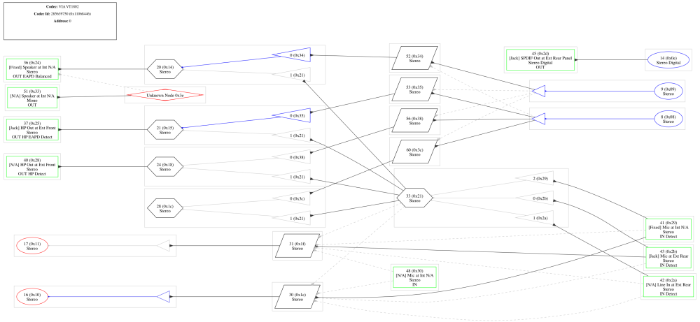

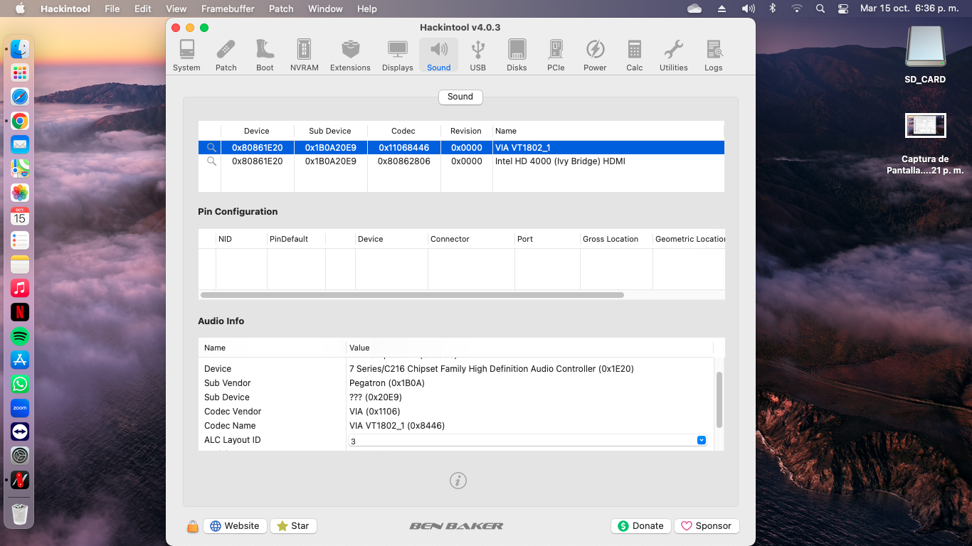

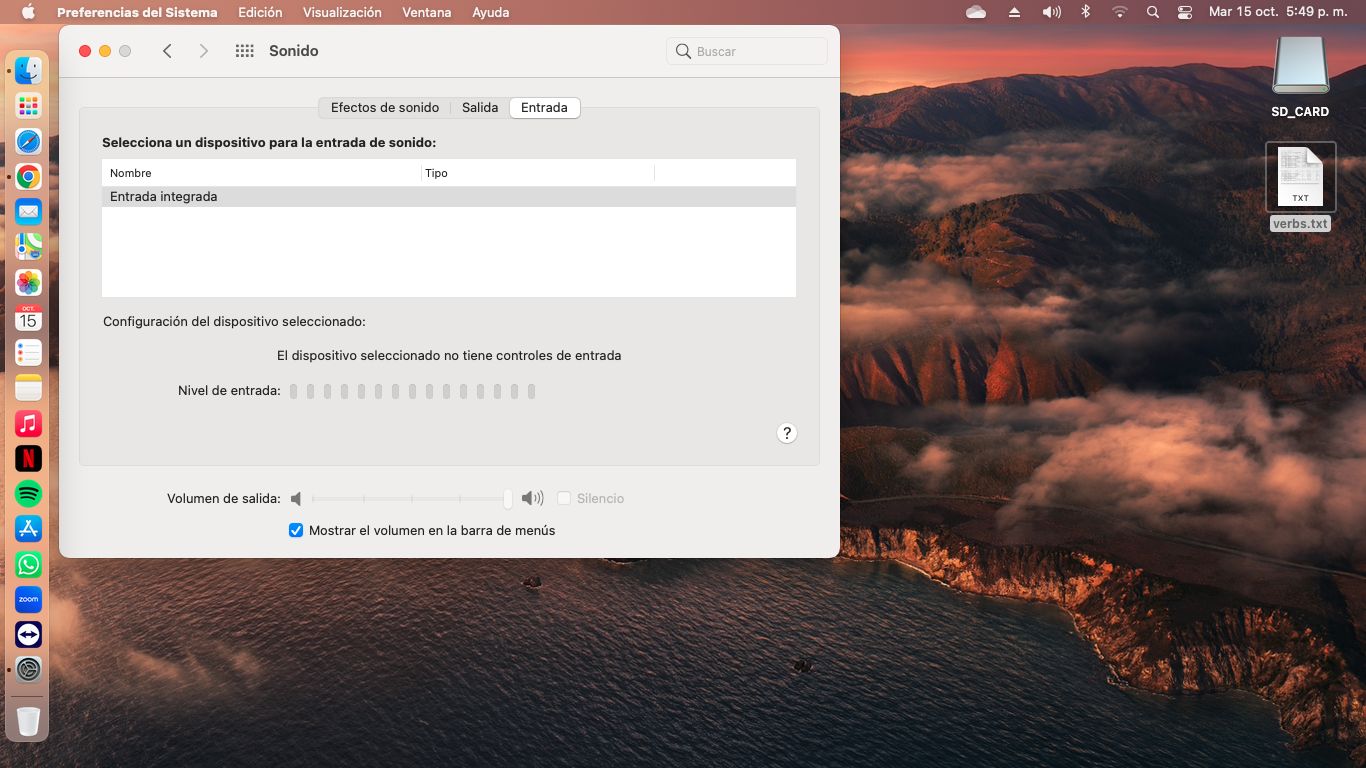

t80u Posted October 15, 2024 Share Posted October 15, 2024 (edited) Hello there! I've been reading this forum for a while and managed to install macOS 11.7 (Big Sur) in a laptop I picked from the trash. It's not from a known brand (in fact, it's made by goverment), but the point is I made macOS able to run nicely on it. After some reading and trying multiple things, kext, etc., I managed to get everything working. My only issue is with the sound codec. I mean, I have sound, the internal speakers are working fine, even the headphone jack and the optical SPDIF output, but microphone is not working (neither internal or external using the input jack). I found a guide on GH that tells how to build the AppleALC kext yourself, but as much as I tried, I think I'll need some help.... I managed to get the codec dump from the Linux Live CD, use the PinConfigurator App to get the verbs and pin config data and even have the visual image of the codec input/outputs, but don't know how to continue... I wanted to write on the AppleALC topic but for some reason, I didn't found the button to post a reply. Here's some information: 1. Laptop model/Motherboard model: VIT P2402 / Pegatron B74 2. Codec name: VIA VT1802 3. Layout used: Layout 3 works better than the others for the codec (33-65) as it have all the outputs, but none input (Int. Microphone / LineIn / Ext. Mic) works. 4. OS X version: 11.7.10 As I said, everything on the Laptop works fine (USB/USB3, WiFi, BT, LAN, Camera, Touchpad, Graphics) and the sound, only issue is with the input (int. microphone / ext. mic). On Windows or Linux, internal mic works fine, also the input jack. I'm attaching files that might help you to help me Thanks!! Edit: Forgot to attach pictures from Hackintool for more device information. Also, HDMI audio works good too. I'm using OC as bootloader, all kext are up to date (Lilu, WhateverGreen and all that stuff) card0-codec#0.txt verbs.txt Edited October 15, 2024 by t80u Add new information. Quote Link to comment https://www.insanelymac.com/forum/topic/360110-new-here-help-with-applealc-codec/ Share on other sites More sharing options...

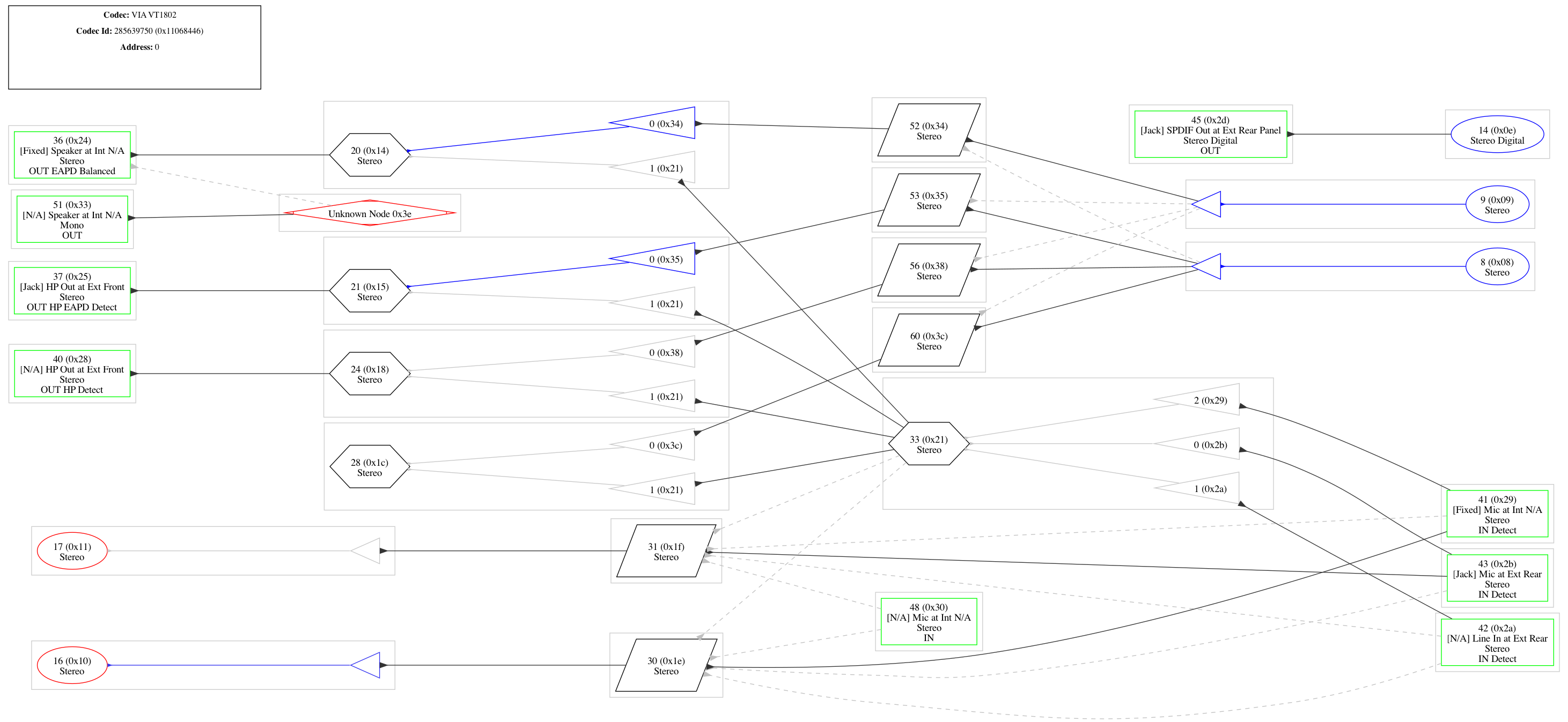

t80u Posted October 17, 2024 Author Share Posted October 17, 2024 1 hour ago, Slice said: AppleALC is for ALCxxx codec i.e. Realtek. Not VIA. Sometime it works for other devices but you are not lucky. I may propose more universal VoodooHDA. Hello! I read somewhere that VoodooHDA was very poor for audio, and I think I tried it as first option, but I'll check again. Thanks! With AppleALC I have good quality sound (it already have support for the VIA VT1802 codec), the only issue is the microphone, but I made some progress on the codec thing, I managed to understand a bit more about the Platform.xml and layout.xml and I think I've edited correctly (the layout-id 3 have the correct NodeID for the outputs, but wrong for the inputs , so I created a new one). Now I'm downloading XCode to build the kext myself and hopefully it compiles so I can test if it works. Quote Link to comment https://www.insanelymac.com/forum/topic/360110-new-here-help-with-applealc-codec/#findComment-2826615 Share on other sites More sharing options...

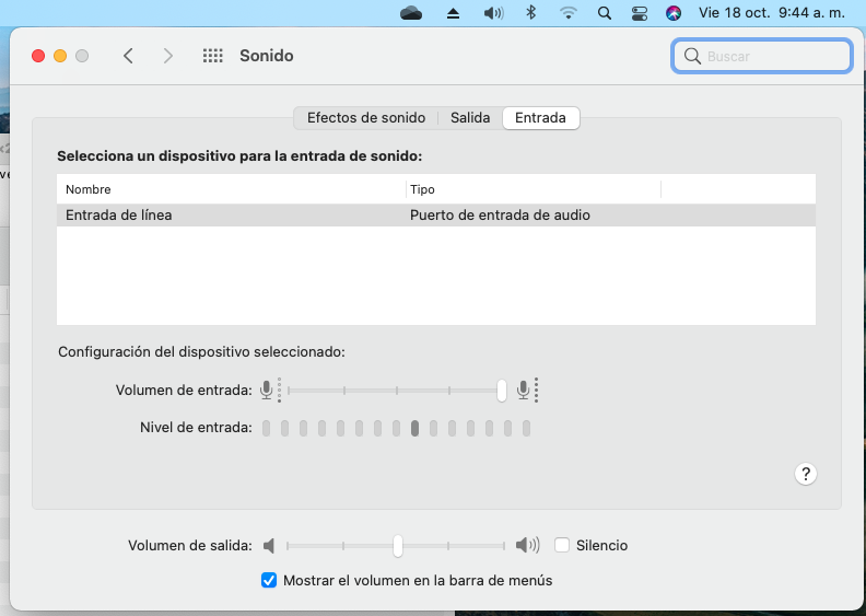

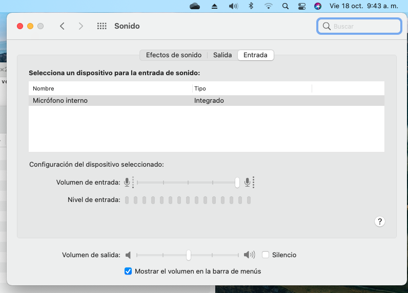

t80u Posted October 18, 2024 Author Share Posted October 18, 2024 20 hours ago, t80u said: Hello! I read somewhere that VoodooHDA was very poor for audio, and I think I tried it as first option, but I'll check again. Thanks! With AppleALC I have good quality sound (it already have support for the VIA VT1802 codec), the only issue is the microphone, but I made some progress on the codec thing, I managed to understand a bit more about the Platform.xml and layout.xml and I think I've edited correctly (the layout-id 3 have the correct NodeID for the outputs, but wrong for the inputs , so I created a new one). Now I'm downloading XCode to build the kext myself and hopefully it compiles so I can test if it works. OK, I tried VoodooHDA again, I remember what happened the first time: the instructions doesn't include how to disable SIP in OpenCore. After disabling and copy the kext to /L/E the only audio device that appears on system is HDMI, no other audio outputs/inputs are recognized. After some trial and error with the AppleALC, I got the internal mic and ext jack working. External jack works perfect, but internal microphone is really low, even when the volume slider is set on max it barely records something you can hear. I think I'll need to keep trying more things to solve that issue, but at least I got it working. Quote Link to comment https://www.insanelymac.com/forum/topic/360110-new-here-help-with-applealc-codec/#findComment-2826633 Share on other sites More sharing options...

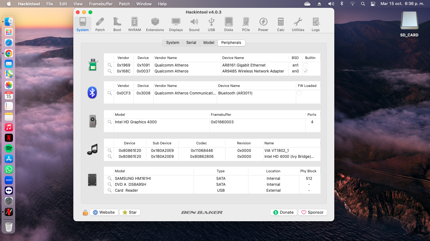

t80u Posted October 21, 2024 Author Share Posted October 21, 2024 (edited) On 10/17/2024 at 12:48 PM, Slice said: I may propose more universal VoodooHDA. I wanted to try more deeper the VoodooHDA kext, but I think the issue is that on my laptop, the sound source come from the same device, as you see on the Hackintool screenshot (0x80861e20). The VIA sound codec and the HDMI audio share the same PCI device, I believe VoodooHDA expects different PCI devices, and that's why is only taking one codec (in this case, the HDMI audio) because that's the only audio output that appears when using this kext. I also tried taking different structures from other layouts on the AppleALC but nothing improves the microphone (you have to almost yell at the very front of the mic), it's like the amplifier is not working or the input volume is being limited even when is set on 100%... But it seems AppleALC development is not very active, on its GitHub only accepts pull request, there's not an "Issues" tab to discuss it further, to see if someone else can show up and give me some hints about this 😅 Edited October 21, 2024 by t80u Quote Link to comment https://www.insanelymac.com/forum/topic/360110-new-here-help-with-applealc-codec/#findComment-2826727 Share on other sites More sharing options...
Slice Posted October 21, 2024 Share Posted October 21, 2024 On 10/17/2024 at 9:04 PM, t80u said: Hello! I read somewhere that VoodooHDA was very poor for audio, Timeless lie. VoodooHDA is not intended for HDMI sound but strange about PCI device. It seems some trick needed. Quote Link to comment https://www.insanelymac.com/forum/topic/360110-new-here-help-with-applealc-codec/#findComment-2826734 Share on other sites More sharing options...
