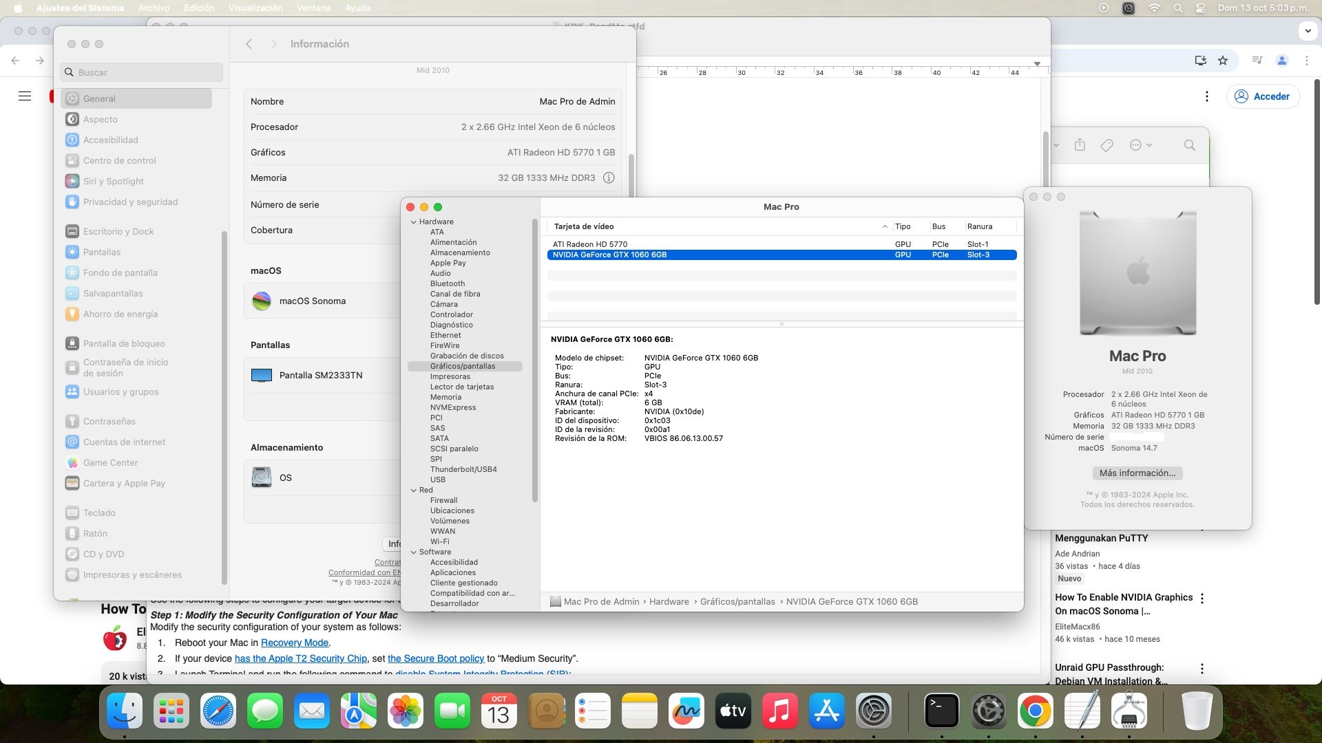

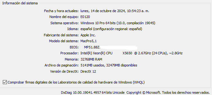

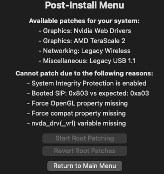

allanar Posted October 14, 2024 Share Posted October 14, 2024 (edited) Hello everyone, I just managed to install MacOS Sonoma on my MacPro 5.1 using OpenCore Legacy Patcher 2.0.2, the problem I have is that it was necessary to first use an AMD Radeon HD 5700 Series compatible for the bootpicker and then I managed to make my GTX 1060 ti 6GB work with the PostInstall and a whole set of modifications that I made to the Kernel to achieve video from the bootscreen (Apple logo) to the login and the system in general. The problem I have is that I can't see the bootpicker using the GTX, and I would like not to depend on the Radeon for this. Also because I have Windows 10 installed on another hard drive and I want to be able to choose which one to start with. Has anyone managed to do it? I understand that my model is based on Pascal technology; also, that it does not support the EFI mode which is indicated to see the bootpicker on a Mac Pro of any type. I've tried Clover, rEFInd, and other bootpickers but they don't offer a GPU emulation solution for NVidia Edited October 14, 2024 by allanar Quote Link to comment https://www.insanelymac.com/forum/topic/360105-nvidia-gtx-1060-ti-running-on-sonoma-147/ Share on other sites More sharing options...
