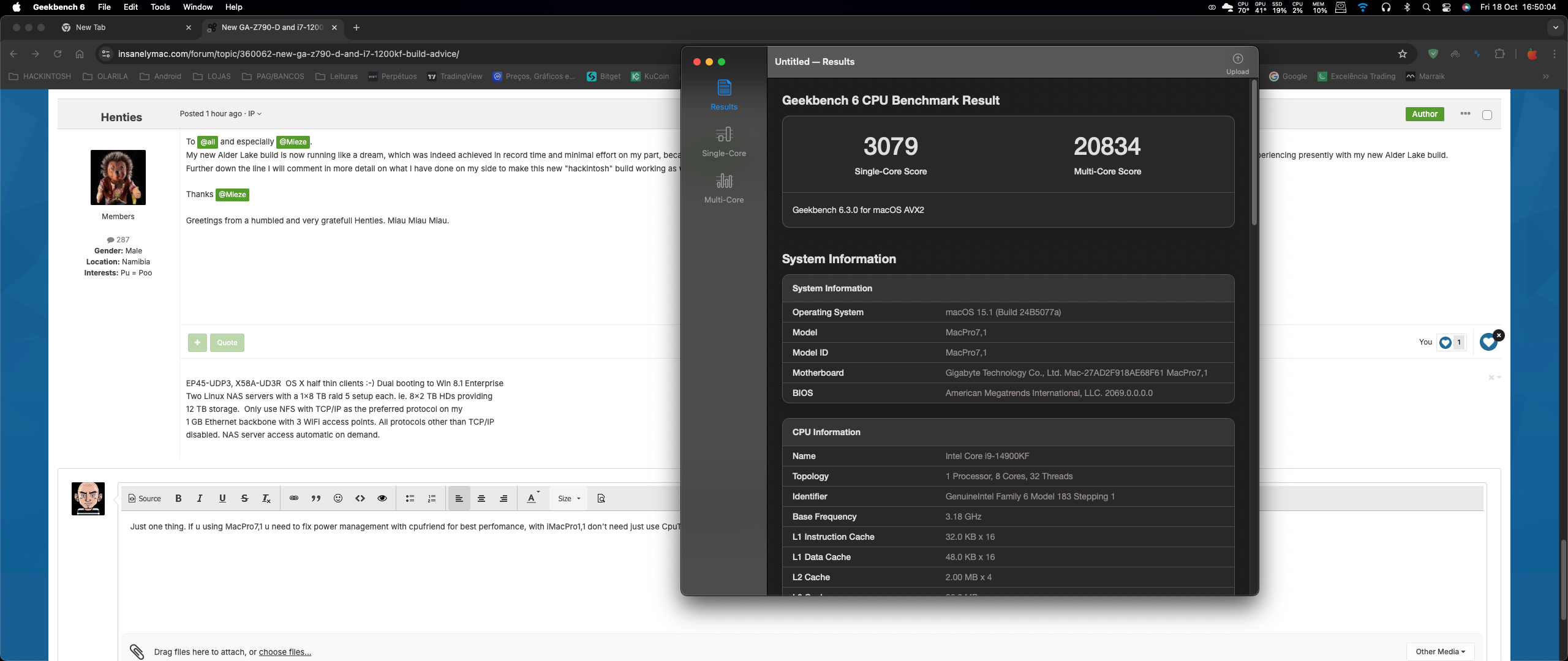

Henties Posted October 18, 2024 Author Share Posted October 18, 2024 To @all and especially @Mieze. My new Alder Lake build is now running like a dream, which was indeed achieved in record time and minimal effort on my part, because @Mieze 's Bios settings as well her sample EFI, which she so generously provided, paved the way for me to accomplish the full functionality I am experiencing presently with my new Alder Lake build. Further down the line I will comment in more detail on what I have done on my side to make this new "hackintosh" buiid working as well as it indeed presently does, especially considering my particular environment. Thanks @Mieze Greetings from a humbled and very gratefull Henties. Miau Miau Miau. 1 Link to comment https://www.insanelymac.com/forum/topic/360062-new-ga-z790-d-and-i7-1200kf-build-advice/#findComment-2826637 Share on other sites More sharing options...
MaLd0n Posted October 18, 2024 Share Posted October 18, 2024 Just one thing. If u using MacPro7,1 u need to fix power management with cpufriend for best perfomance, with iMacPro1,1 don't need just use CpuTopologyRebuild with -ctrsmt(in both cases) 3 1 Link to comment https://www.insanelymac.com/forum/topic/360062-new-ga-z790-d-and-i7-1200kf-build-advice/#findComment-2826639 Share on other sites More sharing options...

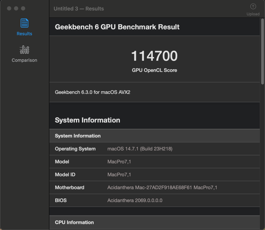

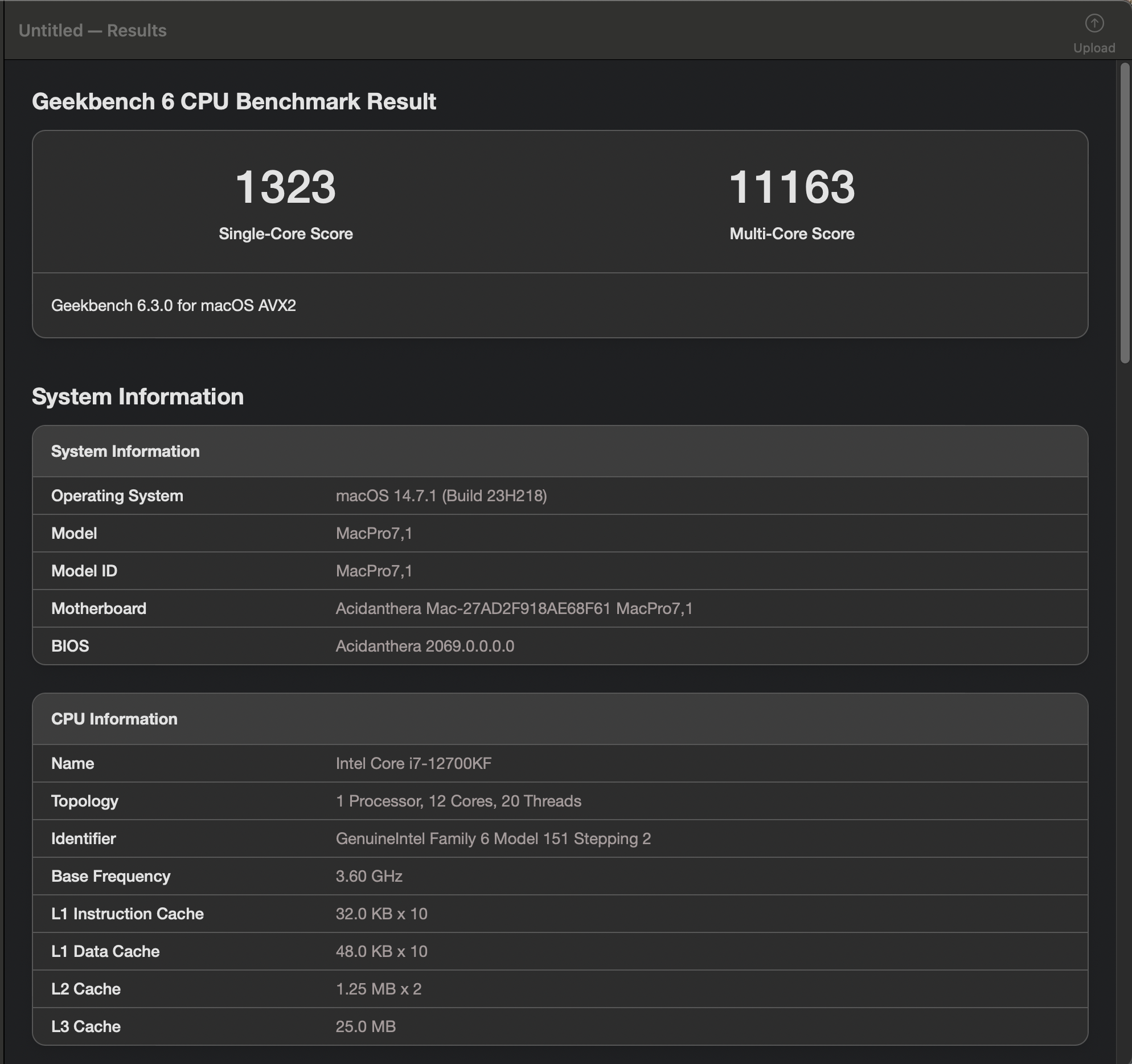

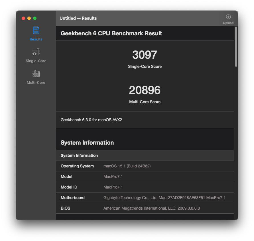

Henties Posted October 19, 2024 Author Share Posted October 19, 2024 (edited) @MaLd0nthank you for your advice. Your Geekbench score reflects performance obtained with a Raptor Lake CPU whereas I have been building my new rig with an Alder Lake CPU. It would be much more beneficial and helpful if one could compare Apples with Apples rather than Apples with Bananas. I deliberately made a last minute decision, just before purchasing, to go for an Alder Lake CPU because of the well documented problems with Intel's Raptor Lake CPU range. I certainly do not regret my buying decision although I am conscious that I sacrificed the performance gains actually optainable had I opted for a Raptor Lake CPU instead. I am quite happy with the new rig of mine, stability wise as well as power wise, without CpuFriend etcetera, as I am now typing my CPU die temp hovers around 23 degrees C with the present ambient temperature being merely 16 degrees C. This new rig is intended to be used for flight simming and I confirm that it lives up to my expectation in that regard as well, with all graphics settings maxed out I consistently obtain 30 fps and above when flying in the most demanding areas there are being Heathrow and greater London or JFK and New York. My adage has always been don't fix something that ain't broken, therefore I will for the time being stay without CPUfriend and it;s "soulmate". Wondering if @Miezewould go along with my comments as well. Oh forgot to mention that the temps reflected by Intel Power Gadgets are a snapshot of the CPU testing phase with the highest CPU utilization imposed by Geekbench. Greetings Henties and thank you for participating in this thread. Edited October 19, 2024 by Henties 3 Link to comment https://www.insanelymac.com/forum/topic/360062-new-ga-z790-d-and-i7-1200kf-build-advice/#findComment-2826647 Share on other sites More sharing options...

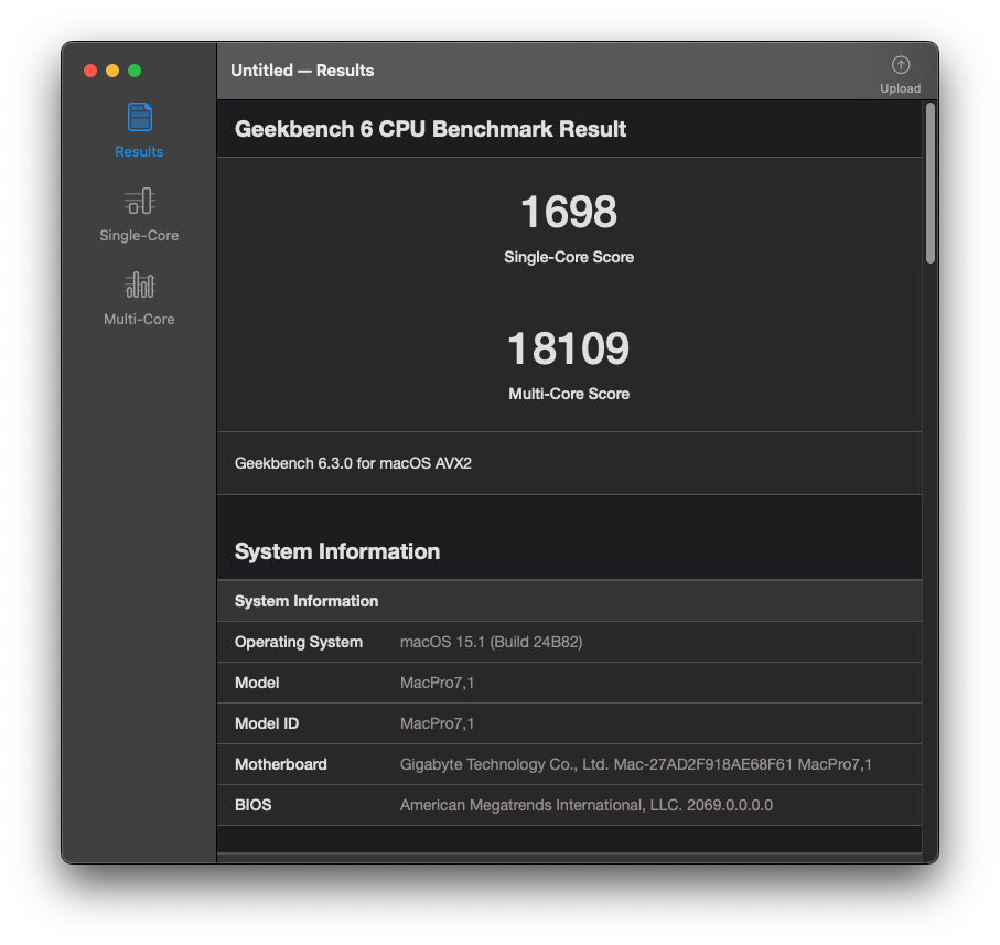

Mieze Posted October 19, 2024 Share Posted October 19, 2024 (edited) @Henties @MaLd0n With Xcode being my main application, I haven't even measured single core performance because multicore performance is what matters for me. CPUFriend with frequency vector generated with the recommended settings didn't improve multicore performance at all but had a devastating impact on I/O performance most likely because of increased interrupt latency. Tx speed with IntelLucy dropped from 9.4 Gbit/s without to 7 Gbit/s with CPUFriend. That's why I removed it completely. What really improved multicore performance was CpuTopologyRebuild without -ctrsmt. My Cinebench R23 score went up from ~18500 to ~22500. Adding -ctrsmt reversed that effect causing it to fall back to ~18500. Without CpuTopologyRebuild Cinebench MC scores were quite unstable. In most cases I got ~18500 with the P-cores maxing out at 3.8 GHz and CPU power consumption was limited to ~125W. In a small number of runs the P-cores reached their maximum turbo frequency with a CPU power consumption of ~180W. After installing CpuTopologyRebuild I'm getting stable results of ~22500 with the CPU making full use of it's power budget of 190W. Edited October 19, 2024 by Mieze 2 1 Link to comment https://www.insanelymac.com/forum/topic/360062-new-ga-z790-d-and-i7-1200kf-build-advice/#findComment-2826669 Share on other sites More sharing options...

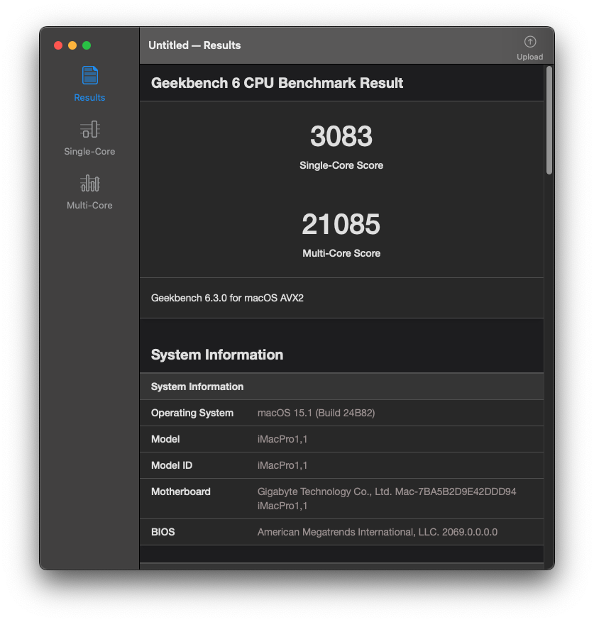

MaLd0n Posted October 19, 2024 Share Posted October 19, 2024 @Mieze, @Henties Just work good with instructions from Vit Here. In some days i made 10 hacks or more in olarila.com and this way for me just work nice in all cases. It's a brutal performance on MacOS. My setup gain 3k+ in some benchs. Geekbench 18k go to 20.8k/21.5k and cinebench 2024 Version go to 2384. 1 Link to comment https://www.insanelymac.com/forum/topic/360062-new-ga-z790-d-and-i7-1200kf-build-advice/#findComment-2826671 Share on other sites More sharing options...
Mieze Posted October 19, 2024 Share Posted October 19, 2024 @MaLd0n Keep in mind that different CPU models have different number of E-Cores which influences the best choice for the CPU topology. With the 12700KF only having 4 E-Cores it isn't possible to create a fully balanced topology. 3 Link to comment https://www.insanelymac.com/forum/topic/360062-new-ga-z790-d-and-i7-1200kf-build-advice/#findComment-2826672 Share on other sites More sharing options...

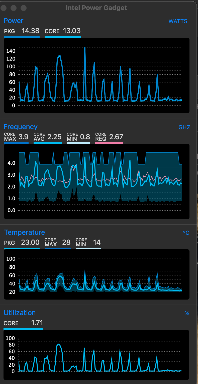

Mieze Posted October 23, 2024 Share Posted October 23, 2024 @MaLd0n I gave CPUFriend.kext another try, this time with a minimum frequency of 2000MHz, which is the default, and should be enough to avoid frequency related I/O performance issues. Tests were run against an Ubuntu server 22.04 LTS equipped with an Intel X520, like the client, and this is the result: laura@Tigresa ~ % iperf3 -w 384K -c 192.168.10.32 Connecting to host 192.168.10.32, port 5201 [ 4] local 192.168.10.95 port 49384 connected to 192.168.10.32 port 5201 [ ID] Interval Transfer Bandwidth [ 4] 0.00-1.00 sec 1.09 GBytes 9.39 Gbits/sec [ 4] 1.00-2.00 sec 1.09 GBytes 9.40 Gbits/sec [ 4] 2.00-3.00 sec 1.09 GBytes 9.39 Gbits/sec [ 4] 3.00-4.00 sec 1.09 GBytes 9.40 Gbits/sec [ 4] 4.00-5.00 sec 1.09 GBytes 9.39 Gbits/sec [ 4] 5.00-6.00 sec 1.09 GBytes 9.33 Gbits/sec [ 4] 6.00-7.00 sec 1.08 GBytes 9.27 Gbits/sec [ 4] 7.00-8.00 sec 1.09 GBytes 9.35 Gbits/sec [ 4] 8.00-9.00 sec 1.09 GBytes 9.40 Gbits/sec [ 4] 9.00-10.00 sec 1.09 GBytes 9.40 Gbits/sec - - - - - - - - - - - - - - - - - - - - - - - - - [ ID] Interval Transfer Bandwidth [ 4] 0.00-10.00 sec 10.9 GBytes 9.37 Gbits/sec sender [ 4] 0.00-10.00 sec 10.9 GBytes 9.37 Gbits/sec receiver iperf Done. laura@Tigresa ~ % iperf3 -w 384K -c 192.168.10.32 -R Connecting to host 192.168.10.32, port 5201 Reverse mode, remote host 192.168.10.32 is sending [ 4] local 192.168.10.95 port 49386 connected to 192.168.10.32 port 5201 [ ID] Interval Transfer Bandwidth [ 4] 0.00-1.00 sec 220 MBytes 1.85 Gbits/sec [ 4] 1.00-2.00 sec 222 MBytes 1.86 Gbits/sec [ 4] 2.00-3.00 sec 219 MBytes 1.84 Gbits/sec [ 4] 3.00-4.00 sec 204 MBytes 1.71 Gbits/sec [ 4] 4.00-5.00 sec 207 MBytes 1.74 Gbits/sec [ 4] 5.00-6.00 sec 217 MBytes 1.82 Gbits/sec [ 4] 6.00-7.00 sec 208 MBytes 1.74 Gbits/sec [ 4] 7.00-8.00 sec 266 MBytes 2.23 Gbits/sec [ 4] 8.00-9.00 sec 277 MBytes 2.33 Gbits/sec [ 4] 9.00-10.00 sec 228 MBytes 1.91 Gbits/sec - - - - - - - - - - - - - - - - - - - - - - - - - [ ID] Interval Transfer Bandwidth Retr [ 4] 0.00-10.00 sec 2.21 GBytes 1.90 Gbits/sec 0 sender [ 4] 0.00-10.00 sec 2.21 GBytes 1.90 Gbits/sec receiver Note the lousy receive performance which used to be > 9.8 Gbit/s without CPUFriend. Creating the data provider I used the following values: Min. Frequency: 14 (2000 MHz) Energy Performance Preference (EPP): 00 (Performance) Perf Bias: 0x01 (Modern iMac) Selected NO for the other energy related features: 1 2 Link to comment https://www.insanelymac.com/forum/topic/360062-new-ga-z790-d-and-i7-1200kf-build-advice/#findComment-2826801 Share on other sites More sharing options...
Henties Posted October 24, 2024 Author Share Posted October 24, 2024 @Mieze oh you jumped me to this. I did similar tests on my DDR 4 board and came to the same conclusion. Deploying CPUFriend and its dataprovider actually has noticeable detrimental performance effects on my system confirmed by the output of actual measured results, as well as the increased duration it takes to CCC-clone a macOS volume to a spare SSD when using CPUFriend, compared to the much shorter period to CCC-clone the the same macOS volume to the same SSD but this time without CPUfriend, say nop more. As I mentioned in an earlier posting, the performance without CPUFriend is more than adequate, in my particular "use" environment, I am flying my planes in my X-Plane 12 simulator with all settings maxed out, with frames per second to spare, even when flying around the most resource demanding areas one can think of, being Heathrow and greater London as well as JFK and New York. What pleases me most is that the system as well as core temperatures remain within very reasonable limits never even approaching 80 degrees celsius. One must not forget that for every 10 degrees Celsius that electronic equipment runs cooler the MBTF (mean time between failure) doubles. Also to be considered is that my GA-Z790 D DDR4 mobo cannot reach the same performance level as the same board variant with DDR5 memory, something I was actually aware of when I made my purchasing decisions opting to rather use some equipment that I already had available in my "treasure box", or was it junk box? than going for the latest and or greatest available. Another purchasing decision I consciously made was opting for a 12 th. gen. Intel Alder Lake ..KF cpu as opposed to one from the much more powerful Intel Raptor Lake range. Overall I am as happy as a pig in a pool of muck with my latest addition to my hackintosh stable. Greetings Henties Link to comment https://www.insanelymac.com/forum/topic/360062-new-ga-z790-d-and-i7-1200kf-build-advice/#findComment-2826852 Share on other sites More sharing options...
MaLd0n Posted October 24, 2024 Share Posted October 24, 2024 @Henties If performance has dropped overall with CPUFriend, the kext was generated incorrectly. Some examples of how this pair works much better, but if there is any side effect as Mieze mentioned, we have to weigh it up and see what is best in each case. My clients are basically Audio and Video editors and programmers. In these cases I use a very basic SSDT with the same patches used since 2009 or something like that and updated as Apple released new computers with new hardware with new ACPI things, which nowadays they insist on saying that these patches appeared in 2018, they just transformed it into SSDT and added a header. My personal SSDT MiNi.600.700.aml.zip My personal EFI folder EFI MaLd0n.zip With CPUFriend + CpuTopologyRebuild + -ctrsmt (Credits to Vit9696 and b00t0x for this hard work) With NO CPUFriend but with CpuTopologyRebuild + -ctrsmt With iMacPro1,1 Smbios With CPUFriend + CpuTopologyRebuild + -ctrsmt. With NO CPUFriend + CpuTopologyRebuild + -ctrsmt the result is same, but with CPUFriend for video Encoder/Decoder the performance improves a lot. @Henties We see the word bloatware in this topic, but the proof is even in your EFI folder. You are using an SSDT with more than a thousand lines for a simple patch. Quote Scope (\_SB) { Processor (CP00, 0x00, 0x00000510, 0x06) { Name (_HID, "ACPI0007" /* Processor Device */) // _HID: Hardware ID Name (_UID, Zero) // _UID: Unique ID Method (_STA, 0, NotSerialized) // _STA: Status { If (_OSI ("Darwin")) { Return (0x0F) } Else { Return (Zero) } } Method (_DSM, 4, NotSerialized) // _DSM: Device-Specific Method { If (!Arg2) { Return (Buffer (One) { 0x03 // . }) } Return (Package (0x02) { "plugin-type", One }) } } Processor (CP01, 0x01, 0x00000510, 0x06) { Name (_HID, "ACPI0007" /* Processor Device */) // _HID: Hardware ID Name (_UID, One) // _UID: Unique ID Method (_STA, 0, NotSerialized) // _STA: Status { If (_OSI ("Darwin")) { Return (0x0F) } Else { Return (Zero) } } } Processor (CP02, 0x02, 0x00000510, 0x06) { Name (_HID, "ACPI0007" /* Processor Device */) // _HID: Hardware ID Name (_UID, 0x02) // _UID: Unique ID Method (_STA, 0, NotSerialized) // _STA: Status { If (_OSI ("Darwin")) { Return (0x0F) } Else { Return (Zero) } } } Processor (CP03, 0x03, 0x00000510, 0x06) { Name (_HID, "ACPI0007" /* Processor Device */) // _HID: Hardware ID Name (_UID, 0x03) // _UID: Unique ID Method (_STA, 0, NotSerialized) // _STA: Status { If (_OSI ("Darwin")) { Return (0x0F) } Else { Return (Zero) } } } Processor (CP04, 0x04, 0x00000510, 0x06) { Name (_HID, "ACPI0007" /* Processor Device */) // _HID: Hardware ID Name (_UID, 0x04) // _UID: Unique ID Method (_STA, 0, NotSerialized) // _STA: Status { If (_OSI ("Darwin")) { Return (0x0F) } Else { Return (Zero) } } } Processor (CP05, 0x05, 0x00000510, 0x06) { Name (_HID, "ACPI0007" /* Processor Device */) // _HID: Hardware ID Name (_UID, 0x05) // _UID: Unique ID Method (_STA, 0, NotSerialized) // _STA: Status { If (_OSI ("Darwin")) { Return (0x0F) } Else { Return (Zero) } } } Processor (CP06, 0x06, 0x00000510, 0x06) { Name (_HID, "ACPI0007" /* Processor Device */) // _HID: Hardware ID Name (_UID, 0x06) // _UID: Unique ID Method (_STA, 0, NotSerialized) // _STA: Status { If (_OSI ("Darwin")) { Return (0x0F) } Else { Return (Zero) } } } Processor (CP07, 0x07, 0x00000510, 0x06) { Name (_HID, "ACPI0007" /* Processor Device */) // _HID: Hardware ID Name (_UID, 0x07) // _UID: Unique ID Method (_STA, 0, NotSerialized) // _STA: Status { If (_OSI ("Darwin")) { Return (0x0F) } Else { Return (Zero) } } } Processor (CP08, 0x08, 0x00000510, 0x06) { Name (_HID, "ACPI0007" /* Processor Device */) // _HID: Hardware ID Name (_UID, 0x08) // _UID: Unique ID Method (_STA, 0, NotSerialized) // _STA: Status { If (_OSI ("Darwin")) { Return (0x0F) } Else { Return (Zero) } } } Processor (CP09, 0x09, 0x00000510, 0x06) { Name (_HID, "ACPI0007" /* Processor Device */) // _HID: Hardware ID Name (_UID, 0x09) // _UID: Unique ID Method (_STA, 0, NotSerialized) // _STA: Status { If (_OSI ("Darwin")) { Return (0x0F) } Else { Return (Zero) } } } Processor (CP0A, 0x0A, 0x00000510, 0x06) { Name (_HID, "ACPI0007" /* Processor Device */) // _HID: Hardware ID Name (_UID, 0x0A) // _UID: Unique ID Method (_STA, 0, NotSerialized) // _STA: Status { If (_OSI ("Darwin")) { Return (0x0F) } Else { Return (Zero) } } } Processor (CP0B, 0x0B, 0x00000510, 0x06) { Name (_HID, "ACPI0007" /* Processor Device */) // _HID: Hardware ID Name (_UID, 0x0B) // _UID: Unique ID Method (_STA, 0, NotSerialized) // _STA: Status { If (_OSI ("Darwin")) { Return (0x0F) } Else { Return (Zero) } } } Processor (CP0C, 0x0C, 0x00000510, 0x06) { Name (_HID, "ACPI0007" /* Processor Device */) // _HID: Hardware ID Name (_UID, 0x0C) // _UID: Unique ID Method (_STA, 0, NotSerialized) // _STA: Status { If (_OSI ("Darwin")) { Return (0x0F) } Else { Return (Zero) } } } Processor (CP0D, 0x0D, 0x00000510, 0x06) { Name (_HID, "ACPI0007" /* Processor Device */) // _HID: Hardware ID Name (_UID, 0x0D) // _UID: Unique ID Method (_STA, 0, NotSerialized) // _STA: Status { If (_OSI ("Darwin")) { Return (0x0F) } Else { Return (Zero) } } } Processor (CP0E, 0x0E, 0x00000510, 0x06) { Name (_HID, "ACPI0007" /* Processor Device */) // _HID: Hardware ID Name (_UID, 0x0E) // _UID: Unique ID Method (_STA, 0, NotSerialized) // _STA: Status { If (_OSI ("Darwin")) { Return (0x0F) } Else { Return (Zero) } } } Processor (CP0F, 0x0F, 0x00000510, 0x06) { Name (_HID, "ACPI0007" /* Processor Device */) // _HID: Hardware ID Name (_UID, 0x0F) // _UID: Unique ID Method (_STA, 0, NotSerialized) // _STA: Status { If (_OSI ("Darwin")) { Return (0x0F) } Else { Return (Zero) } } } Processor (CP10, 0x10, 0x00000510, 0x06) { Name (_HID, "ACPI0007" /* Processor Device */) // _HID: Hardware ID Name (_UID, 0x10) // _UID: Unique ID Method (_STA, 0, NotSerialized) // _STA: Status { If (_OSI ("Darwin")) { Return (0x0F) } Else { Return (Zero) } } } Processor (CP11, 0x11, 0x00000510, 0x06) { Name (_HID, "ACPI0007" /* Processor Device */) // _HID: Hardware ID Name (_UID, 0x11) // _UID: Unique ID Method (_STA, 0, NotSerialized) // _STA: Status { If (_OSI ("Darwin")) { Return (0x0F) } Else { Return (Zero) } } } Processor (CP12, 0x12, 0x00000510, 0x06) { Name (_HID, "ACPI0007" /* Processor Device */) // _HID: Hardware ID Name (_UID, 0x12) // _UID: Unique ID Method (_STA, 0, NotSerialized) // _STA: Status { If (_OSI ("Darwin")) { Return (0x0F) } Else { Return (Zero) } } } Processor (CP13, 0x13, 0x00000510, 0x06) { Name (_HID, "ACPI0007" /* Processor Device */) // _HID: Hardware ID Name (_UID, 0x13) // _UID: Unique ID Method (_STA, 0, NotSerialized) // _STA: Status { If (_OSI ("Darwin")) { Return (0x0F) } Else { Return (Zero) } } } Processor (CP14, 0x14, 0x00000510, 0x06) { Name (_HID, "ACPI0007" /* Processor Device */) // _HID: Hardware ID Name (_UID, 0x14) // _UID: Unique ID Method (_STA, 0, NotSerialized) // _STA: Status { If (_OSI ("Darwin")) { Return (0x0F) } Else { Return (Zero) } } } Processor (CP15, 0x15, 0x00000510, 0x06) { Name (_HID, "ACPI0007" /* Processor Device */) // _HID: Hardware ID Name (_UID, 0x15) // _UID: Unique ID Method (_STA, 0, NotSerialized) // _STA: Status { If (_OSI ("Darwin")) { Return (0x0F) } Else { Return (Zero) } } } Processor (CP16, 0x16, 0x00000510, 0x06) { Name (_HID, "ACPI0007" /* Processor Device */) // _HID: Hardware ID Name (_UID, 0x16) // _UID: Unique ID Method (_STA, 0, NotSerialized) // _STA: Status { If (_OSI ("Darwin")) { Return (0x0F) } Else { Return (Zero) } } } Processor (CP17, 0x17, 0x00000510, 0x06) { Name (_HID, "ACPI0007" /* Processor Device */) // _HID: Hardware ID Name (_UID, 0x17) // _UID: Unique ID Method (_STA, 0, NotSerialized) // _STA: Status { If (_OSI ("Darwin")) { Return (0x0F) } Else { Return (Zero) } } } Processor (CP18, 0x18, 0x00000510, 0x06) { Name (_HID, "ACPI0007" /* Processor Device */) // _HID: Hardware ID Name (_UID, 0x18) // _UID: Unique ID Method (_STA, 0, NotSerialized) // _STA: Status { If (_OSI ("Darwin")) { Return (0x0F) } Else { Return (Zero) } } } Processor (CP19, 0x19, 0x00000510, 0x06) { Name (_HID, "ACPI0007" /* Processor Device */) // _HID: Hardware ID Name (_UID, 0x19) // _UID: Unique ID Method (_STA, 0, NotSerialized) // _STA: Status { If (_OSI ("Darwin")) { Return (0x0F) } Else { Return (Zero) } } } Processor (CP1A, 0x1A, 0x00000510, 0x06) { Name (_HID, "ACPI0007" /* Processor Device */) // _HID: Hardware ID Name (_UID, 0x1A) // _UID: Unique ID Method (_STA, 0, NotSerialized) // _STA: Status { If (_OSI ("Darwin")) { Return (0x0F) } Else { Return (Zero) } } } Processor (CP1B, 0x1B, 0x00000510, 0x06) { Name (_HID, "ACPI0007" /* Processor Device */) // _HID: Hardware ID Name (_UID, 0x1B) // _UID: Unique ID Method (_STA, 0, NotSerialized) // _STA: Status { If (_OSI ("Darwin")) { Return (0x0F) } Else { Return (Zero) } } } Processor (CP1C, 0x1C, 0x00000510, 0x06) { Name (_HID, "ACPI0007" /* Processor Device */) // _HID: Hardware ID Name (_UID, 0x1C) // _UID: Unique ID Method (_STA, 0, NotSerialized) // _STA: Status { If (_OSI ("Darwin")) { Return (0x0F) } Else { Return (Zero) } } } Processor (CP1D, 0x1D, 0x00000510, 0x06) { Name (_HID, "ACPI0007" /* Processor Device */) // _HID: Hardware ID Name (_UID, 0x1D) // _UID: Unique ID Method (_STA, 0, NotSerialized) // _STA: Status { If (_OSI ("Darwin")) { Return (0x0F) } Else { Return (Zero) } } } Processor (CP1E, 0x1E, 0x00000510, 0x06) { Name (_HID, "ACPI0007" /* Processor Device */) // _HID: Hardware ID Name (_UID, 0x1E) // _UID: Unique ID Method (_STA, 0, NotSerialized) // _STA: Status { If (_OSI ("Darwin")) { Return (0x0F) } Else { Return (Zero) } } } Processor (CP1F, 0x1F, 0x00000510, 0x06) { Name (_HID, "ACPI0007" /* Processor Device */) // _HID: Hardware ID Name (_UID, 0x1F) // _UID: Unique ID Method (_STA, 0, NotSerialized) // _STA: Status { If (_OSI ("Darwin")) { Return (0x0F) } Else { Return (Zero) } } } Processor (CP20, 0x20, 0x00000510, 0x06) { Name (_HID, "ACPI0007" /* Processor Device */) // _HID: Hardware ID Name (_UID, 0x20) // _UID: Unique ID Method (_STA, 0, NotSerialized) // _STA: Status { If (_OSI ("Darwin")) { Return (0x0F) } Else { Return (Zero) } } } Processor (CP21, 0x21, 0x00000510, 0x06) { Name (_HID, "ACPI0007" /* Processor Device */) // _HID: Hardware ID Name (_UID, 0x21) // _UID: Unique ID Method (_STA, 0, NotSerialized) // _STA: Status { If (_OSI ("Darwin")) { Return (0x0F) } Else { Return (Zero) } } } Processor (CP22, 0x22, 0x00000510, 0x06) { Name (_HID, "ACPI0007" /* Processor Device */) // _HID: Hardware ID Name (_UID, 0x22) // _UID: Unique ID Method (_STA, 0, NotSerialized) // _STA: Status { If (_OSI ("Darwin")) { Return (0x0F) } Else { Return (Zero) } } } Processor (CP23, 0x23, 0x00000510, 0x06) { Name (_HID, "ACPI0007" /* Processor Device */) // _HID: Hardware ID Name (_UID, 0x23) // _UID: Unique ID Method (_STA, 0, NotSerialized) // _STA: Status { If (_OSI ("Darwin")) { Return (0x0F) } Else { Return (Zero) } } } Processor (CP24, 0x24, 0x00000510, 0x06) { Name (_HID, "ACPI0007" /* Processor Device */) // _HID: Hardware ID Name (_UID, 0x24) // _UID: Unique ID Method (_STA, 0, NotSerialized) // _STA: Status { If (_OSI ("Darwin")) { Return (0x0F) } Else { Return (Zero) } } } Processor (CP25, 0x25, 0x00000510, 0x06) { Name (_HID, "ACPI0007" /* Processor Device */) // _HID: Hardware ID Name (_UID, 0x25) // _UID: Unique ID Method (_STA, 0, NotSerialized) // _STA: Status { If (_OSI ("Darwin")) { Return (0x0F) } Else { Return (Zero) } } } Processor (CP26, 0x26, 0x00000510, 0x06) { Name (_HID, "ACPI0007" /* Processor Device */) // _HID: Hardware ID Name (_UID, 0x26) // _UID: Unique ID Method (_STA, 0, NotSerialized) // _STA: Status { If (_OSI ("Darwin")) { Return (0x0F) } Else { Return (Zero) } } } Processor (CP27, 0x27, 0x00000510, 0x06) { Name (_HID, "ACPI0007" /* Processor Device */) // _HID: Hardware ID Name (_UID, 0x27) // _UID: Unique ID Method (_STA, 0, NotSerialized) // _STA: Status { If (_OSI ("Darwin")) { Return (0x0F) } Else { Return (Zero) } } } Processor (CP28, 0x28, 0x00000510, 0x06) { Name (_HID, "ACPI0007" /* Processor Device */) // _HID: Hardware ID Name (_UID, 0x28) // _UID: Unique ID Method (_STA, 0, NotSerialized) // _STA: Status { If (_OSI ("Darwin")) { Return (0x0F) } Else { Return (Zero) } } } Processor (CP29, 0x29, 0x00000510, 0x06) { Name (_HID, "ACPI0007" /* Processor Device */) // _HID: Hardware ID Name (_UID, 0x29) // _UID: Unique ID Method (_STA, 0, NotSerialized) // _STA: Status { If (_OSI ("Darwin")) { Return (0x0F) } Else { Return (Zero) } } } Processor (CP2A, 0x2A, 0x00000510, 0x06) { Name (_HID, "ACPI0007" /* Processor Device */) // _HID: Hardware ID Name (_UID, 0x2A) // _UID: Unique ID Method (_STA, 0, NotSerialized) // _STA: Status { If (_OSI ("Darwin")) { Return (0x0F) } Else { Return (Zero) } } } Processor (CP2B, 0x2B, 0x00000510, 0x06) { Name (_HID, "ACPI0007" /* Processor Device */) // _HID: Hardware ID Name (_UID, 0x2B) // _UID: Unique ID Method (_STA, 0, NotSerialized) // _STA: Status { If (_OSI ("Darwin")) { Return (0x0F) } Else { Return (Zero) } } } Processor (CP2C, 0x2C, 0x00000510, 0x06) { Name (_HID, "ACPI0007" /* Processor Device */) // _HID: Hardware ID Name (_UID, 0x2C) // _UID: Unique ID Method (_STA, 0, NotSerialized) // _STA: Status { If (_OSI ("Darwin")) { Return (0x0F) } Else { Return (Zero) } } } Processor (CP2D, 0x2D, 0x00000510, 0x06) { Name (_HID, "ACPI0007" /* Processor Device */) // _HID: Hardware ID Name (_UID, 0x2D) // _UID: Unique ID Method (_STA, 0, NotSerialized) // _STA: Status { If (_OSI ("Darwin")) { Return (0x0F) } Else { Return (Zero) } } } Processor (CP2E, 0x2E, 0x00000510, 0x06) { Name (_HID, "ACPI0007" /* Processor Device */) // _HID: Hardware ID Name (_UID, 0x2E) // _UID: Unique ID Method (_STA, 0, NotSerialized) // _STA: Status { If (_OSI ("Darwin")) { Return (0x0F) } Else { Return (Zero) } } } Processor (CP2F, 0x2F, 0x00000510, 0x06) { Name (_HID, "ACPI0007" /* Processor Device */) // _HID: Hardware ID Name (_UID, 0x2F) // _UID: Unique ID Method (_STA, 0, NotSerialized) // _STA: Status { If (_OSI ("Darwin")) { Return (0x0F) } Else { Return (Zero) } } } Processor (CP30, 0x30, 0x00000510, 0x06) { Name (_HID, "ACPI0007" /* Processor Device */) // _HID: Hardware ID Name (_UID, 0x30) // _UID: Unique ID Method (_STA, 0, NotSerialized) // _STA: Status { If (_OSI ("Darwin")) { Return (0x0F) } Else { Return (Zero) } } } Processor (CP31, 0x31, 0x00000510, 0x06) { Name (_HID, "ACPI0007" /* Processor Device */) // _HID: Hardware ID Name (_UID, 0x31) // _UID: Unique ID Method (_STA, 0, NotSerialized) // _STA: Status { If (_OSI ("Darwin")) { Return (0x0F) } Else { Return (Zero) } } } Processor (CP32, 0x32, 0x00000510, 0x06) { Name (_HID, "ACPI0007" /* Processor Device */) // _HID: Hardware ID Name (_UID, 0x32) // _UID: Unique ID Method (_STA, 0, NotSerialized) // _STA: Status { If (_OSI ("Darwin")) { Return (0x0F) } Else { Return (Zero) } } } Processor (CP33, 0x33, 0x00000510, 0x06) { Name (_HID, "ACPI0007" /* Processor Device */) // _HID: Hardware ID Name (_UID, 0x33) // _UID: Unique ID Method (_STA, 0, NotSerialized) // _STA: Status { If (_OSI ("Darwin")) { Return (0x0F) } Else { Return (Zero) } } } Processor (CP34, 0x34, 0x00000510, 0x06) { Name (_HID, "ACPI0007" /* Processor Device */) // _HID: Hardware ID Name (_UID, 0x34) // _UID: Unique ID Method (_STA, 0, NotSerialized) // _STA: Status { If (_OSI ("Darwin")) { Return (0x0F) } Else { Return (Zero) } } } Processor (CP35, 0x35, 0x00000510, 0x06) { Name (_HID, "ACPI0007" /* Processor Device */) // _HID: Hardware ID Name (_UID, 0x35) // _UID: Unique ID Method (_STA, 0, NotSerialized) // _STA: Status { If (_OSI ("Darwin")) { Return (0x0F) } Else { Return (Zero) } } } Processor (CP36, 0x36, 0x00000510, 0x06) { Name (_HID, "ACPI0007" /* Processor Device */) // _HID: Hardware ID Name (_UID, 0x36) // _UID: Unique ID Method (_STA, 0, NotSerialized) // _STA: Status { If (_OSI ("Darwin")) { Return (0x0F) } Else { Return (Zero) } } } Processor (CP37, 0x37, 0x00000510, 0x06) { Name (_HID, "ACPI0007" /* Processor Device */) // _HID: Hardware ID Name (_UID, 0x37) // _UID: Unique ID Method (_STA, 0, NotSerialized) // _STA: Status { If (_OSI ("Darwin")) { Return (0x0F) } Else { Return (Zero) } } } Processor (CP38, 0x38, 0x00000510, 0x06) { Name (_HID, "ACPI0007" /* Processor Device */) // _HID: Hardware ID Name (_UID, 0x38) // _UID: Unique ID Method (_STA, 0, NotSerialized) // _STA: Status { If (_OSI ("Darwin")) { Return (0x0F) } Else { Return (Zero) } } } Processor (CP39, 0x39, 0x00000510, 0x06) { Name (_HID, "ACPI0007" /* Processor Device */) // _HID: Hardware ID Name (_UID, 0x39) // _UID: Unique ID Method (_STA, 0, NotSerialized) // _STA: Status { If (_OSI ("Darwin")) { Return (0x0F) } Else { Return (Zero) } } } Processor (CP3A, 0x3A, 0x00000510, 0x06) { Name (_HID, "ACPI0007" /* Processor Device */) // _HID: Hardware ID Name (_UID, 0x3A) // _UID: Unique ID Method (_STA, 0, NotSerialized) // _STA: Status { If (_OSI ("Darwin")) { Return (0x0F) } Else { Return (Zero) } } } Processor (CP3B, 0x3B, 0x00000510, 0x06) { Name (_HID, "ACPI0007" /* Processor Device */) // _HID: Hardware ID Name (_UID, 0x3B) // _UID: Unique ID Method (_STA, 0, NotSerialized) // _STA: Status { If (_OSI ("Darwin")) { Return (0x0F) } Else { Return (Zero) } } } Processor (CP3C, 0x3C, 0x00000510, 0x06) { Name (_HID, "ACPI0007" /* Processor Device */) // _HID: Hardware ID Name (_UID, 0x3C) // _UID: Unique ID Method (_STA, 0, NotSerialized) // _STA: Status { If (_OSI ("Darwin")) { Return (0x0F) } Else { Return (Zero) } } } Processor (CP3D, 0x3D, 0x00000510, 0x06) { Name (_HID, "ACPI0007" /* Processor Device */) // _HID: Hardware ID Name (_UID, 0x3D) // _UID: Unique ID Method (_STA, 0, NotSerialized) // _STA: Status { If (_OSI ("Darwin")) { Return (0x0F) } Else { Return (Zero) } } } Processor (CP3E, 0x3E, 0x00000510, 0x06) { Name (_HID, "ACPI0007" /* Processor Device */) // _HID: Hardware ID Name (_UID, 0x3E) // _UID: Unique ID Method (_STA, 0, NotSerialized) // _STA: Status { If (_OSI ("Darwin")) { Return (0x0F) } Else { Return (Zero) } } } Processor (CP3F, 0x3F, 0x00000510, 0x06) { Name (_HID, "ACPI0007" /* Processor Device */) // _HID: Hardware ID Name (_UID, 0x3F) // _UID: Unique ID Method (_STA, 0, NotSerialized) // _STA: Status { If (_OSI ("Darwin")) { Return (0x0F) } Else { Return (Zero) } } } } Here is a patch updated to improve this horrible and bloatware thing. Quote Scope (\_SB) { Processor (CP00, 0x00, 0x00000510, 0x06){} Processor (CP01, 0x01, 0x00000510, 0x06){} Processor (CP02, 0x02, 0x00000510, 0x06){} Processor (CP03, 0x03, 0x00000510, 0x06){} Processor (CP04, 0x04, 0x00000510, 0x06){} Processor (CP05, 0x05, 0x00000510, 0x06){} Processor (CP06, 0x06, 0x00000510, 0x06){} Processor (CP07, 0x07, 0x00000510, 0x06){} Processor (CP08, 0x08, 0x00000510, 0x06){} Processor (CP09, 0x09, 0x00000510, 0x06){} Processor (CP10, 0x0A, 0x00000510, 0x06){} Processor (CP11, 0x0B, 0x00000510, 0x06){} Processor (CP12, 0x0C, 0x00000510, 0x06){} Processor (CP13, 0x0D, 0x00000510, 0x06){} Processor (CP14, 0x0E, 0x00000510, 0x06){} Processor (CP15, 0x0F, 0x00000510, 0x06){} Processor (CP16, 0x10, 0x00000510, 0x06){} Processor (CP17, 0x11, 0x00000510, 0x06){} Processor (CP18, 0x12, 0x00000510, 0x06){} Processor (CP19, 0x13, 0x00000510, 0x06){} Processor (CP20, 0x14, 0x00000510, 0x06){} Processor (CP21, 0x15, 0x00000510, 0x06){} Processor (CP22, 0x16, 0x00000510, 0x06){} Processor (CP23, 0x17, 0x00000510, 0x06){} Processor (CP24, 0x18, 0x00000510, 0x06){} Processor (CP25, 0x19, 0x00000510, 0x06){} Processor (CP26, 0x1A, 0x00000510, 0x06){} Processor (CP27, 0x1B, 0x00000510, 0x06){} Processor (CP28, 0x1C, 0x00000510, 0x06){} Processor (CP29, 0x1D, 0x00000510, 0x06){} Processor (CP30, 0x1E, 0x00000510, 0x06){} Processor (CP31, 0x1F, 0x00000510, 0x06){} } Be careful with these people who came after the opencore manual, they read the manual and now they think they are the best hackintoshers on the planet. Remember that there is no "Paradise" and no "Little" things. 1 2 Link to comment https://www.insanelymac.com/forum/topic/360062-new-ga-z790-d-and-i7-1200kf-build-advice/#findComment-2826857 Share on other sites More sharing options...
