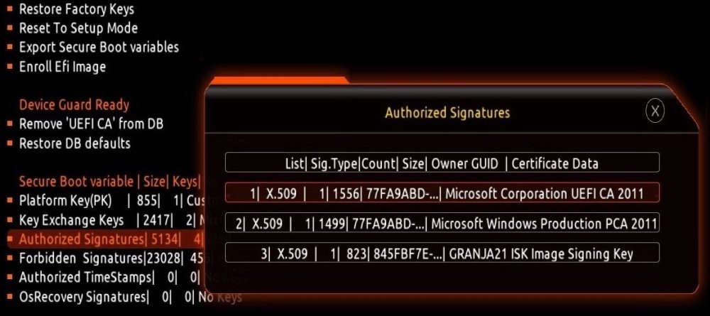

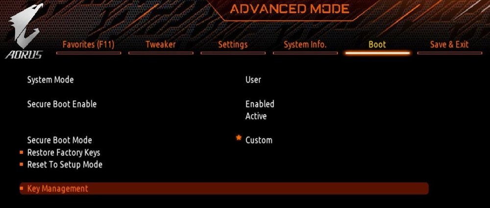

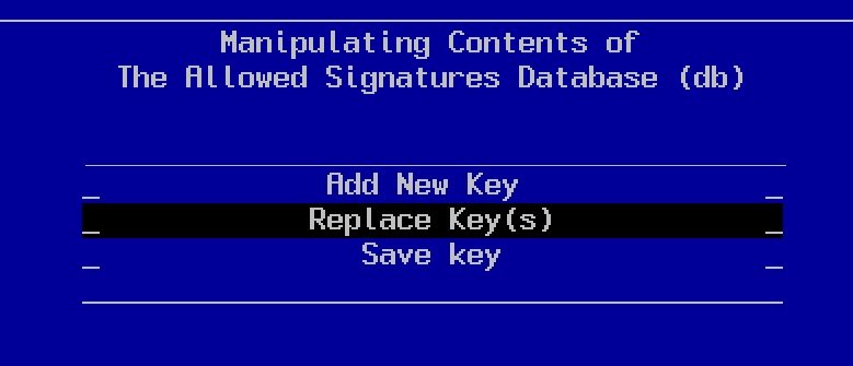

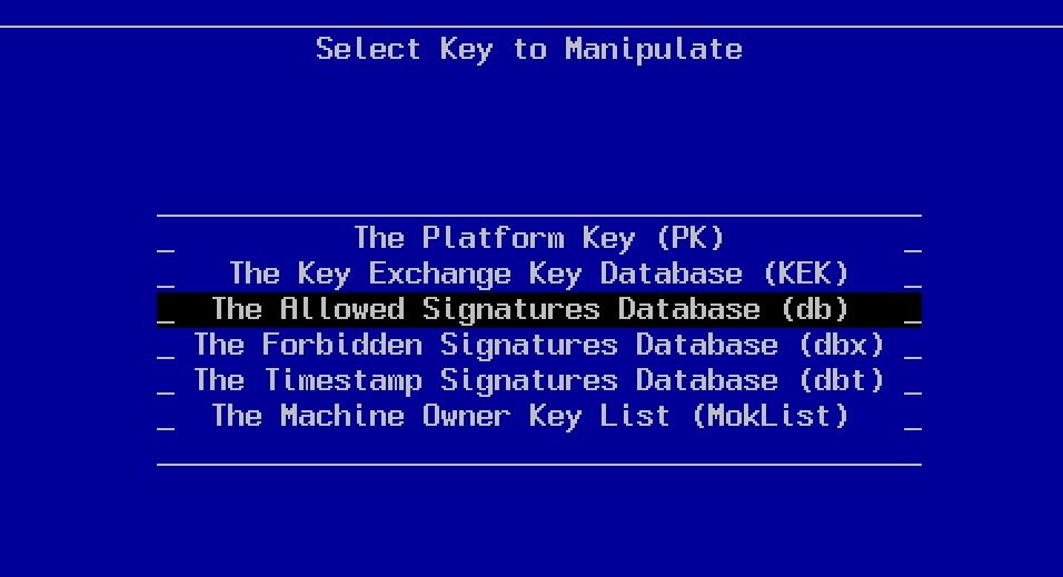

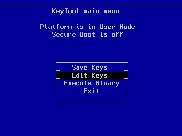

miliuco Posted June 22, 2024 Share Posted June 22, 2024 (edited) OpenCore and UEFI Secure Boot with UTM on macOS (1) How to insert our own signatures into the UEFI firmware (2) (this post) BIOS issues when modifying UEFI Secure Boot variables (3) Microsoft Windows Production CA 2011 updated by Windows UEFI CA 2023 (4) Final step of the process is to insert the signature files into the firmware, replacing the existing variables in this order: db.auth >> Authorized Signatures kek.auth >> KEK (Key Exchange Keys) pk.auth >> PK (Platform key). This can be done in 2 ways: BIOS setting menu or KeyTool. BIOS In the Secure Boot section there are usually options to restore default factory keys or to edit variables separately. On my motherboard (Z390 Aorus Elite) this menu is in Boot >> Secure Boot tab >> Key Management. If you have modified the keystores before (if it is not the first time) it is highly recommended, to avoid errors, restore default factory keys before adding / editing the new ones >> Restore Factory keys >> Install factory defaults >> Yes. Another option is Reset To Setup Mode that erases the firmware keys after reboot so that the default ones or the ones created by us can be loaded. Now you can edit the keys. Select the variable that you are going to modify in this order: Authorized Signatures (db) >> Key Exchange Keys (KEK) >> Platform Key (PK). For each variable you can see details, export, update (replace), add to the existing ones or delete. For example, for Authorized Signatures, options are Details / Export / Update / Append / Delete. To replace one variable with another: select Update >> search in the USB device >> locate and select db.auth >> this allowed signatures database replaces the current one. Likewise with Append if you want to add it to the existing one instead of replacing it. You can use Append with db.auth and kek.auth but pk.auth only allows replacement. To see the details, select Details >> variable's details are displayed. KeyTool KeyTool is included in the efitools Linux package, you can find the utility in /usr/share/efitools/efi/KeyTool.efi. How to use this tool? There are 2 ways: Copy KeyTool.efi with the name BOOTx64.efi into the EFI folder of an USB stick formatted as FAT32 and MBR Copy KeyTool.efi with the name BOOTx64.efi into the EFI folder of the EFI partition of an USB stick formatted as FAT32 and GUID. Next to BOOTx64.efi (KeyTool.efi), the EFI folder on the USB device must also include the files db.auth, kek.auth and pk.auth. When booting from this USB, a graphical interface is launched and we see a menu with the options Save Keys / Edit Keys / Execute Binary / Exit. Click on Edit Keys. Select the variable that you are going to modify in this order: Allowed Signature Database (db) >> Key Exchange Keys Database (kek) >> Platform Key (pk). First select the Allowed Signature Database (db) >> Replace Keys >> USB device >> db.auth >> click Enter >> return to the list of variables (message is displayed only in case of error). Repeat the same for Key Exchange Keys Database (KEK) and Platform Key (PK). Ending After inserting db.auth, kek.auth and pk.auth into the firmware, we can boot OpenCore and macOS with UEFI Secure Boot enabled. Edited June 22, 2024 by miliuco Index added 4 Link to comment https://www.insanelymac.com/forum/topic/359593-how-to-insert-our-own-signatures-into-the-uefi-firmware-2/ Share on other sites More sharing options...
