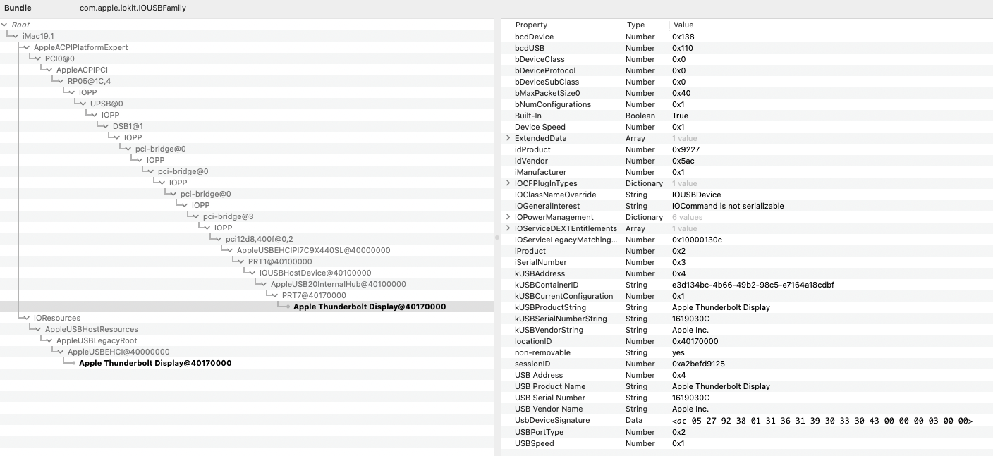

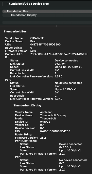

TijuanaKez Posted June 25, 2024 Author Share Posted June 25, 2024 (edited) Hmmm. I hadn't thought too hard about 'USB' showing up there as 'USB4' is often used interchangeable with Thunderbolt, like in the title of the System Profiler section. The display also has USB2.0 ports on it... though I dont intend to use any ports. First screenshot shows device correctly identified as a Thunderbolt Display, in Thunderbolt Mode, on the Thunderbolt Bus. Bit of a newb to IOReg, but I'm guessing you mean the device is in the wrong place? Could you point me in the right direction to rectifying the situation? Do you think I'd have more luck investigating DeviceProperties in OpenCore? Or will this be more of a custom SSDT task? Happy and willing to r&d it, but I don't know where to look as I dont understand what's wrong. Thanks! Edited June 25, 2024 by TijuanaKez 1 Link to comment https://www.insanelymac.com/forum/topic/359577-anyone-had-luck-with-apple-thunderbolt-displays/#findComment-2821789 Share on other sites More sharing options...
TijuanaKez Posted July 8, 2024 Author Share Posted July 8, 2024 On 6/24/2024 at 4:14 AM, Slice said: Did you propose that USB controller will work as a source of Video signal? Thanks for the hint! But can you clarify a bit? Are you saying that the Thunderbolt Display is misidentified as a USB device? Or have I have selected one of the USB ports on the display in IOReg in that screenshot? Link to comment https://www.insanelymac.com/forum/topic/359577-anyone-had-luck-with-apple-thunderbolt-displays/#findComment-2822402 Share on other sites More sharing options...
