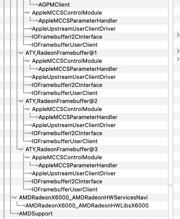

Fortitude Posted April 13, 2024 Share Posted April 13, 2024 (edited) I cannot for the life of me get my external graphics card working properly with macOS Ventura. It’s an AMD Radeon RX 6950 XT connected to an Alienware Graphics Amplifier which is then connected to my Alienware Area 51m R2 laptop. I’ve managed to create a bridge device and spoofing SSDTs and also tried using the device properties to spoof the device-id. I’ve even tried flashing my graphics card with the 6900 XT vBIOS. However, I always get a page fault whenever the external graphics card is plugged in at boot initialization and never reach the login screen. I know that the card is getting recognized because my external monitor brings me to a black screen. In case this is an important point to mention, the amplifier only started working properly in Windows after applying the HackFlags DWORD to the registry. SSDT-BRG0.aml SSDT-GPU-SPOOF.aml Edited April 13, 2024 by Fortitude Link to comment https://www.insanelymac.com/forum/topic/359169-spoofed-egpu-causes-kernel-panic/ Share on other sites More sharing options...

Fortitude Posted October 17, 2024 Author Share Posted October 17, 2024 (edited) Hi everyone, I’m still grappling with this issue and wanted to revisit the topic with a new thought. To recap this topic, my laptop has an internal 5700M connected over PCIe, and I'm connecting a 6950XT (spoofed as a 6900XT) also over PCIe through an external enclosure. Connecting the 6950XT causes the framebuffer to panic (see the screenshots in the first post). I hope this isn’t a silly question, but does anyone here have a custom Hackintosh desktop with two Navi GPUs running at the same time? Most of the dual-GPU configurations I’ve seen online for Hackintosh systems involve pairing an AMD GPU for macOS with an NVIDIA GPU for Windows/Linux. Edited October 17, 2024 by Fortitude Link to comment https://www.insanelymac.com/forum/topic/359169-spoofed-egpu-causes-kernel-panic/#findComment-2826587 Share on other sites More sharing options...
