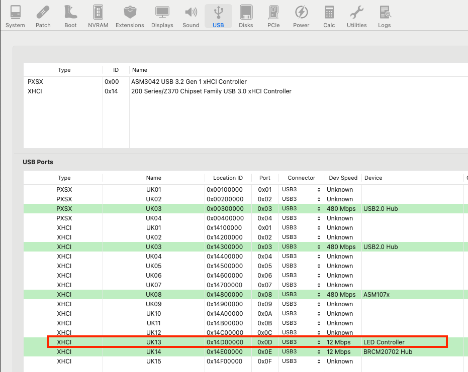

panosru Posted September 25, 2024 Author Share Posted September 25, 2024 So, after a lot of trying, I managed to find out to which USB port the internal ARGB of the motherboard were assigned. By removing the port from the USB mapping, the ARGB controllers work fine. If you are fortunate enough, you may find right away on which USB port the LED controller is assigned to: If you are not so lucky (I wasn't), you have to try each port one by one and after too many reboots, eventually, you'll pinpoint which port is to blame and not include it in your port mapping. After I identified the port responsible for the LED controller, I tried all the available USB mapping tools, and just by excluding this port, they all worked fine. Under Windows, if you use the USBToolbox, usually the LED controller port will be marked as "undefined". Link to comment https://www.insanelymac.com/forum/topic/358980-strange-behaviour-for-addressable-rgb-headers/#findComment-2825910 Share on other sites More sharing options...
