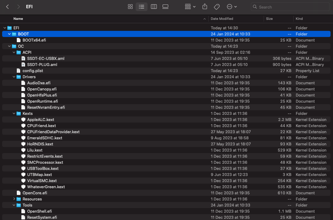

ichelash Posted February 2 Share Posted February 2 (edited) Hey guys i need your input in this issue I'm facing with my Hackintosh. Currently I'm using Ventura 13.6, but i have Sonoma, Monterey and Big Sur on Other drives also working, but the issue with all this installs is that..at times when I'm just using the hack, out of nowhere the machine just randomly freeze and it must be forcefully shutdown for to restart. Intel core i3-6100,. Attached is my config plist, someone maybe can see the issue I'm not seeing myself.. Any help will be appreciated T.I.A Currently using OC 0.9.7 Release version...every kexts is updated. config.plist Edited February 2 by ichelash Link to comment Share on other sites More sharing options...

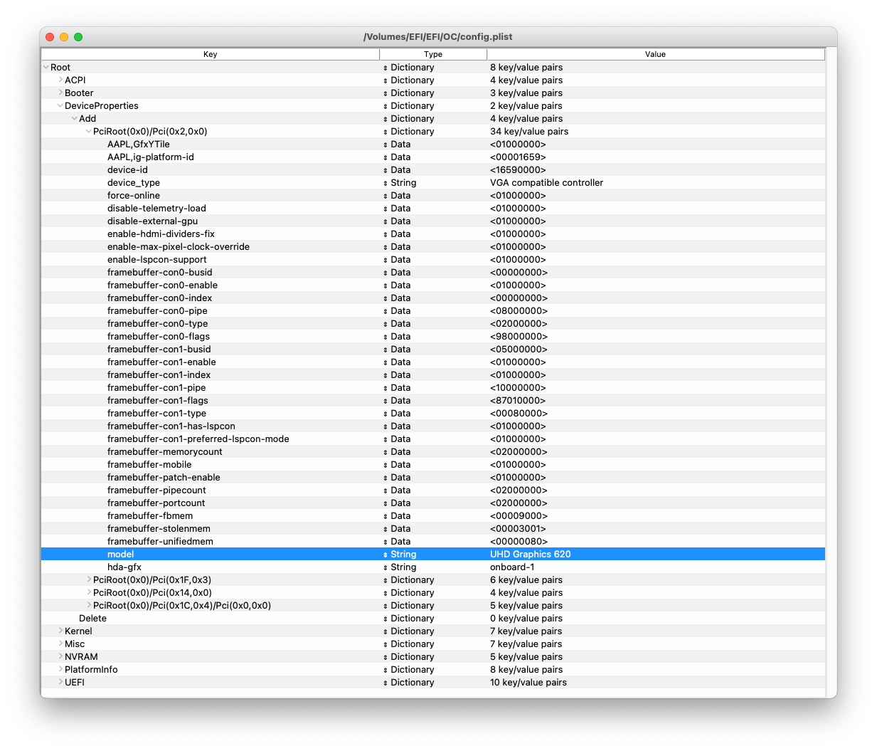

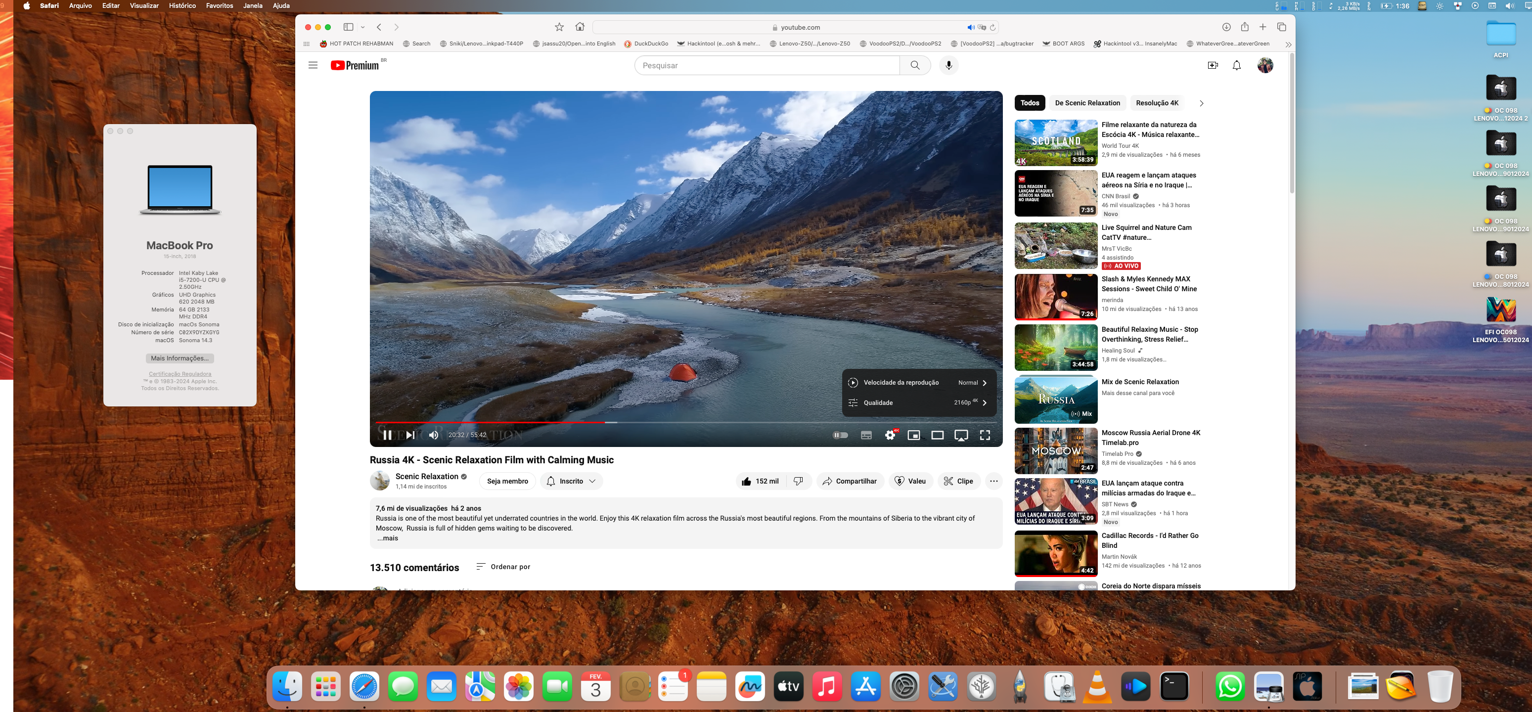

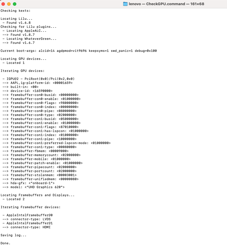

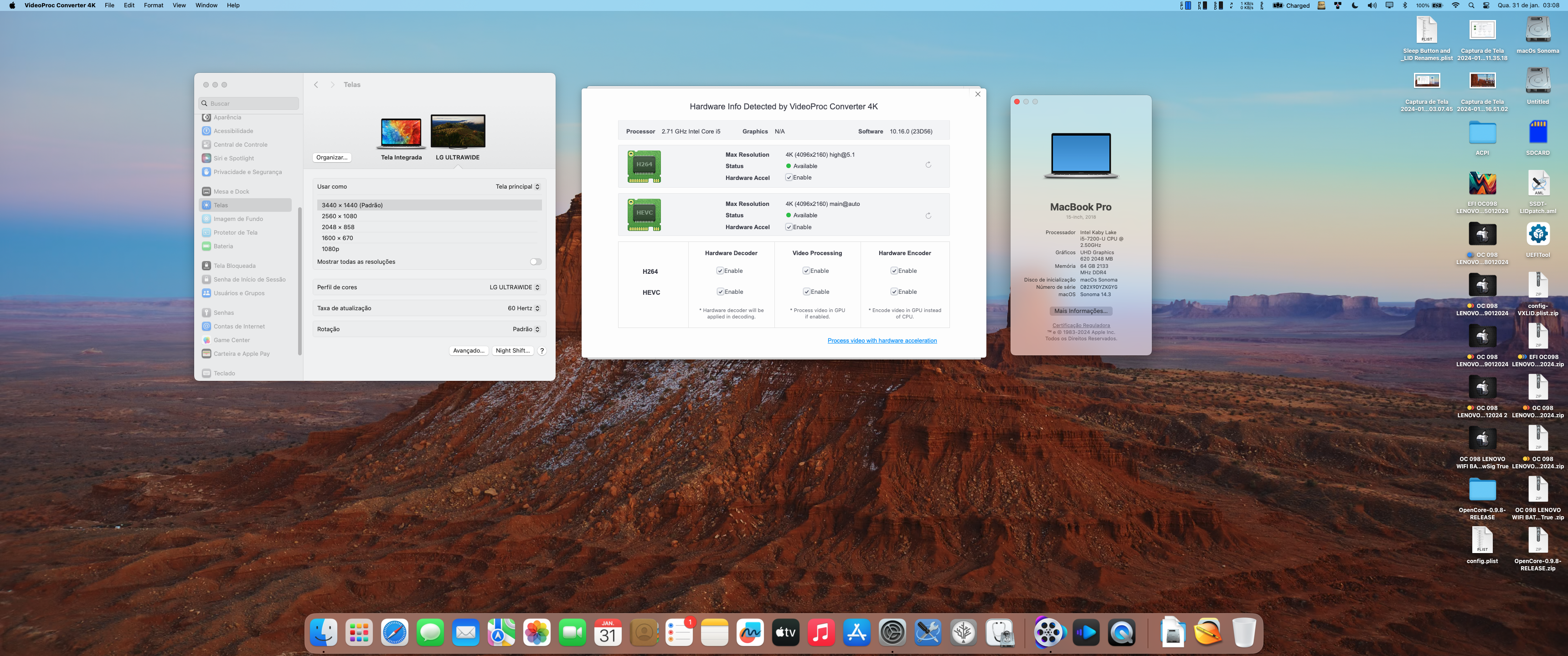

Max.1974 Posted February 3 Share Posted February 3 Hi, i have been success build my Device plist, and after days and weeks reading RehabMan and DUMP my AppleIntelFramebuffer im fix with excellent Resolution my Kaby Lake i5 7200-U. If you will use HDMI I recommend you avoid use this arguments: enable-hdmi20 Data 01000000 AAPL,slot-name Try use this config list and just check on IOREG what's is yours connectors and ports. Just put on Nvram boot-args only " agdpmod=vit9696 " Its important try avoid conX-all-data too. Option one UHD 520 UHD520-SKL.plist.zip Keep in mind that you need check your ports and connectors with IOREG or AIDA64 on Windows, because some configurations need specified Pipe, BusID, Conector Type and flags. Just that. Better combination that im use on my Lenovo E470 is this: Option 2 UHD 620 UHD620-KBL.plist.zip 4k 2160p smooth run Spoiler HVEC and H264 60Hz 4k Spoiler Spoiler 2 Link to comment Share on other sites More sharing options...

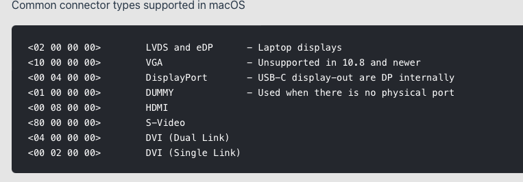

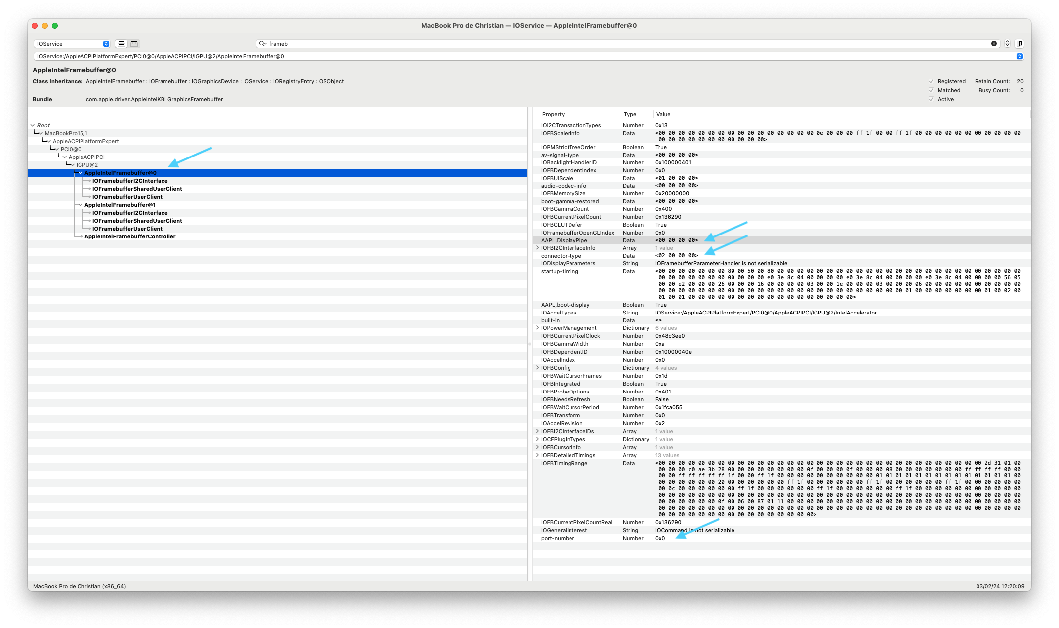

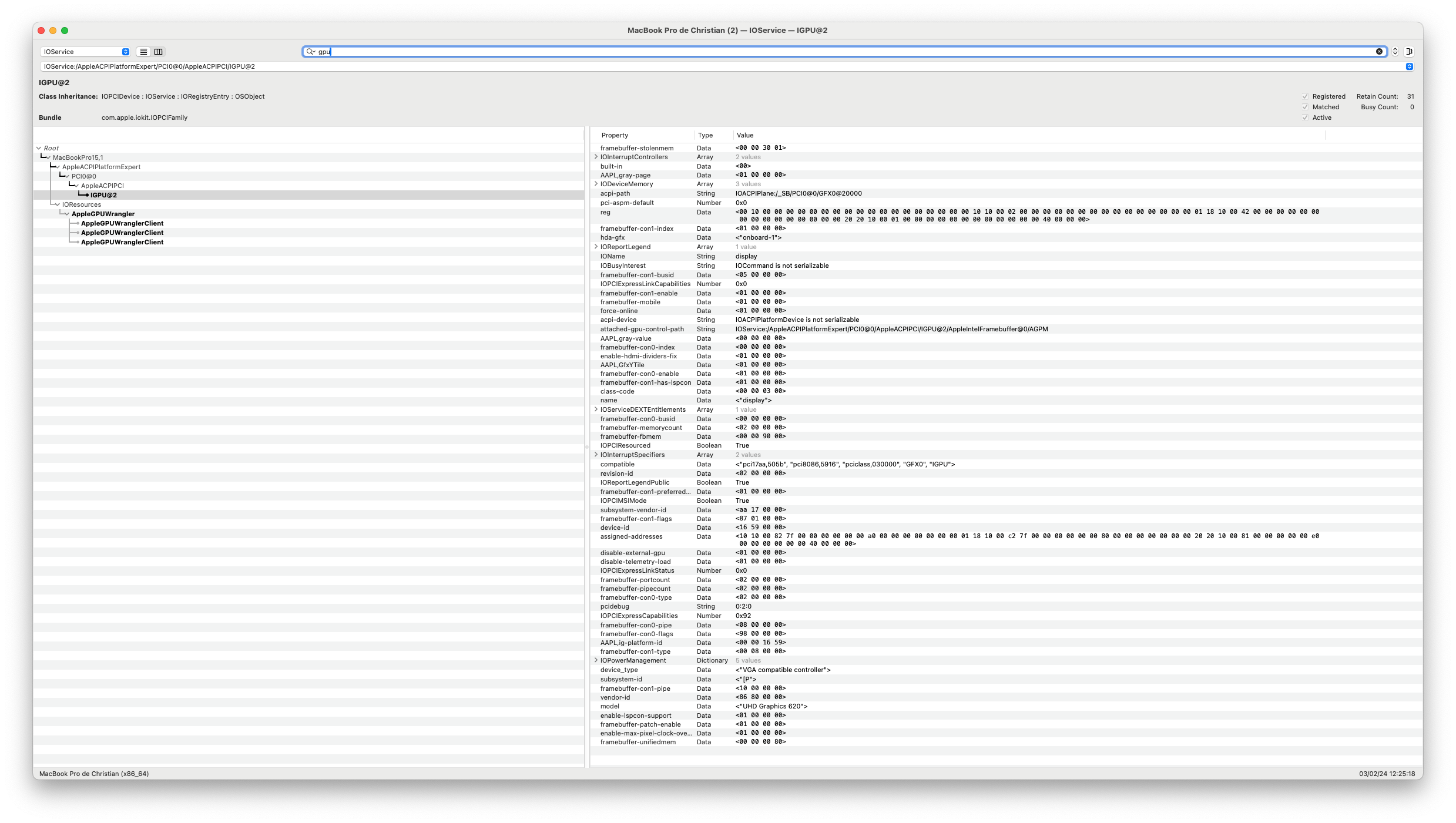

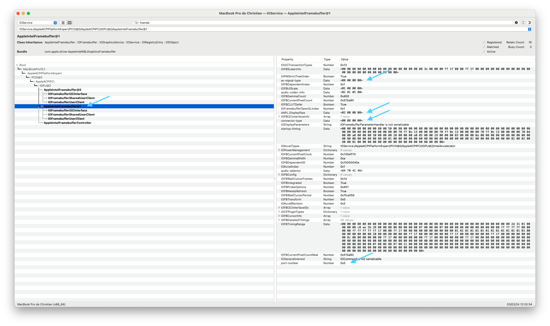

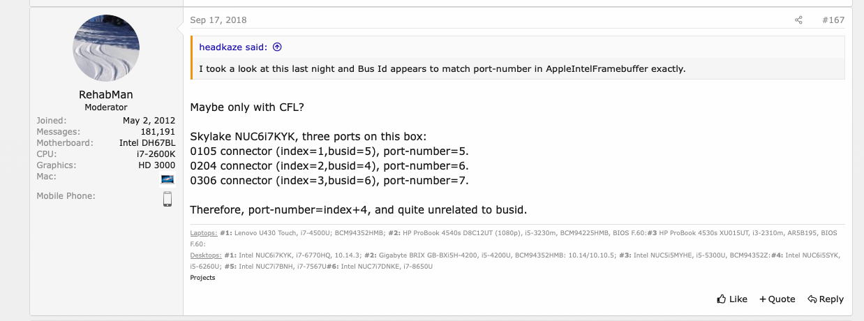

Max.1974 Posted February 3 Share Posted February 3 (edited) If you could see that not matter your intel UHD Hardware, but your conector Type, your port number and so you will specified in accord with you need. You need to know exactly your device ID, but all instructions on Intel processor UHD was the same, what is change is your hardware. You need put the parameters to works in accord with you have. For exemple, my first conector LVDS on my Laptop is port number 0x00 So im need necessary index on my device plist con0 (not port, but built-in 00. See my IOREG print Port-number 0x00 - Appleintelframebuffer@0 - AAPL, DisplayPipe (is con0) <00 00 00 00> - ConectorType 2 <02 00 00 00> (con0-type data 02000000) - (LVDS, VGA) - I specified a Pipe (tube conector inside your MB) compatible 8 <08 00 00 00> (con0-pipe data 08000000) Im specified Port 0x00 with Index 0 (con0-index) data <00 00 00 00> and BusID 00 (is for Port 0 only) (con0-busid data <00 00 00 00 >). And for last the flags specified to conector type 2, and accord to Framebuffer dump, in my case UHD 620 is con0-flags data 98000000 It's was a Rehabman instructions. Spoiler Port-number 0x05 - Appleintelframebuffer@1 - AAPL, DisplayPipe (is index on con1) <01 00 00 00> - ConectorType 8 <00 08 00 00> (con1-type data 00080000) - (HDMI, DP) - I specified a Pipe (tube conector inside your MB) compatible 10 <10 00 00 00> (con1-pipe data 10000000) Im use in index 1 (con1-index) data <01 00 00 00> and BusID 05 (is for HDMI or DP only) and using (con1-busid data <05 00 00 00 >). So use your specific flag to HDMI signal 4k for exemple, is in my case 87010000 (con1-flags data 87010000) Spoiler See results on my plist and on my IOREG Spoiler In my device properties im use this to inform Intel UHD 620 i5-7200-U Kaby Lake the instructions to generate signal according with your connectors, Pipes, BusIDs. Spoiler You can check better informations on WEG page for list of frame buffers that is universal to all processors from same specifications, for exemple in my case UHD 620. Im extract Intelframebuffer, but not change universal info. All informations is inside processors, but you need adjust according your hardware (outside - Mother board, i.e) Check on spoilers, im choose these is my specific Frame Device ID 59160000, because its have HDMI conector, another not have on list, for exemple. Im use BusID 5 (0x05) and Pipe 10 to active signal from my HDMI conector type 0x00000800 (00080000 Hex reverse) Note that im change according to my Hardware accept and not use Bus ID 4 like FB information, but change to BusId 5 and use Pipe 10. No problem. It's hardware conectors (pipe and busid) that works to me. Im not use too Pipe 9, because not works to my HDMI, maybe DP. ID: 59160000, STOLEN: 34 MB, FBMEM: 0 bytes, VRAM: 1536 MB, Flags: 0x00000B0B TOTAL STOLEN: 35 MB, TOTAL CURSOR: 1 MB (1572864 bytes), MAX STOLEN: 103 MB, MAX OVERALL: 104 MB (109588480 bytes) Model name: Intel HD Graphics KBL CRB Camellia: CamelliaDisabled (0), Freq: 1388 Hz, FreqMax: 1388 Hz Mobile: 1, PipeCount: 3, PortCount: 3, FBMemoryCount: 3 [0] busId: 0x00, pipe: 8, type: 0x00000002, flags: 0x00000098 - ConnectorLVDS [1] busId: 0x05, pipe: 9, type: 0x00000400, flags: 0x00000187 - ConnectorDP [2] busId: 0x04, pipe: 10, type: 0x00000800, flags: 0x00000187 - ConnectorHDMI 00000800 02000000 98000000 01050900 00040000 87010000 02040A00 00080000 87010000 Conectors Type Spoiler https://github.com/acidanthera/WhateverGreen/blob/master/Manual/FAQ.IntelHD.en.md Check the Master Rehabman information, he is almost there helped HeadKaze, but they think that was connection between Ioreg ports an BusIDs numbers, what is not always have, just coincidence. Spoiler Now with all this specifications, my Lenovo LVDS works fine, with or without HDMI connected, but run and not need close LCD (LID), just works 100% better than Windows. Like im read in some place on AppleLife Ru, Windows not matter because on my Lenovo, only works in 50hz. * https://www.applelife.ru/threads/intel-hd-graphics.1289648/page-432 * im could get login on this webpage, so I don't remember exactly but Windows first made driver, after that adjust. In Hackintosh System works on 60hz. For more informations see too: https://github.com/acidanthera/WhateverGreen/blob/master/Manual/FAQ.IntelHD.en.md#hdmi-in-uhd-resolution-with-60fps https://dortania.github.io/OpenCore-Post-Install/gpu-patching/intel-patching/busid.html#parsing-the-framebuffer https://github.com/dortania/OpenCore-Post-Install/blob/master/gpu-patching/intel-patching/connector.md https://www.hackintosh-forum.de/forum/thread/38316-hackintool-ehemals-intel-fb-patcher/ https://pikeralpha.wordpress.com/2013/08/02/appleintelframebufferazul-kext-part-ii/ And Rehabman and Headkaze on "the other side of the force".... Best Regards Edited February 3 by Max.1974 1 1 Link to comment Share on other sites More sharing options...

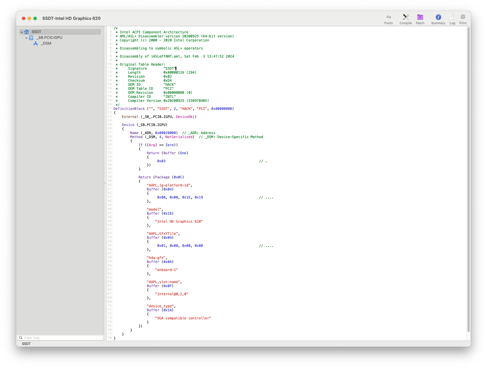

Max.1974 Posted February 3 Share Posted February 3 Can you try use an SSDT for your hardware too like mine, but is not so necessary, its a plus for image LCD from signal colors better vision. More clear. SSDT-Intel HD Graphics 620.aml.zip Spoiler 1 1 Link to comment Share on other sites More sharing options...
