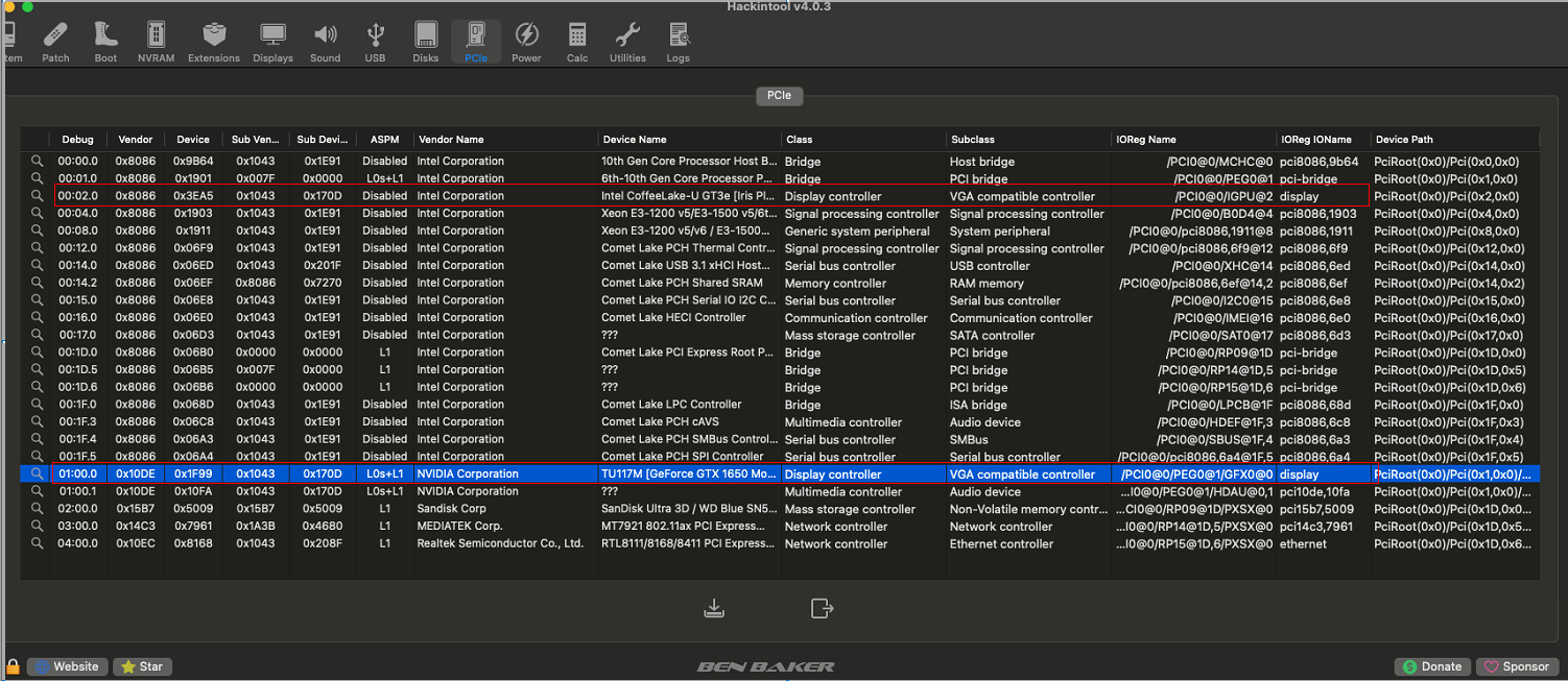

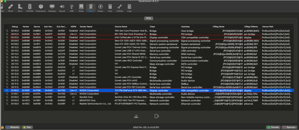

hoaug Posted January 27, 2024 Share Posted January 27, 2024 (edited) Hello everyone, I have an Asus TUF Gaming F15 Laptop with the following specs: CPU: i5-10300H GPU: UHD630 and GTX1650 ( This dGPU is super strange, I'll explain below ) RAM: 16GB SSD: SN550 Wifi: Unsupported SOLVED: I used the EFI folder and maLd0n and brightness worked (with the Slice's AAPL,backlight-control value too). I have successfully installed macOS Sonoma on my machine. Everything works perfectly except the screen brightness. I can't control it even though I have SSDT-PNLF (tried SSDT-PNFL-CFL) and SSDT-NoHybGfx.aml to disable dGPU but I still can't control the screen brightness. I checked Hackintool -> Pcie and discovered that even though the dGPU was Disabled, it still appeared with GFX0 (it seems to conflict with the IGPU so PNLF was not patched for the iGPU). I have tried many ways to Disable GFX0 of the dGPU but all failed (it still appears there without being lost). I also tried rename GFX0 to iGPU but it didn't work either. If anyone knows or has experience with a situation like mine, please help me. Thank you very much. Below are my DSDT and EFI folders: DSDT.aml EFI.zip Edited January 28, 2024 by kinhhoang161 SOLVED 1 Quote Link to comment https://www.insanelymac.com/forum/topic/358571-solved-asus-tuf-gaming-f15-cant-make-brightness-control-working/ Share on other sites More sharing options...

Slice Posted January 27, 2024 Share Posted January 27, 2024 2 hours ago, kinhhoang161 said: im disabled it ad. but i cant control brightness Try to set property for IGPU <key>AAPL,backlight-control</key> <data>AQAAAA==</data> 2 Quote Link to comment https://www.insanelymac.com/forum/topic/358571-solved-asus-tuf-gaming-f15-cant-make-brightness-control-working/#findComment-2815945 Share on other sites More sharing options...
hoaug Posted January 28, 2024 Author Share Posted January 28, 2024 @MaLd0n Thank you very much for helping me. I used your EFI build for me along with AAPL,backlight-control (I kept adding it even though I didn't know if it was necessary). but finally the screen brightness worked. I was able to control the screen brightness. If you can help me explain why you did that, I don't see you using any SSDT to Disable dGPU but only using boot-args (but it also works). Anyway I'm very grateful, thank you very much. @Slice Thank you very much for your help. I have controlled the brightness. 1 Quote Link to comment https://www.insanelymac.com/forum/topic/358571-solved-asus-tuf-gaming-f15-cant-make-brightness-control-working/#findComment-2815955 Share on other sites More sharing options...
MaLd0n Posted January 28, 2024 Share Posted January 28, 2024 Hey. Good to know. Aplly ur ssdt to disable gpu bootarg just spoof device and not full disable. U can stay with bootarg and ssdt. 3 Quote Link to comment https://www.insanelymac.com/forum/topic/358571-solved-asus-tuf-gaming-f15-cant-make-brightness-control-working/#findComment-2815959 Share on other sites More sharing options...
