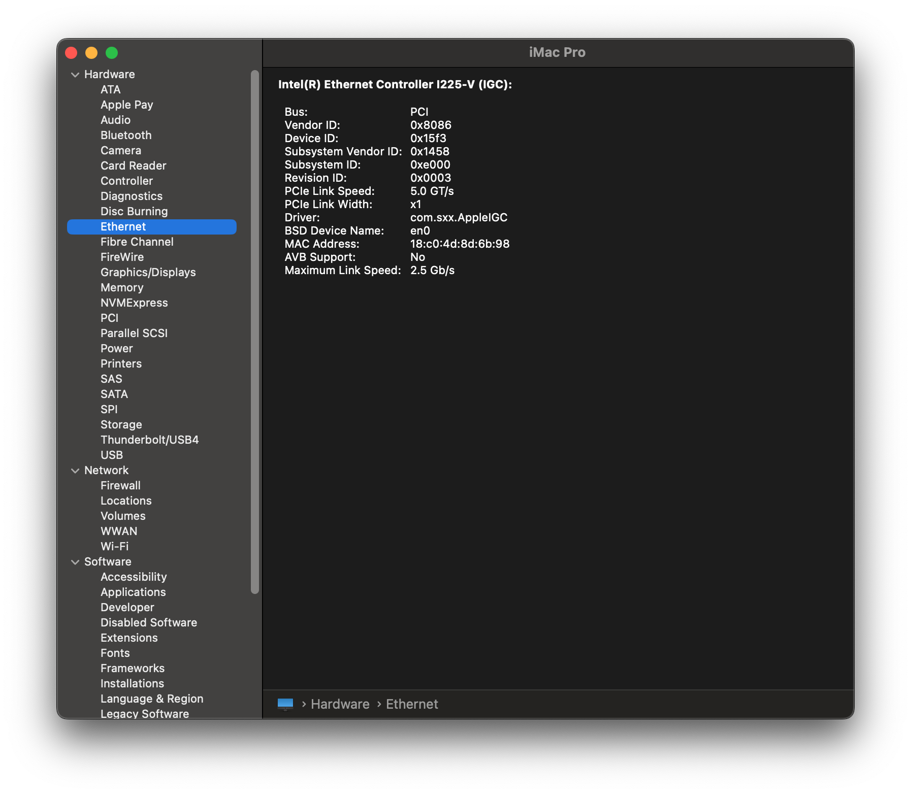

Ethernet
On 12/29/2023 at 10:45 PM, Slice said:
i225-V may works with AppleIGC driver
Working (AppleIGC)

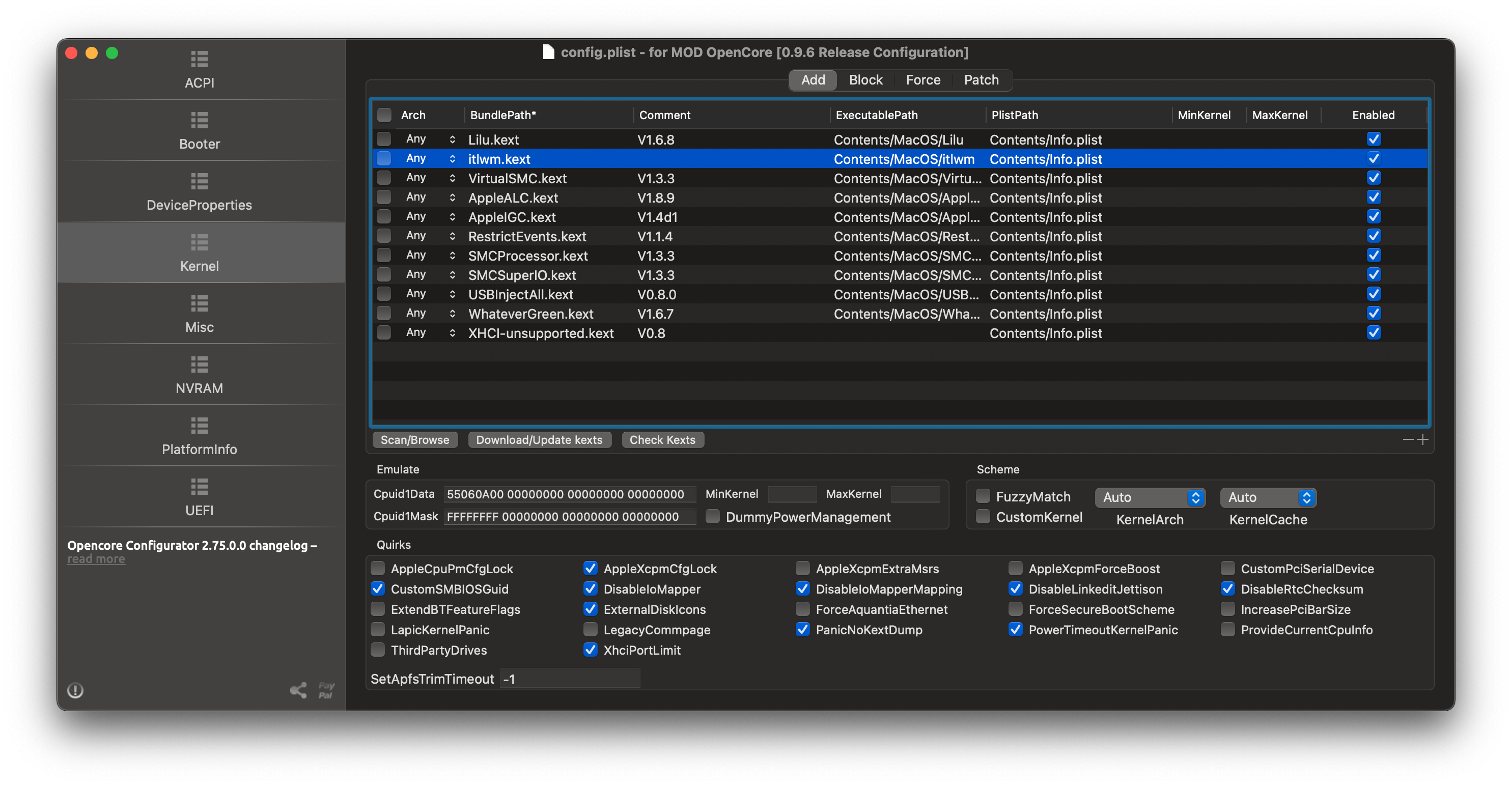

Wireless / BT is not working.
Added to EFI /EFI/OC/Kexts/itlwm.kext (as per https://openintelwireless.github.io/itlwm/Installation.html )
Tried the troubleshooting steps here: https://openintelwireless.github.io/itlwm/Troubleshooting.html Resetting System Preferences - Network but this had no effect as far as I could tell.

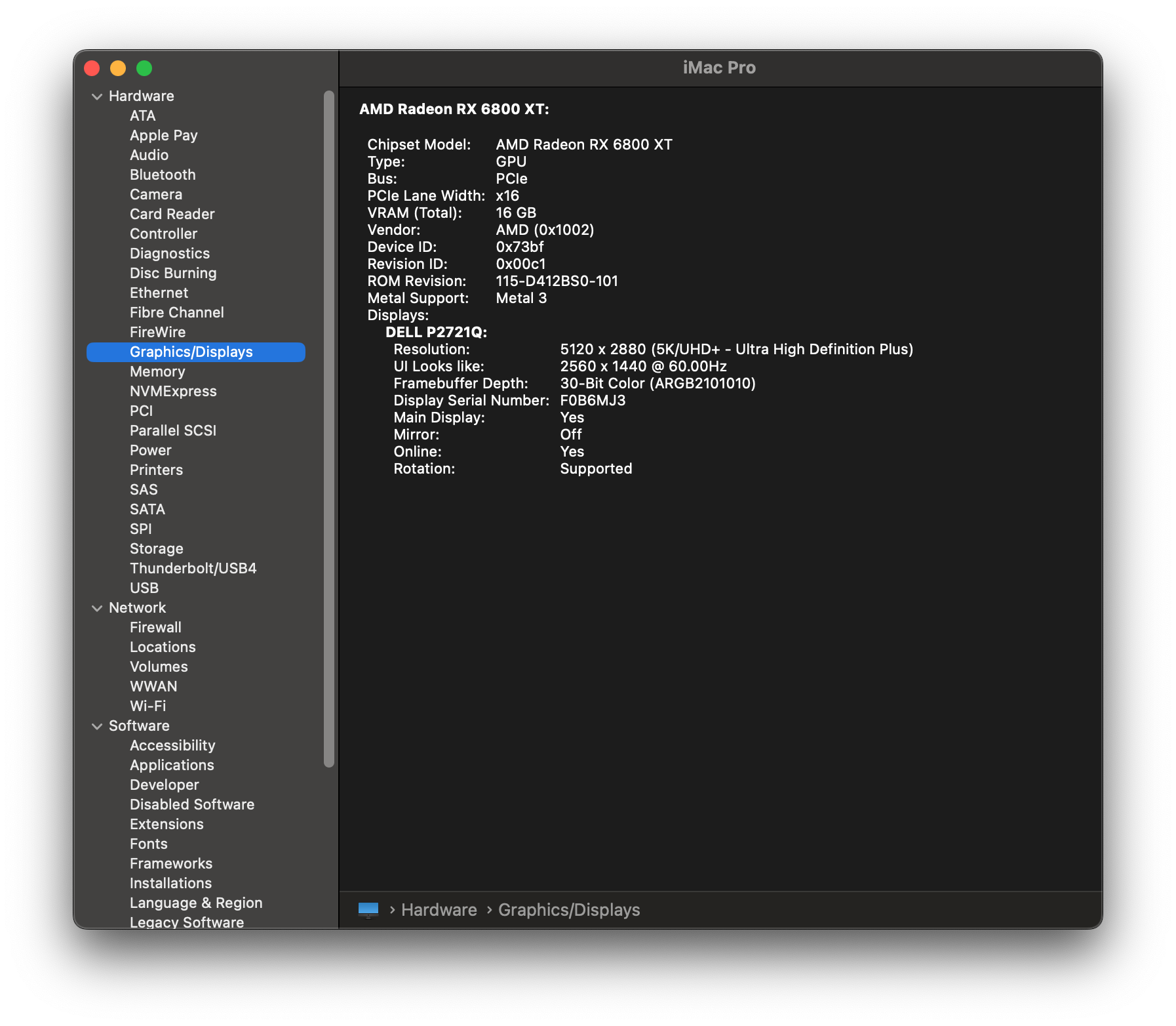

Graphics
Working

I couldn't attach the EFI folder but it's the same as Mald0n's with 16MB itlwm kext included. config.plist added anyway.

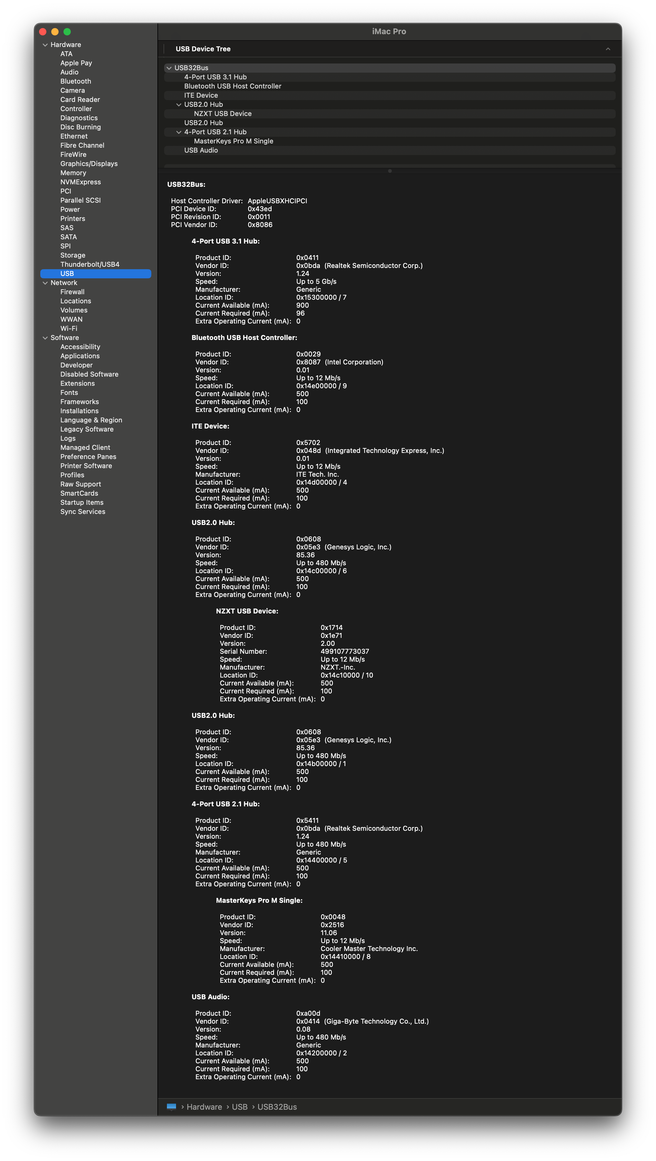

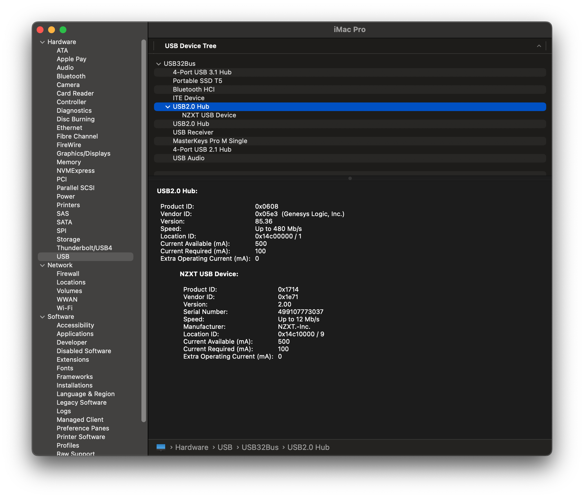

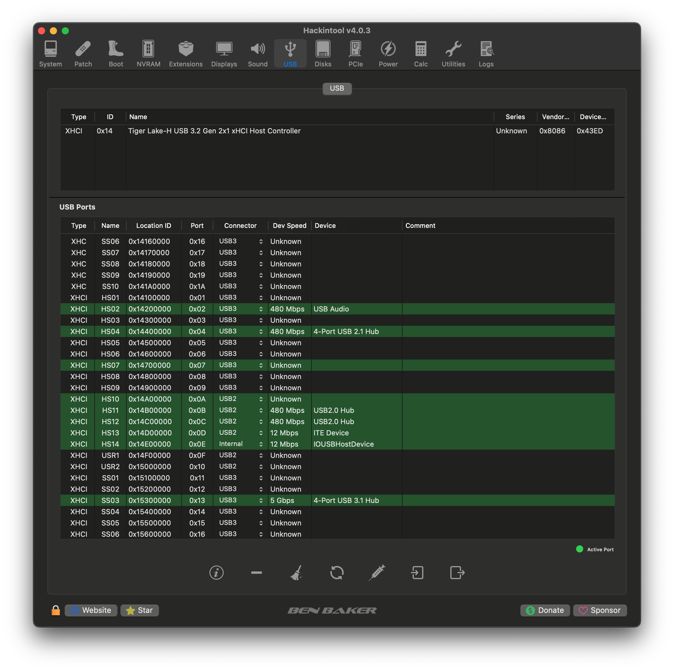

USB
The mapping seems to have worked. One port (I have 16 ports) does not work. If I recall there is a 15 port limit.

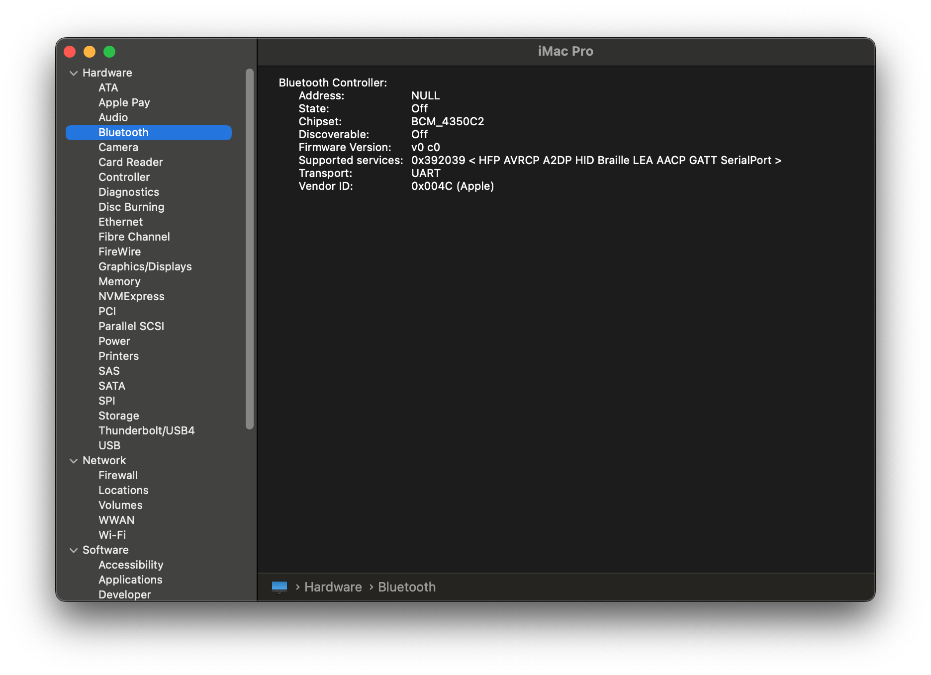

Bluetooth
The BT kexts seem to have worked but the BT performance was not amazing until I got the wireless antenna mounted.

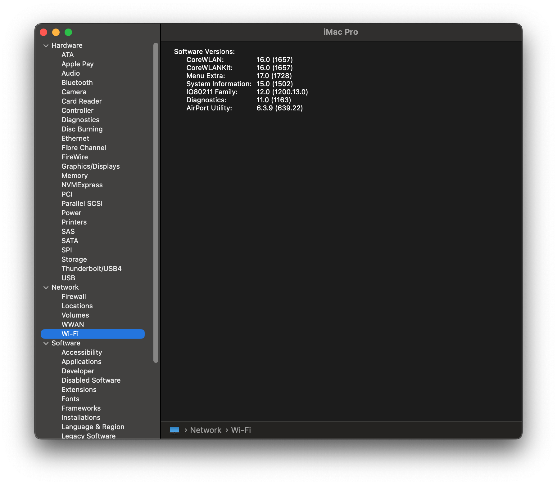

WiFi
Works - Used the kext called AirportItlwm-Sonoma-v2.3.0-DEBUG-alpha-ff1138b.zip and once in place ran through the troubleshooting steps here: https://openintelwireless.github.io/itlwm/Troubleshooting.html Resetting System Preferences.

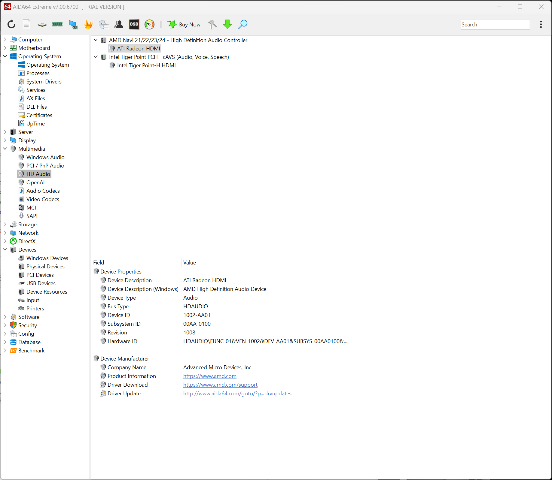

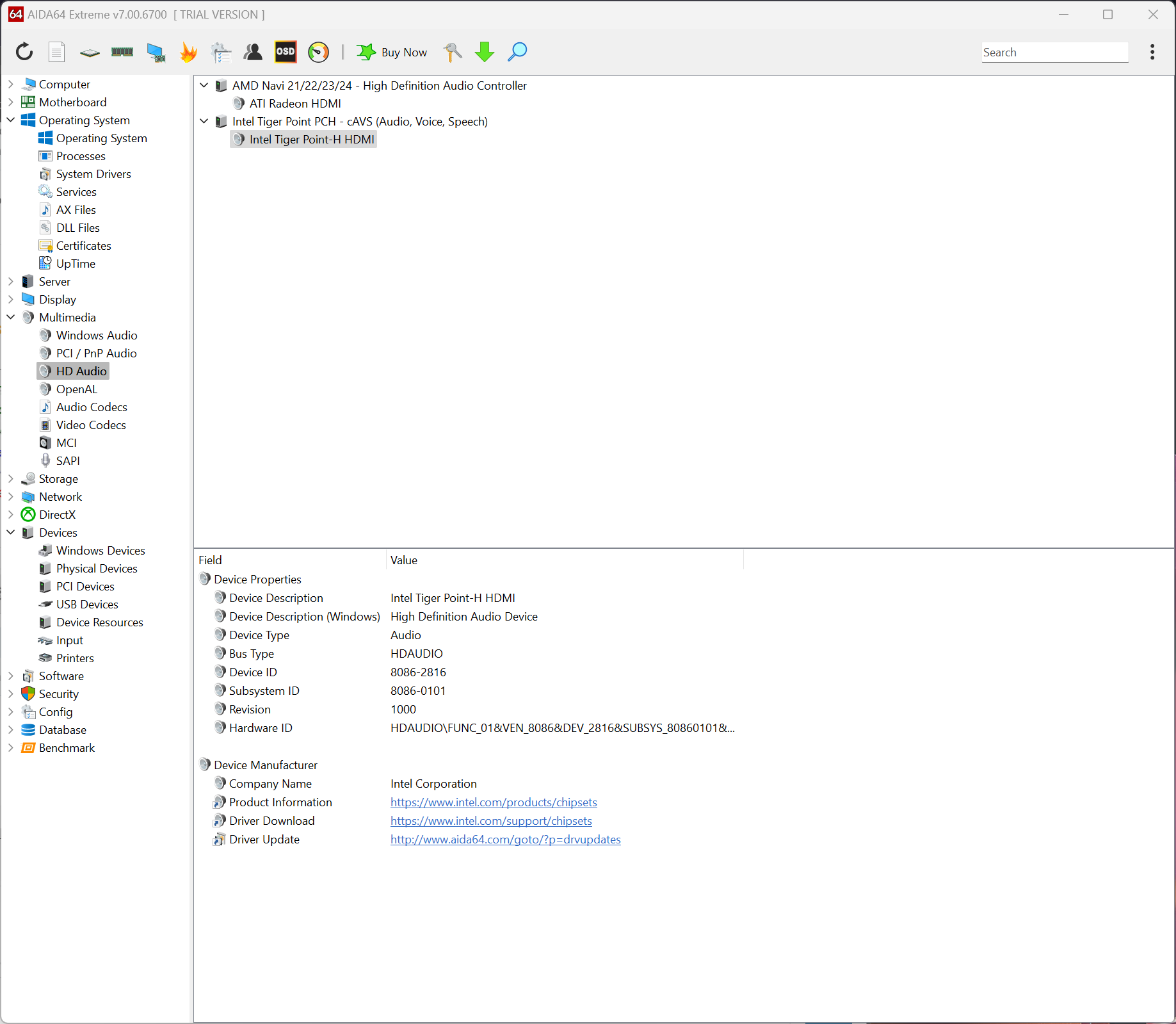

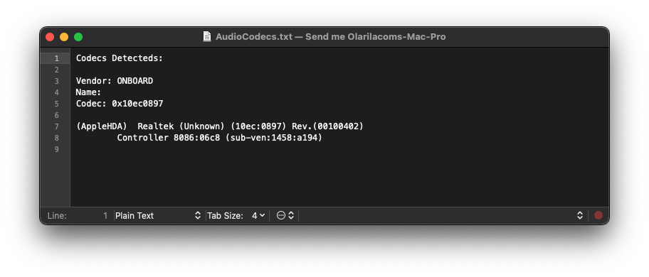

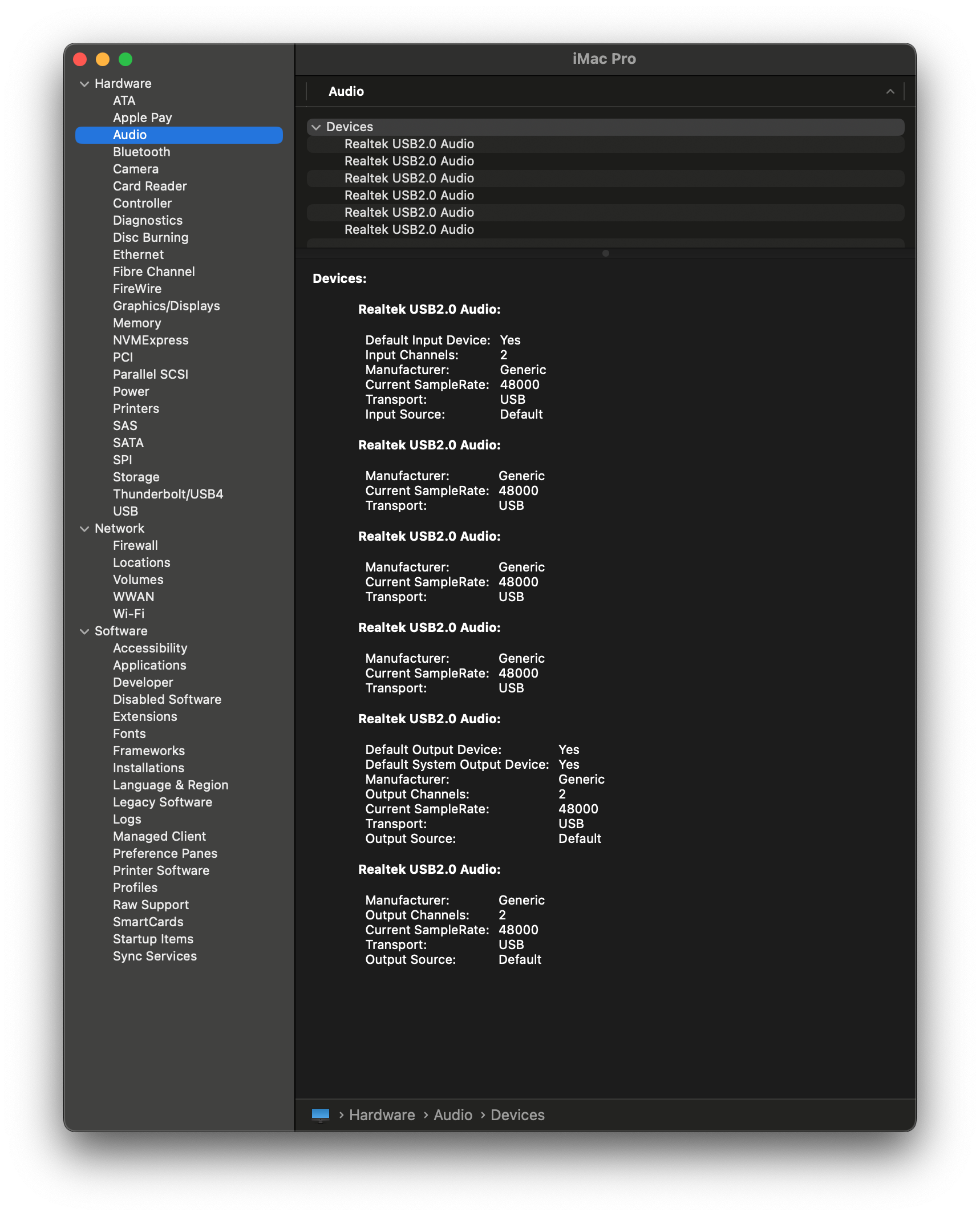

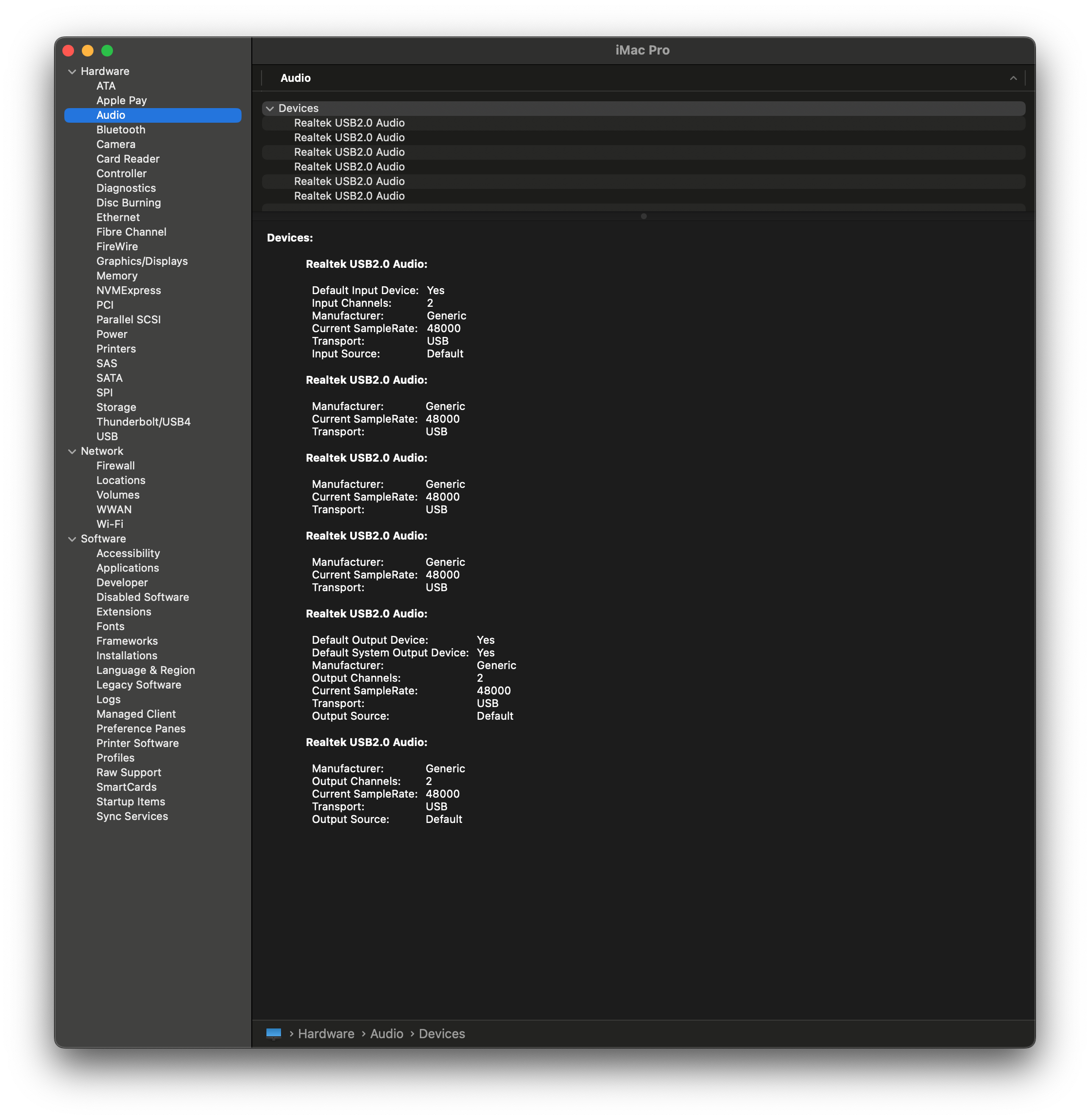

42 minutes ago, Slice said:
I see Realtek USB2.0 Audio. It is good but you also have embedded audio. The computer will not sleep if the device is not served by some driver. Because of powerManagement chain.

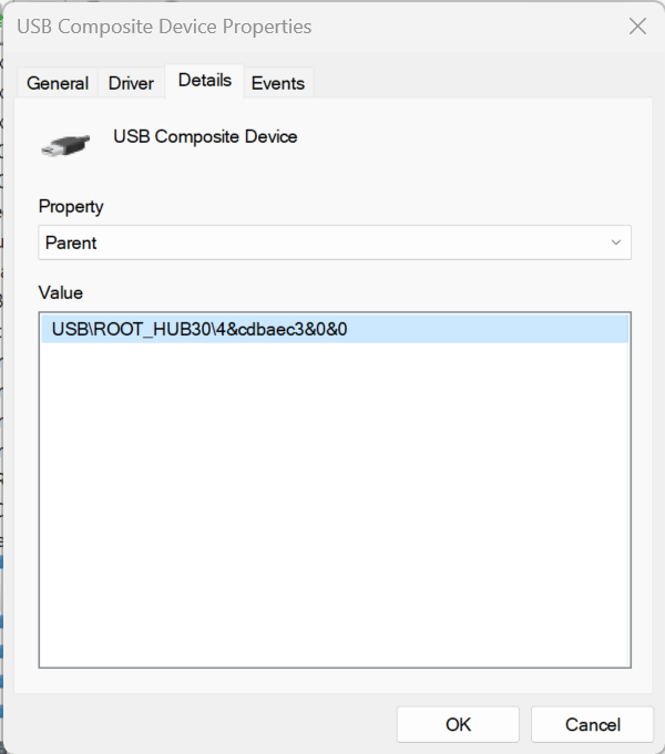

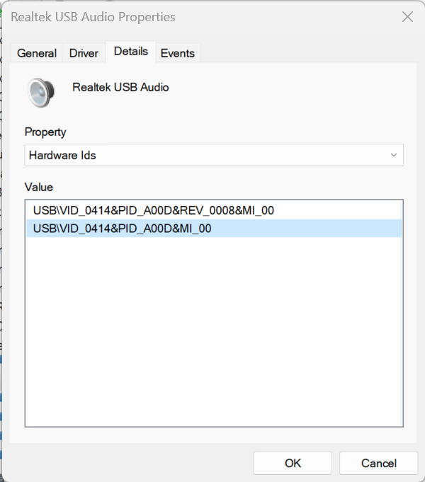

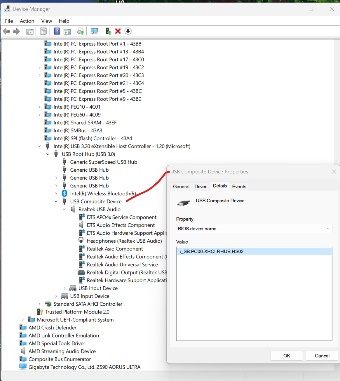

@Slice I'll reboot into Windows and try and get more info on the parent.

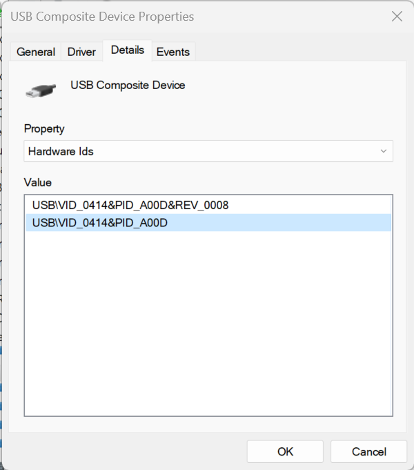

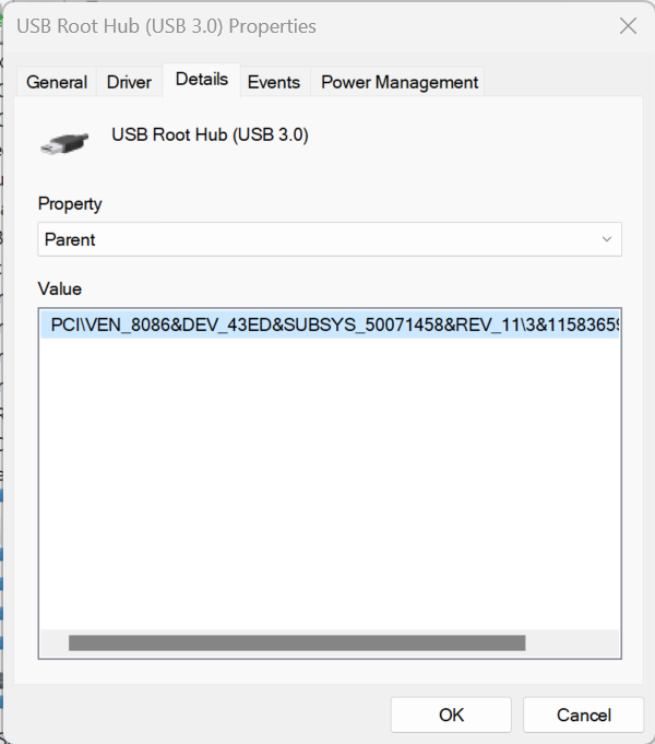

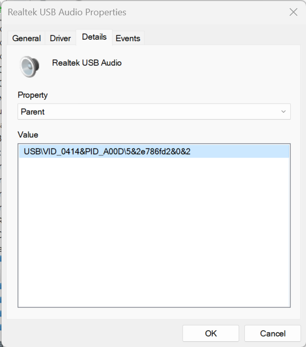

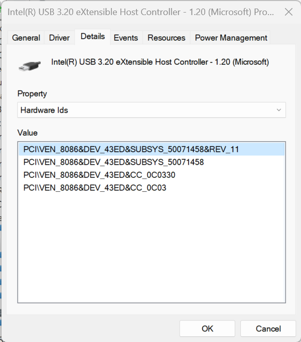

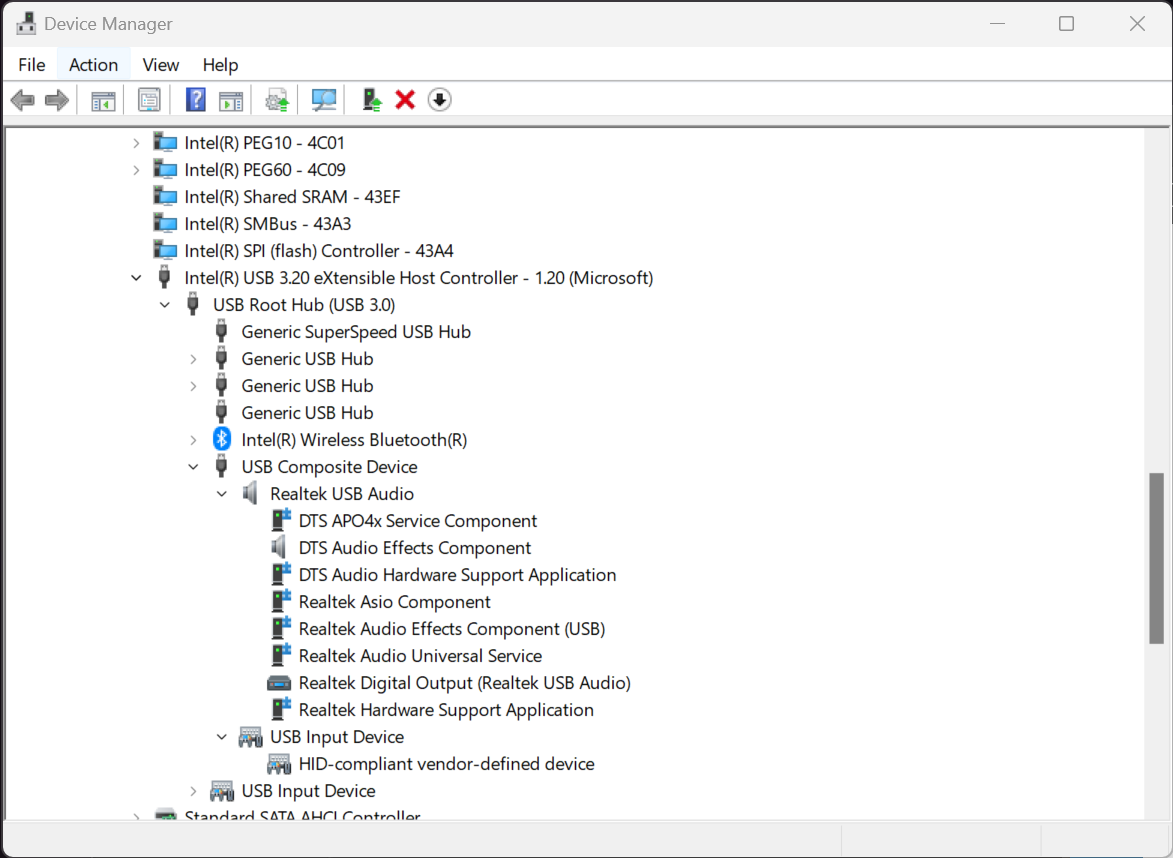

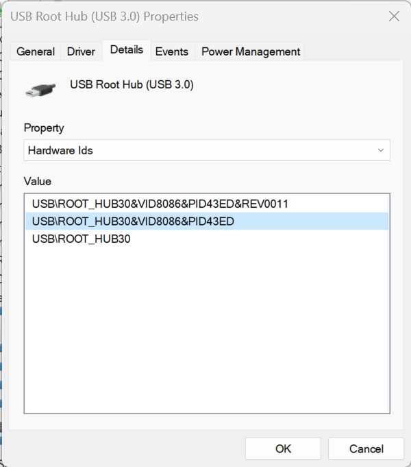

Hi @Slice Not sure how useful the above was. Took another look at the device connections with Windows Device Manager instead.
Realtek USB Audio Device:
USB\VID_0414&PID_A00D&MI_00
Shows following parent:
USB Composite Device:
USB Root Hub (USB 3.0):
USB\ROOT_HUB30&VID8086&PID43ED
PCI\VEN_8086&DEV_43ED&SUBSYS_50071458&REV_11\3&11583659&0&A0
Intel(R) USB 3.20 eXtensible Host Controller - 1.20 (Microsoft)
Edited by takeawaydave

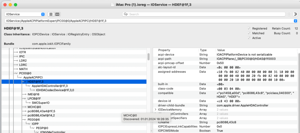

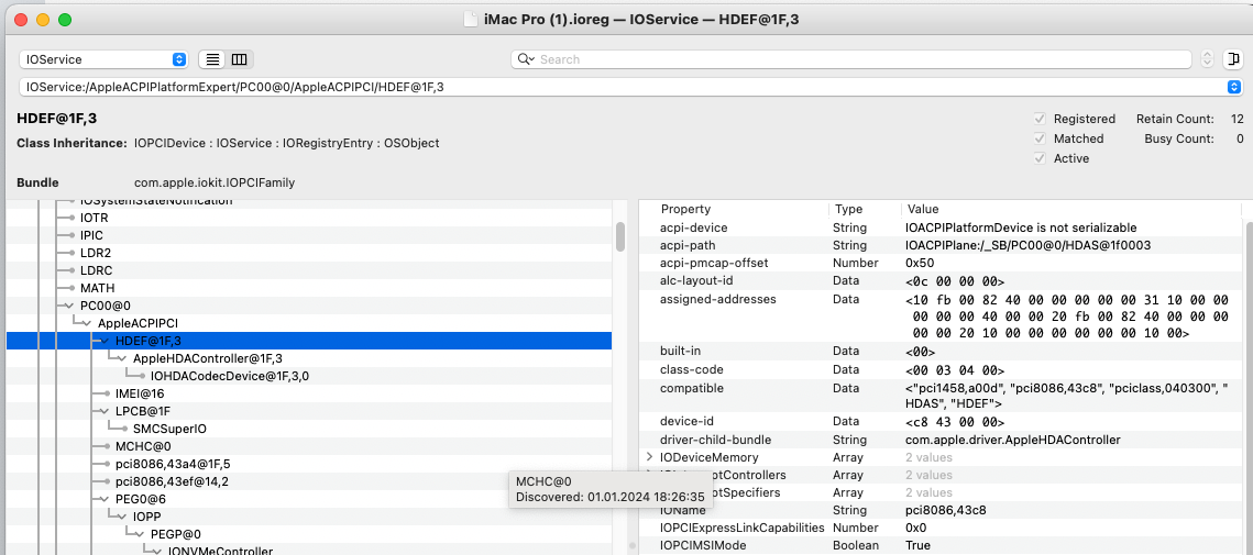

23 minutes ago, takeawaydave said:
 Yeah could be. Checking now. In the mean time I checked the ioregistry and couldn't see a reference.
Nothing obvious that I could see in the BIOS with any reference to Realtek. All I could see was an option to enable/disable HDA sound.

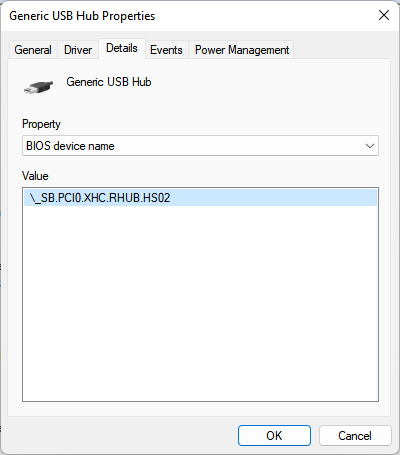

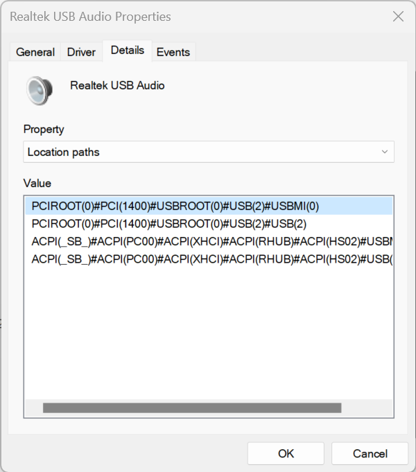

USB Audio Device: from the property dropdown menu in device manager, select "BIOS pathname" or similar instaed. It shows you the exact ACPI path of the USB port the device is connected to. My guess is that that it's connected to a "HSxx" port (HS= high speed = USB 2, xx= integer)
@cankiulascmnfye "Location Paths" property?
PCIROOT(0)#PCI(1400)#USBROOT(0)#USB(2)#USBMI(0)
PCIROOT(0)#PCI(1400)#USBROOT(0)#USB(2)#USB(2)
ACPI(_SB_)#ACPI(PC00)#ACPI(XHCI)#ACPI(RHUB)#ACPI(HS02)#USBMI(0)
ACPI(_SB_)#ACPI(PC00)#ACPI(XHCI)#ACPI(RHUB)#ACPI(HS02)#USB(2)
