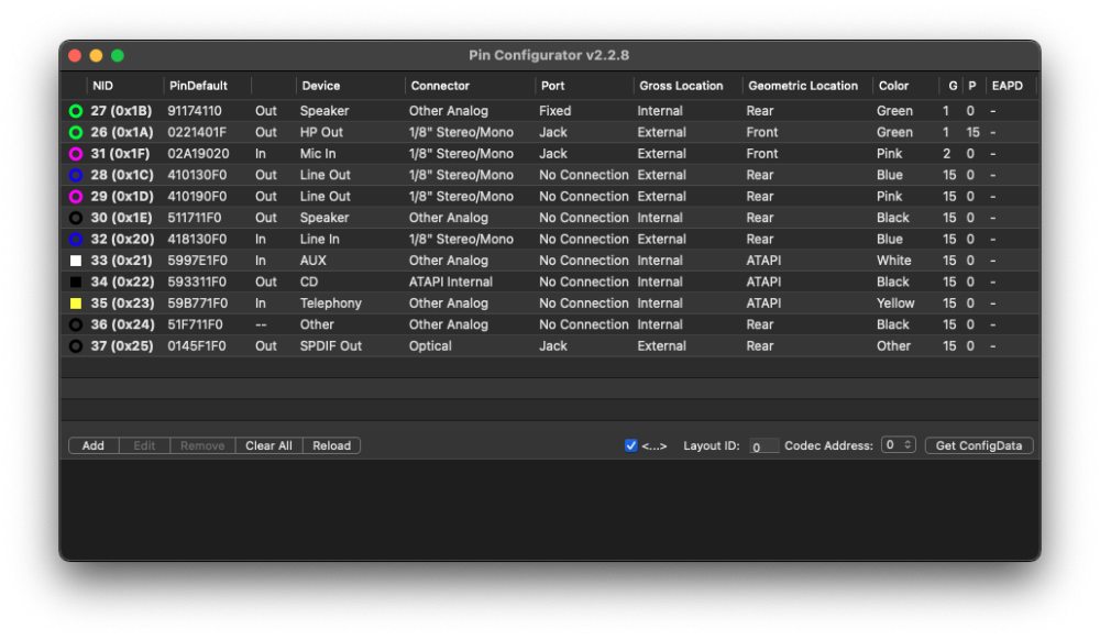

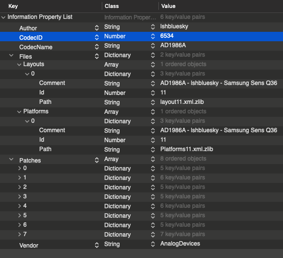

shl628 Posted December 18, 2023 Share Posted December 18, 2023 (edited) Hello. 🙂 I have a question about creating a new Layout ID in AppleALC. The laptop specifications and installed Mac OS X version are as follows.  Installed Mac OS X Versions Mac OS X Snow Leopard 10.6.8 OS X Mountain Lion 10.8.5 (NexPostFacto, 32Bit Kernel Patch, GMA950 QE/CI Enabled)  System Specification : Samsung Sens Q36 (NT-Q36CR0H) CPU : Intel Merom Core 2 Duo T5600 1.83 GHz Chipsets : Intel 945GM + ICH7-M Graphics : Intel GMA 950 Memory : DDR2 PC2-5300 667 MHz 512 MB + 2 GB Sound : Analog Devices SoundMAX AD1986A Ethernet : Broadcom 440x 10/100 Integrated Controller Wi-Fi : Intel PRO/Wireless 3945ABG Network Connection TouchPad : Synaptics PS/2 TouchPad BIOS : Phoenix FirstBIOS ™ Notebook Pro Version 2.0 26SD  Analog Devices SoundMAX AD1986A sound codec is not supported by AppleALC.kext So, I've only used VoodooHDA on this laptop so far.  However, I recently saw a commit from Goldfish64 on AppleALC's GitHub site that added new Layout ID support for the AD1884 sound codec. https://github.com/acidanthera/AppleALC/commit/1a5f6ff31db71678ddc55084350e23d713557694  I was impressed by this, so I also tried adding support for AD1986A and creating a new Layout ID. I referred to the site below for an explanation of AppleALC's new Layout ID creation guide. https://github.com/5T33Z0/AppleALC-Guides/tree/main/AppleALC_Layout-ID  I. Summary II. Preparations III. Extracting data from the Codec dump  I dumped the Analog Devices SoundMAX AD1986A sound codec on Linux. AD1986A-codec#0.txt   IV. Understanding the Codec schematic and signal flow  Here is a picture of the signal flow graph from the Sound Codec extracted in the steps above :  I created a Path Map in the graph above as follows. Node ID (Pin Complex) | Device Name/Type | Path(s) | EAPD 31 (In) | External Microphone | 6-18-17-15-31 | - 27 (Out) | Internal Speaker | 27-11-7-3 | - 26 (Out) | Headphone | 26-10-5 | -  Note: This laptop does not have a built-in microphone. Therefore, the only input device is an external pink microphone terminal.   V. Creating a PathMap VI. Creating a PlatformsXX.xml VII. Transferring the PathMap to PlatformsXX.xml  I copied the Info.plist, layout11.xml, and Platforms11.xml files of the AD1884 codec written by Goldfish64 in the AppleALC - Resources folder and modified these files. So, I modified Platforms11.xml with the PathMap created in the above step in Auto-Switching mode. The detailed structure of the PathMap I wrote and the contents of the Platforms11.xml file are as follows.    VIII. Adding/Modifying layoutXX.xml  Since I added a new Analog Devices SoundMAX AD1986A codec and created a new Layout ID for the first time, I imported and modified the Resource file of Layout ID=11 of the AD1884 sound codec created by Goldfish64.  Therefore, in layout11.xml, the value of 11 is used without modifying the LayoutID and PathMapID values, and instead, the CodecID is modified to 299112838, which corresponds to AD1986A. The remaining Inputs and Outputs items were also modified based on the PathMap contents written above.  The MuteGPIO value is as follows in the sound Codec Dump file. Node 0x0f [Audio Selector] wcaps 0x30010d: Stereo Amp-Out Control: name="Mic Boost Volume", index=0, device=0 ControlAmp: chs=3, dir=Out, idx=0, ofs=0 Amp-Out caps: ofs=0x00, nsteps=0x03, stepsize=0x27, mute=0 Amp-Out vals: [0x00 0x00] Connection: 8 0x1f* 0x20 0x1d 0x1d 0x27 0x28 0x29 0x2a Node 0x1f [Pin Complex] wcaps 0x400081: Stereo Pincap 0x00001727: IN Detect Trigger ImpSense Vref caps: HIZ 50 GRD 80 Pin Default 0x02a19020: [Jack] Mic at Ext Front Conn = 1/8, Color = Pink DefAssociation = 0x2, Sequence = 0x0 Pin-ctls: 0x24: IN VREF_80 Unsolicited: tag=02, enabled=1 If I calculate the MuteGPIO value as above, 0x50 + 0100 + 0x1F = 0x5001001F (Hex) => 1342242847 (Dec) Therefore, the MuteGPIO value was entered as 1342242847.   IX. Creating a PinConfig  The initial screen when the sound codec extracted in step III above is loaded in Pin Configurator is as follows :  This is what it looks like after selecting the Remove Disabled menu :  This is what it looks like after selecting the Verb Sanitize (All Options Enabled) menu : Here I deleted the unused Verb items. Also, the values for the Connector, Port, and Gross Location items of the external microphone changed strangely, so I corrected them again.  In this way, the final ConfigData obtained is as follows. 01B71C10 01B71D40 01B71E17 01B71F91 01F71C20 01F71D90 01F71EA1 01F71F01 01A71C30 01A71D40 01A71E21 01A71F01 verbs.txt   X. Integrating the PinConfig into the AppleALC source code In Info.plist in PinConfig.kext, I added a new AD1986A item and added the ConfigData I created and various information as appropriate. <dict> <key>AFGLowPowerState</key> <data> AwAAAA== </data> <key>Codec</key> <string>AD1986A - lshbluesky - Samsung Sens Q36</string> <key>CodecID</key> <integer>299112838</integer> <key>ConfigData</key> <data> AbccEAG3HUABtx4XAbcfkQH3HCAB9x2QAfceoQH3HwEBpxwwAacdQAGnHiEBpx8B </data> <key>FuncGroup</key> <integer>1</integer> <key>LayoutID</key> <integer>11</integer> </dict>   XI. Add Platforms.xml and layout.xml to info.plist Open the Info.plist file in the AppleALC - Resources - AD1986A folder and edit items such as CodecID, Layouts, and Platforms.  Note: I don't know how to modify the Patches Array item, so I left it as written in Goldfish64's AD1884 file.   XII. Compiling the AppleALC.kext Finally, I built AppleALC myself, adding and modifying the AD1986A sound codec. And, I tried loading AppleALC on my Samsung Sens Q36 laptop. However, in the sound section of system preferences, nothing is visible in the output devices and input devices, and there is no sound. 😥 Is there anything wrong or missing in my work? Please help and advise. 🥲  Additionally, the Resources file I added and modified to AppleALC is attached below. AppleALC-Resources-AD1986A-shl.zip Edited December 20, 2023 by shl628 Link to comment https://www.insanelymac.com/forum/topic/358277-help-questions-about-ad1986a-codec-and-new-layout-id-creation-in-applealc/ Share on other sites More sharing options...

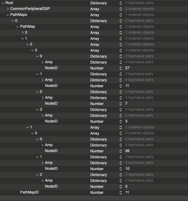

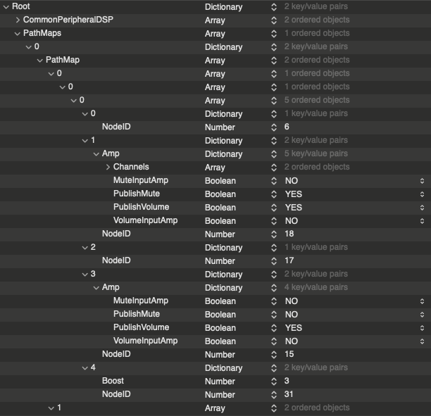

shl628 Posted December 19, 2023 Author Share Posted December 19, 2023 Question 1. In the Inputs section of each PlatformsXX.aml file, some codecs have the Amp item in the first node, while others have it in the last node. Does the Amp location matter? Â Question 2. Is it necessary to modify the value of the SignalProcessing item in the AppleALC - Resources - Codec - Info.plist file? Â Question 3. AppleALC's Layout ID list table specifies the minimum supported kernel version. Is there a file that specifies this value? Â Additionally, I also upload the Clover (Ver r5119) EFI folder that I am using on this laptop. EFI-Sens-Q36-AppleALC-shl.zip Link to comment https://www.insanelymac.com/forum/topic/358277-help-questions-about-ad1986a-codec-and-new-layout-id-creation-in-applealc/#findComment-2814683 Share on other sites More sharing options...

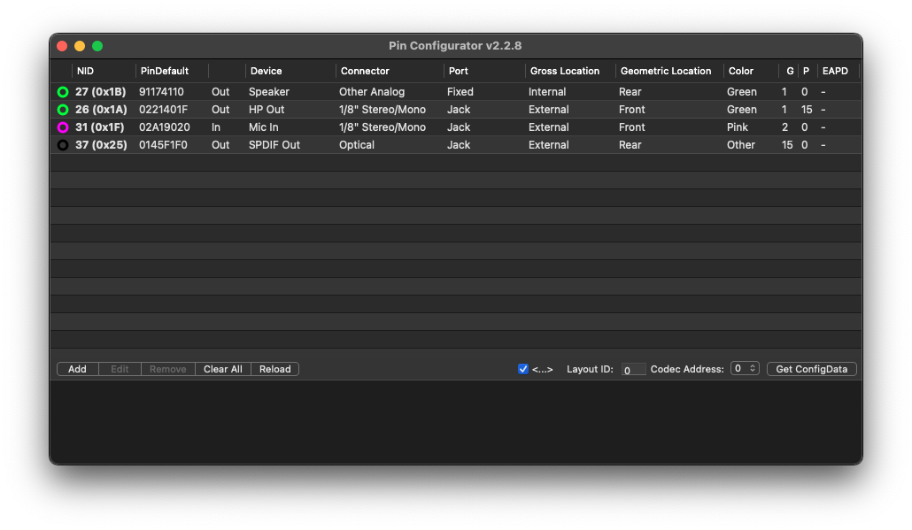

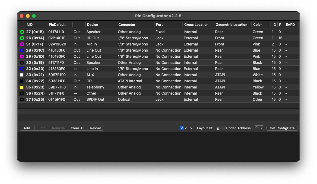

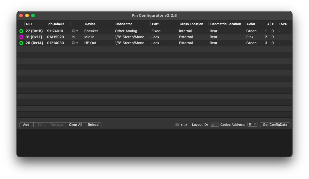

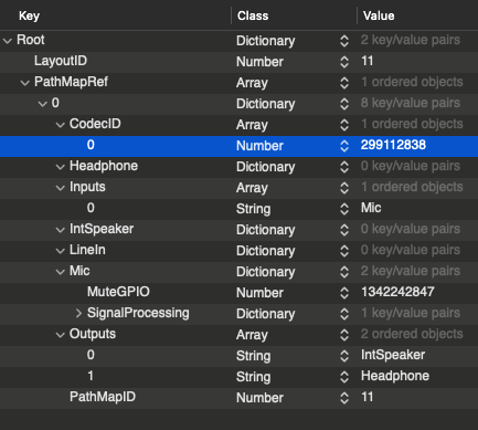

shl628 Posted January 9, 2024 Author Share Posted January 9, 2024 (edited) The PathMap and PinConfig that I newly created are as follows. Â - 1st attempt Node ID (Pin Complex) | Device Name/Type | Path(s) | EAPD 31 (In) | External Microphone | 6-18-17-15-31 | - 27 (Out) | Internal Speaker | 27-11-4Â | - 26 (Out) | Headphone | 26-10-5 | - - 2nd attempt Node ID (Pin Complex) | Device Name/Type | Path(s) | EAPD 31 (In) | External Microphone | 6-18-17-15-31 | - 27 (Out) | Internal Speaker | 27-11-4Â | - 26 (Out) | Headphone | 26-10-4Â | - Â The difference from the PinConfig I first created is that in PinConfigurator, I only used the Remove Disabled and Verb Sanitize (All Options Enabled) options and only removed unused SPDIF items. Verbs-AD1986A.txt AppleALC Debug Logs.txt Edited January 9, 2024 by shl628 Link to comment https://www.insanelymac.com/forum/topic/358277-help-questions-about-ad1986a-codec-and-new-layout-id-creation-in-applealc/#findComment-2815336 Share on other sites More sharing options...
