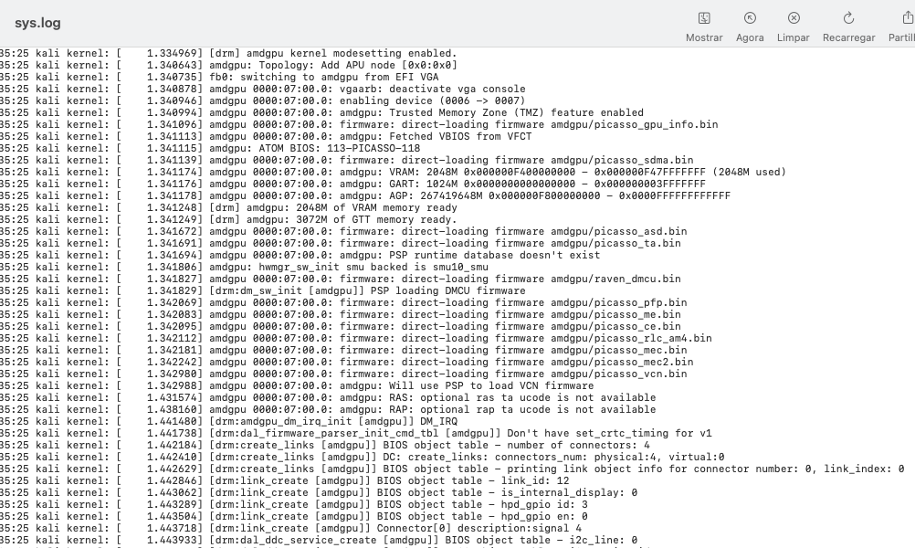

jalavoui Posted December 7, 2023 Share Posted December 7, 2023 (edited) getting gpu logs from linux requires a special boot flag grub.efi sample config set timeout=0 menuentry "Ubuntu" { set gfxpayload=keep search --no-floppy --fs-uuid --set=root 60c989ee-b27b-420d-8a17-b541c2605fb3 linux /vmlinuz root=UUID=60c989ee-b27b-420d-8a17-b541c2605fb3 ro quiet splash drm.debug=0x14 initrd /initrd.img } Edited December 7, 2023 by jalavoui Link to comment Share on other sites More sharing options...
ArcaneRhapsody Posted December 8, 2023 Share Posted December 8, 2023 I'd like to add that enabling verbose logging can produce a lot of data, so ensure you have a way to sift through the logs effectively. Tools like 'grep' are really invaluable for filtering through the noise to find the relevant information. Link to comment Share on other sites More sharing options...
jalavoui Posted December 11, 2023 Author Share Posted December 11, 2023 yes best way is get /var/log/syslog file depending on the flags you get lots of log lines idk where to find those debug flags Link to comment Share on other sites More sharing options...
