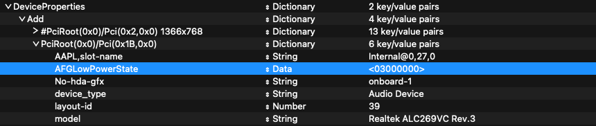

cankiulascmnfye Posted November 19, 2023 Share Posted November 19, 2023 @darthsian You could try to inject `AFGLowPowerState` (value 01 or 03) into your Audio Device via DeviceProperties and see if it makes a differenc (PCI path might differ on your machine): 1 Link to comment https://www.insanelymac.com/forum/topic/358085-sonoma-audio-low-power-mode-problem/#findComment-2813675 Share on other sites More sharing options...
darthsian Posted November 19, 2023 Author Share Posted November 19, 2023 (edited) 5 hours ago, cankiulascmnfye said: @darthsian You could try to inject `AFGLowPowerState` (value 01 or 03) into your Audio Device via DeviceProperties and see if it makes a differenc (PCI path might differ on your machine): Thanks for suggestion, but I try this before and it won't work. In the meantime, I modified @mattsday antipop script and it works. Edited November 19, 2023 by darthsian Link to comment https://www.insanelymac.com/forum/topic/358085-sonoma-audio-low-power-mode-problem/#findComment-2813677 Share on other sites More sharing options...
