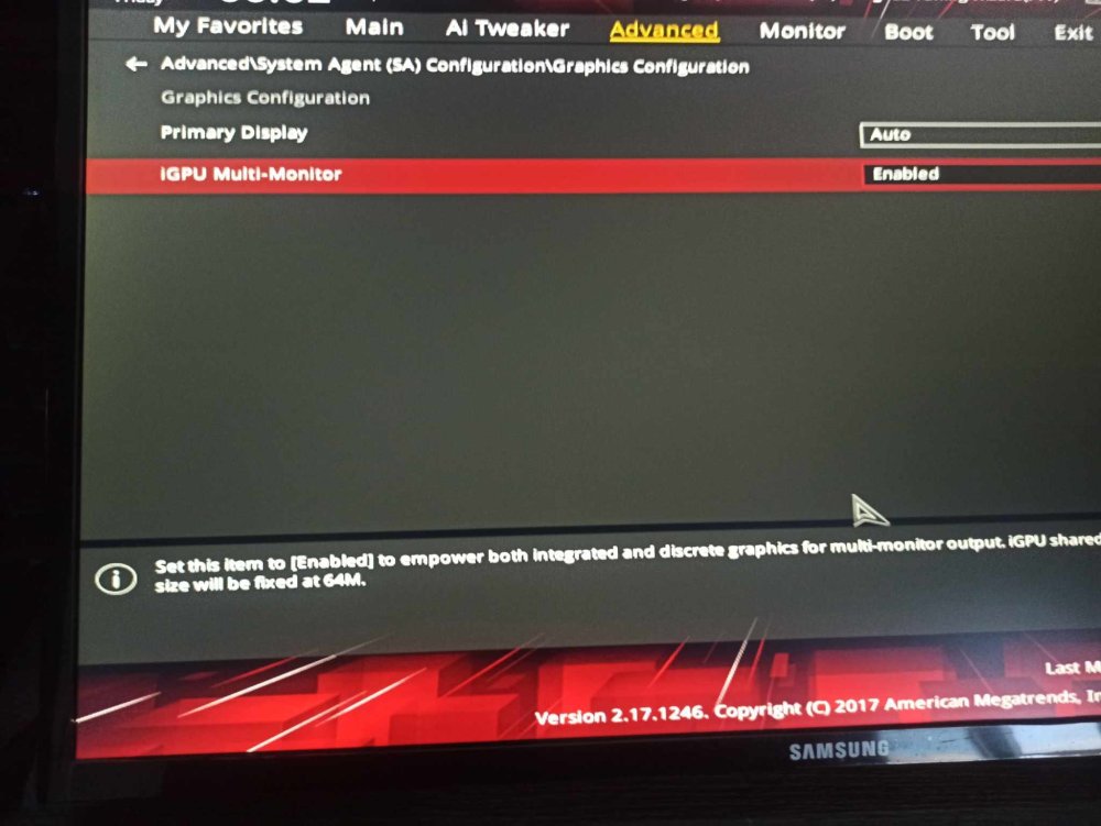

Montelli Posted October 22, 2023 Author Share Posted October 22, 2023 (edited) I noticed that iGPU multi monitor was disabled in the bios and now I have enabled it: but unfortunately the third display screen is all green, why? Edited October 22, 2023 by Montelli Link to comment https://www.insanelymac.com/forum/topic/357880-help-how-can-i-activate-integrated-hdmi-gpu/#findComment-2812691 Share on other sites More sharing options...
