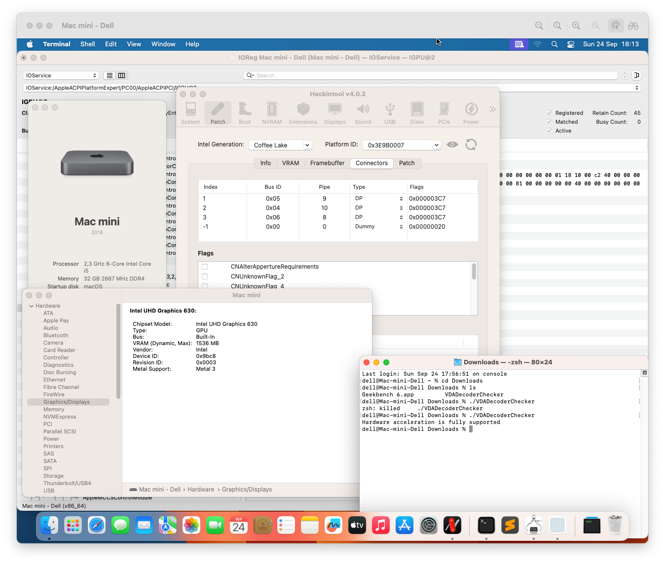

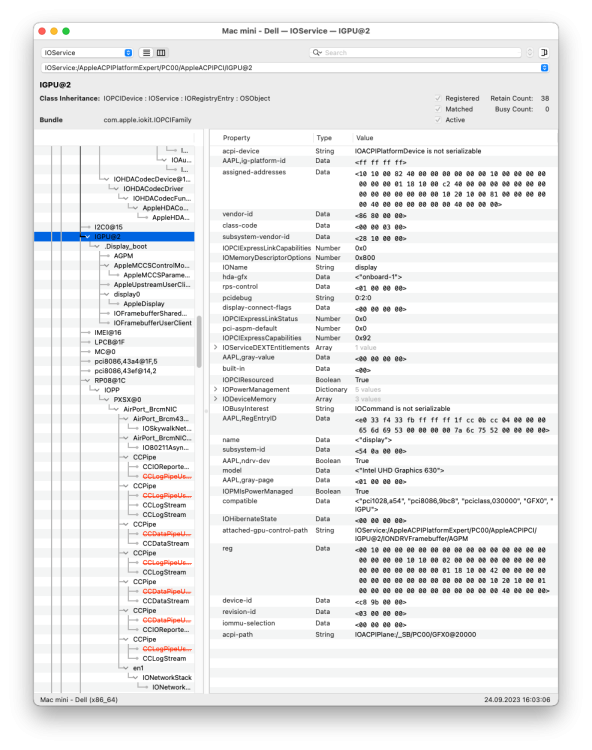

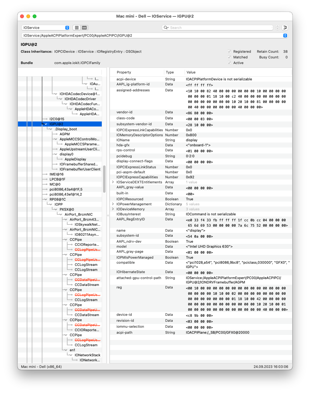

Hello everyone, I do not know what I can todo else to get video working video output on subject machine. The strange thing is that I see fully working GPU acceleraion when connected via VNC but in this case none of two DP ports provide video signal.
What are your thoughts on what could be wrong here?
What I tried todo:
1. Busid bruteforce for all connectors, no luck
2. `igfxonln=1` – nope
3. Changing monitors, no way

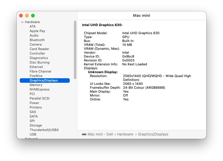

But if I boot with `-igfxvesa` (i.e. disabled GPU acceleration) my display is connected
Spoiler
image.thumb.png.0bd2da0ce3a43c0cb994a7b78bc6024b.pngimage.png.de0e06c90f6d63e2726cf7cbe8fa403e.png
