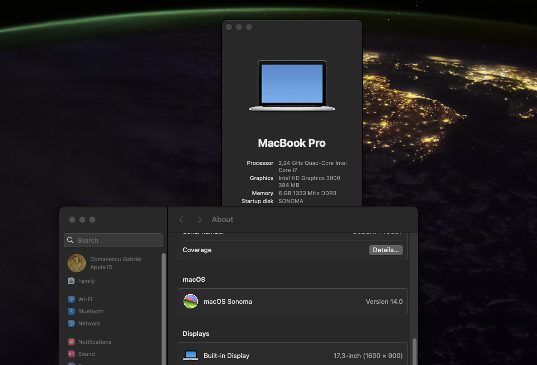

ovidoi Posted October 9, 2023 Share Posted October 9, 2023 Thank you verdazil, it works, yeahhh, now boot from stick usb opencore because this laptop boot uefi only usb port, not from hdd/ssd, now my work is converting occonfig to clover config because need to spoof and install dgpu radeon, in opencore i don't know how, i hope to fix this, now install only intel hd3000 with oclp. Working fast then ventura. Link to comment Share on other sites More sharing options...
ovidoi Posted October 13, 2023 Share Posted October 13, 2023 (edited) Hello, I finally managed to install Sonoma and configure booting with clover as well as booting with opencore stick. The functions of the keyboard FN + 123.....key work correctly, the audio video sliders work ok. I salute those who helped me. I still can't install dgpu Radeon hd 6850m with oclp, although in the description it says that terrascale2 works for macbook pro 8.2 and 8.3. When I want to boot from the dgpu and it gets to loading the display, the system restarts, does anyone have any ideas? Edited October 13, 2023 by ovidoi Link to comment Share on other sites More sharing options...

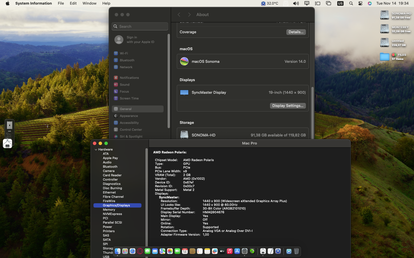

ovidoi Posted November 13, 2023 Share Posted November 13, 2023 Hi verdazil, I managed to install Sonoma 14.0 on my old signature desktop and faced a problem related to the rx550 video card, meaning that when the apple appears and wants to enter the desktop, it remains black. I used the same settings as in Monterey, which burns very well, but in Sonoma it remains black. I made a spoof on the video card id 0x67FF1002 with Baffin framebuffer, I repeat in mojave and monterey it works without problems without any patch, only configuration from Clover, please advise in some way, thank you. Link to comment Share on other sites More sharing options...
verdazil Posted November 14, 2023 Author Share Posted November 14, 2023 @ovidoi, You can boot with bootrarg -x, and then the newest OCLP version may solve the problem. Link to comment Share on other sites More sharing options...
HmO Posted November 14, 2023 Share Posted November 14, 2023 @ovidoi There is no need to load with -x, you need to add boot-arg -amd_no_dgpu_accel, and after the OCLP patch, remove boot-arg before rebooting. 1 Link to comment Share on other sites More sharing options...
cankiulascmnfye Posted November 14, 2023 Share Posted November 14, 2023 Necessary EFI and Config adjustments for 1st Gen Intel Core CPUs running macOS 13+: https://github.com/5T33Z0/OC-Little-Translated/blob/main/14_OCLP_Wintel/Nehalem-Westmere_Ventura.md#config-edits 1 Link to comment Share on other sites More sharing options...
ovidoi Posted November 14, 2023 Share Posted November 14, 2023 (edited) @verdazil, @HmO, @cankiulascmnfye thank you, thank you, thank you my friends, now i have installed Sonoma on my old coputer full working and fast L.E. work with -x and Amfipass.kext and OCLP. Edited November 14, 2023 by ovidoi Link to comment Share on other sites More sharing options...
