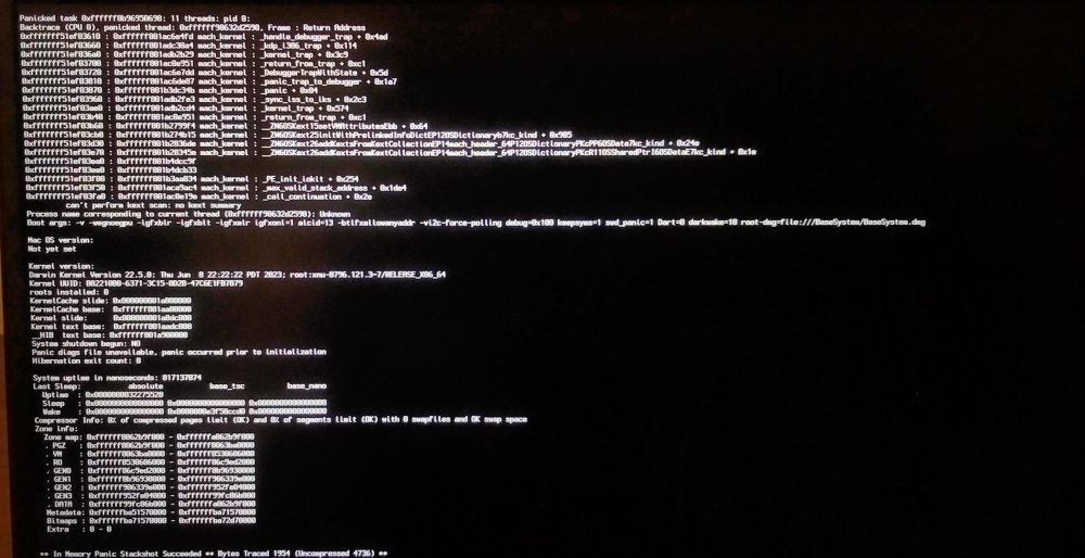

Xflash2006 Posted September 13, 2023 Share Posted September 13, 2023 Hi, I have a problem. When I try to start the macOS installer it goes into kernel panic. How can I resolve it? My EFI Link to comment https://www.insanelymac.com/forum/topic/357623-lenovo-ideapad-15iml05-kernel-panic-cant-perform-kext-scan-no-kext-summary/ Share on other sites More sharing options...

Xflash2006 Posted September 14, 2023 Author Share Posted September 14, 2023 (edited) Previously Opencore also works, but after adding 2 kext (SATA-unsupported and CtlnaAHCIPort) to support the sata cable it goes into kernel panic. Edited September 14, 2023 by Xflash2006 Link to comment https://www.insanelymac.com/forum/topic/357623-lenovo-ideapad-15iml05-kernel-panic-cant-perform-kext-scan-no-kext-summary/#findComment-2811136 Share on other sites More sharing options...

Xflash2006 Posted September 14, 2023 Author Share Posted September 14, 2023 If I remove CtlnaAHCIPort.kext it no longer goes into kernel panic and the storage device connected to the sata cable is detected. Link to comment https://www.insanelymac.com/forum/topic/357623-lenovo-ideapad-15iml05-kernel-panic-cant-perform-kext-scan-no-kext-summary/#findComment-2811141 Share on other sites More sharing options...
