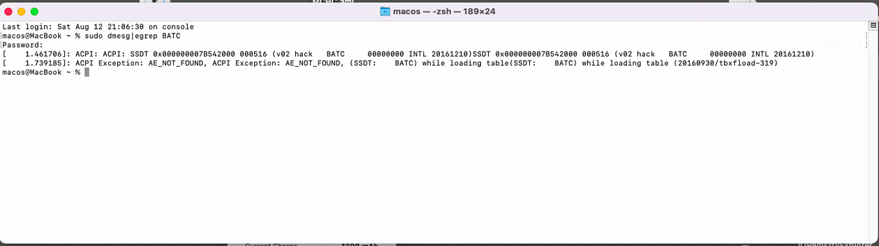

hoaug Posted August 10, 2023 Share Posted August 10, 2023 (edited) Hello everyone. i just hackedintosh on my Lenovo T470S. Everything works perfectly except my Battery. it doesn't work. Lenovo Thinkpad T470s Processor and Chipset: Intel Core i5 6300u / Intel Skylake 100 series chipset Graphics: Intel HD 520 Storage: SN530 RAM: 12 GB DDR4 1 x Synaptics SMBUS Trackpad + Trackpoint 1 x PS/2 Keyboard 1 x USB 3.0 card reader 3 x USB 3.0 type a ports 1 x TB3/USB C port 1 x HDMI port 1 x 3.5mm mic/headphone jack I have researched and learned that my Laptop has 2 batteries and I have learned a bit of ACPI code and patched SSDT-BATC. I use SSDT-BATC included with ECEnabler.kext and Battery works I thought everything was fine but no. I realized that my battery is only taking half its capacity. My battery as far as I know it has ~4k4 mAh but the macos side only receives ~2k mAh. I have searched and patched a lot but the number still only stops at ~2kmAh (sometimes down to 1k7). With such a battery capacity, I cannot use it without a charger. help me please. Thank you very much Here are the SSDTs I use. DSDT.amlSSDT-BATC.amlSSDT-BATT.amlSSDT-BATS.aml And here are my EFI: https://drive.google.com/file/d/1kGc-jP1iGVGp8WX4TIJWuX80VHp4e-BV/view?usp=sharing Edited August 14, 2023 by kinhhoang161 update information Quote Link to comment https://www.insanelymac.com/forum/topic/357414-not-solved-but-i-gave-up-lenovo-t470s-battery-patch-help/ Share on other sites More sharing options...

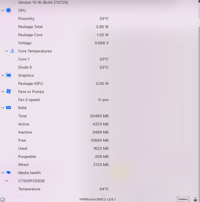

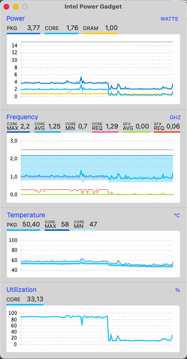

Slice Posted August 10, 2023 Share Posted August 10, 2023 5 hours ago, kinhhoang161 said: thank you. but my device when using battery drain at a terrible speed. Look to your speedstep. Is it working or CPU frequency stay at maximum? Test with HWMonitorSMC2 Quote Link to comment https://www.insanelymac.com/forum/topic/357414-not-solved-but-i-gave-up-lenovo-t470s-battery-patch-help/#findComment-2810041 Share on other sites More sharing options...
hoaug Posted August 11, 2023 Author Share Posted August 11, 2023 My hwmonitorsmc2 show that. does its OK? my HW Quote Link to comment https://www.insanelymac.com/forum/topic/357414-not-solved-but-i-gave-up-lenovo-t470s-battery-patch-help/#findComment-2810096 Share on other sites More sharing options...
hoaug Posted August 11, 2023 Author Share Posted August 11, 2023 @Slice I have checked the frequency of the CPU, it works normally (not high) but I watch youtube for only 30 minutes and the battery runs out. this is definitely due to my dualbattery...but i cant patch it..don't know where is wrong.. Quote Link to comment https://www.insanelymac.com/forum/topic/357414-not-solved-but-i-gave-up-lenovo-t470s-battery-patch-help/#findComment-2810103 Share on other sites More sharing options...

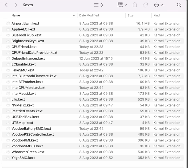

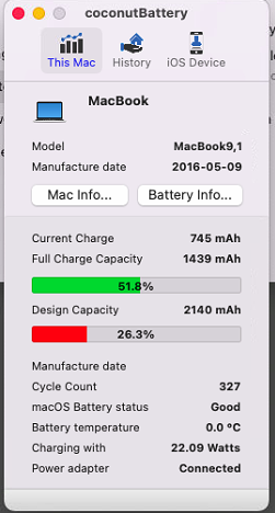

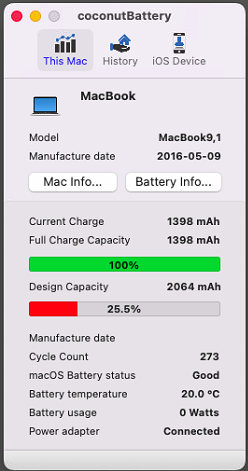

hoaug Posted August 11, 2023 Author Share Posted August 11, 2023 (edited) 1 hour ago, Slice said: Battery is not controlled by macOS at least on Hackintosh. It is just a source of energy. Can you watch youtube in WIndows more then 30 minute? I may propose to use my set on sensors including CPU sensor and the battery sensors. My version controls two batteries. The link is in my signature. Remove VirtualSMC with all plugins and install my FakeSMC with IntelCpuMonitor, SMIMonitor (it si intended for Dell specifically), VoodooBatterySMC. I can't watch youtube (1920x1080) more than 30p, only about ~30p my laptop is out of battery.... i also used kext CPUFriend + CPUFriendFriend (with 800mhz ) but still the same... i will try remove VirtualSMC and use yourr kextMY BATTERY INFORMATION: Edited August 11, 2023 by kinhhoang161 Quote Link to comment https://www.insanelymac.com/forum/topic/357414-not-solved-but-i-gave-up-lenovo-t470s-battery-patch-help/#findComment-2810111 Share on other sites More sharing options...

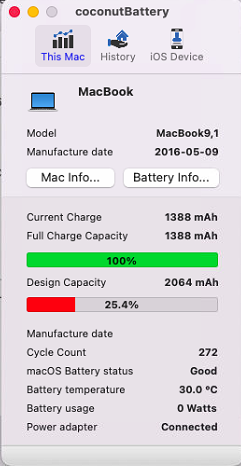

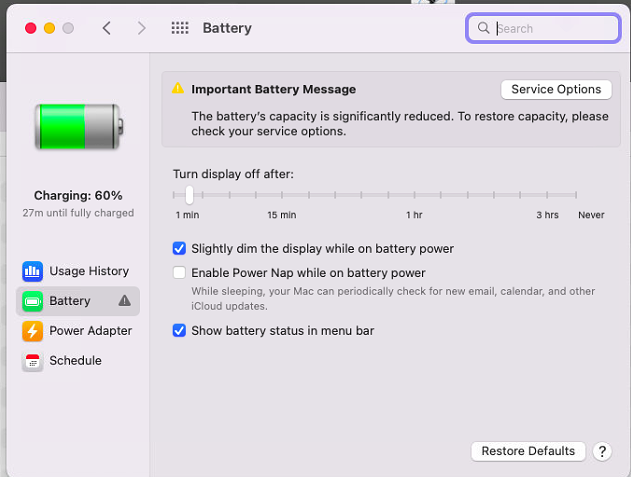

hoaug Posted August 11, 2023 Author Share Posted August 11, 2023 @Slice so sad. with your kext FakeSMC + IntelCpuMonitor + VoodooBatterySMC my battery reduce a little capacity than past..... and now it also have a battery messages in battery setting Quote Link to comment https://www.insanelymac.com/forum/topic/357414-not-solved-but-i-gave-up-lenovo-t470s-battery-patch-help/#findComment-2810113 Share on other sites More sharing options...
