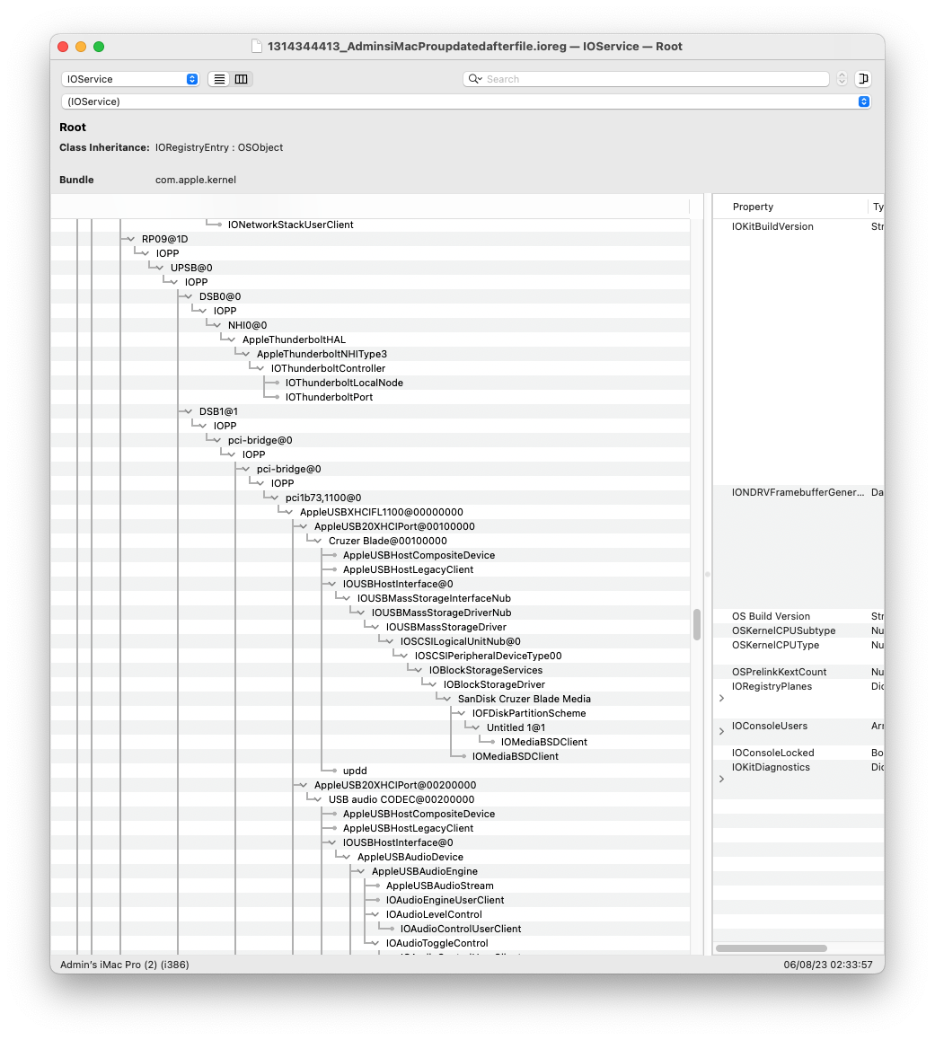

309bubub Posted August 6, 2023 Author Share Posted August 6, 2023 (edited) I tried yours, thunderbolt only work in Mac after boot into windows ( and no hot swap is there something I'm doing wrong ? 1. I removed old thunderbolt .aml file, placed yours into ACPI folder ... 2.cut old and added yours into OpenCore configurator 3 saved OC configurator restart computer 4. reset nvram this is up dated IOReg after insert your file 1314344413_AdminsiMacProupdatedafterfile.ioreg Edited August 6, 2023 by 309bubub Quote Link to comment https://www.insanelymac.com/forum/topic/357330-z690-ud-titan-ridge-hot-swap-please-help/#findComment-2809732 Share on other sites More sharing options...

MaLd0n Posted August 6, 2023 Share Posted August 6, 2023 last ssdt for tbh is correct Quote Link to comment https://www.insanelymac.com/forum/topic/357330-z690-ud-titan-ridge-hot-swap-please-help/#findComment-2809737 Share on other sites More sharing options...
309bubub Posted August 6, 2023 Author Share Posted August 6, 2023 Then what could I be doing wrong? hot swap still not working Quote Link to comment https://www.insanelymac.com/forum/topic/357330-z690-ud-titan-ridge-hot-swap-please-help/#findComment-2809738 Share on other sites More sharing options...
Slice Posted August 7, 2023 Share Posted August 7, 2023 AFAIK hot swap on TB never worked in macOS because macOS in not plug&play system. If I am wrong tell me why. Quote Link to comment https://www.insanelymac.com/forum/topic/357330-z690-ud-titan-ridge-hot-swap-please-help/#findComment-2809757 Share on other sites More sharing options...
