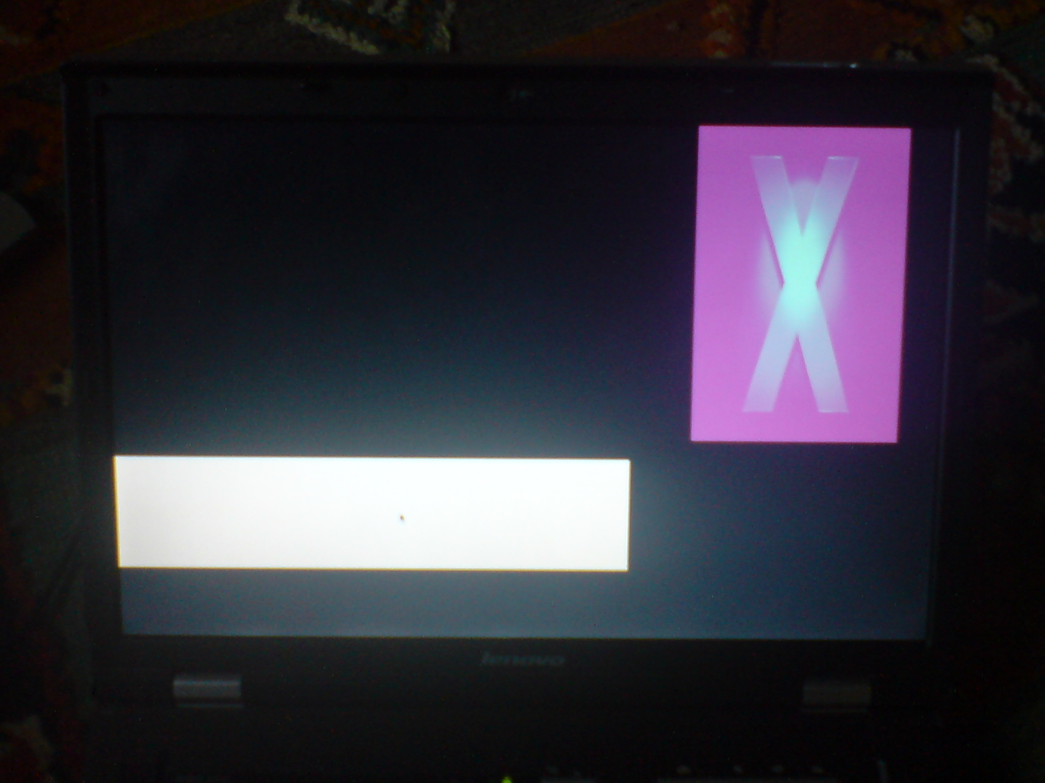

I loved your picture because I have the same problem!
I can boot with -x (safe mode) and video goes perfect at 1280x768.
I installed gma950 extension (10.4.7 jas) but nothing, tryed to change resolution editing com.apple.Boot.plist, but nothing.
Did you solved it?
Hi, i have exactly the same problem as you. i can only run in safe mode. we seem to have similar hardware. does your audio work? if so how did you get it to? when i run in safe mode i have no graphics driver though, therefore i can not watch videos or run screensavers smoothly
any help greatly apreciated.
cheers
Listen:
I've moved (or delete) all Intel .kext from /System/Library/Extension to a backup folders, removed Extensions.kextcache and Extension.mkext and now it boots OK (normal mode)
Then reinstaled GMA950 support from JAS 10.4.7 DVD and now have Core Image and Quartz Extreme Supported Great!
