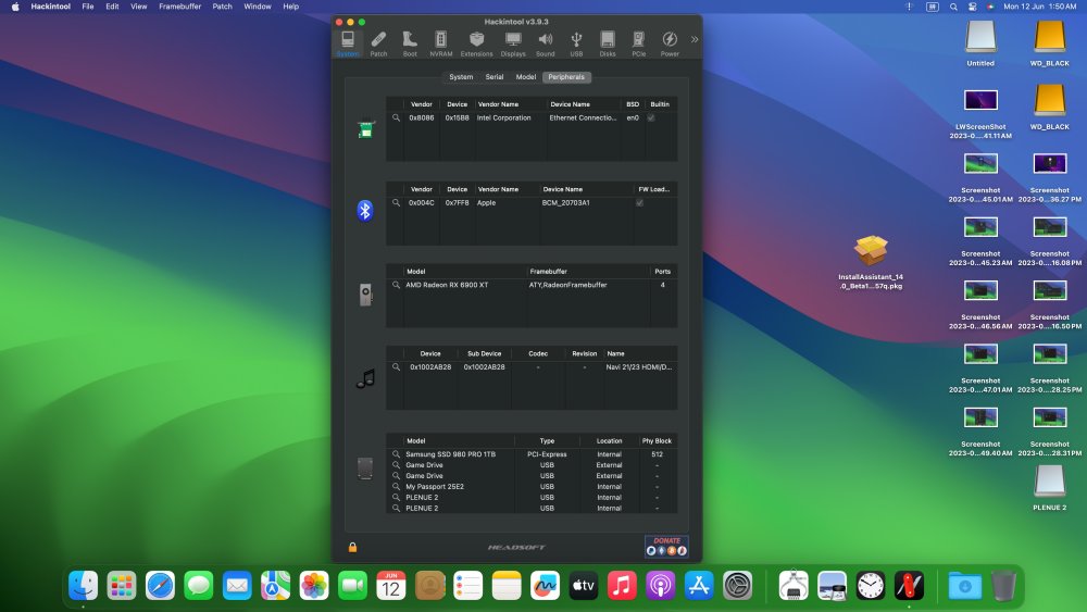

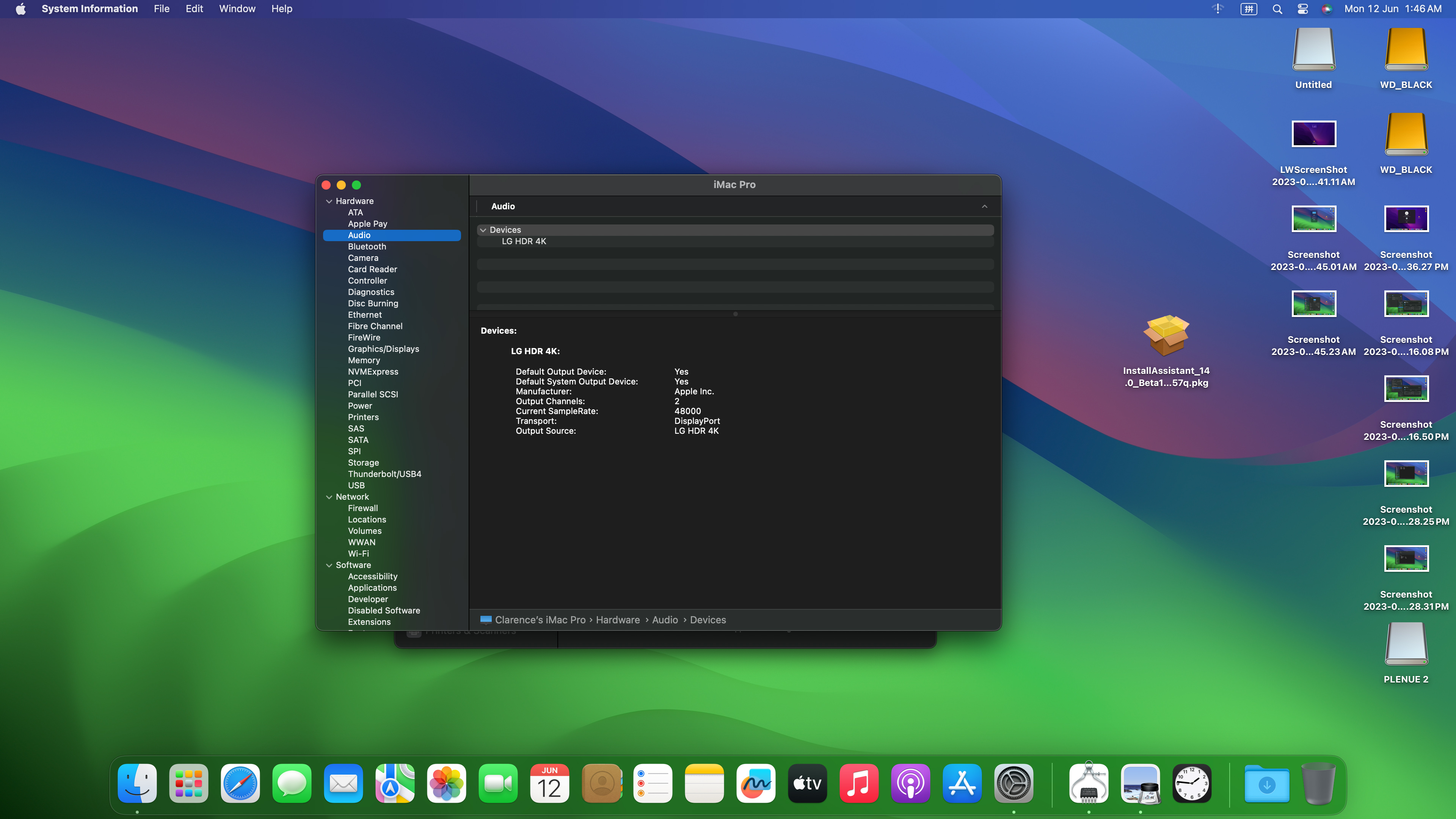

HurricaneX Posted June 12, 2023 Share Posted June 12, 2023 Hey,guys!!Sound and Bluetooth not working after upgrade to Sonoma,any suggestions?Thanks in advance!! Processor: Intel Core i9-7900X @3.30 GHzMotherboard: Asus TUF X299 MARK 2 (BIOS Ver. 2002)GPU: AMD Radeon RX 6900 XT 16 GB ToxicRAM: 96 GB 3200 MHz DDR4 SSD:Samsung 980 PRO NVME 1T/ Samsung SATA 3.0 870 QVO 1T / Samsung 870 EVO 500GAudio: Realtek ALCS 1220A 8-Channel Audio CODEC. Network/WiFi+Bluebooth: Intel I219V + BCM943602CS 1 Link to comment https://www.insanelymac.com/forum/topic/356934-sound-and-bluetooth-not-working-after-upgrade-to-sonoma-beta/ Share on other sites More sharing options...

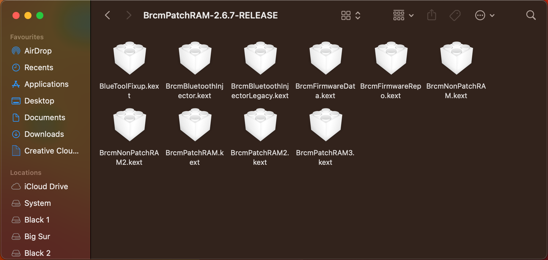

HurricaneX Posted June 22, 2023 Author Share Posted June 22, 2023 On 6/21/2023 at 4:19 AM, cankiulascmnfye said: @HurricaneX - Broadcom Wifi won't work currently… discussed to death in the Sonoma thread - Bluetooth requires lates Bluetool Fixup kex inclued in BrcmPatchRAM All these kexts r required?? Link to comment https://www.insanelymac.com/forum/topic/356934-sound-and-bluetooth-not-working-after-upgrade-to-sonoma-beta/#findComment-2807055 Share on other sites More sharing options...
Max.1974 Posted June 29, 2023 Share Posted June 29, 2023 On 6/22/2023 at 1:38 PM, HurricaneX said: All these kexts r required?? You need read a topic and put only kexts that your system required: https://github.com/acidanthera/BrcmPatchRAM Installation Note if you have an Apple MacBook/iMac/Mac Pro etc, follow the Mac instructions Install one of BrcmPatchRAM.kext or BrcmPatchRAM2.kext or BrcmPatchRAM3.kext depending on macOS version, never both. BrcmPatchRAM.kext: for 10.10 or earlier. BrcmPatchRAM2.kext: for 10.11 - 10.14. BrcmPatchRAM3.kext: for 10.15 or later. Also, install one firmware kext BrcmFirmwareData.kext or BrcmFirmwareRepo.kext, depending on installation location, never both. BrcmFirmwareData.kext: Most appropriate for bootloader injection. This is the preferred configuration. BrcmFirmwareRepo.kext: Install to /System/Library/Extensions (/Library/Extensions on 10.11 and later). This kext is slightly more memory efficient than BrcmFirmwareData.kext, but cannot be injected by a bootloader. Advanced users: For custom firmware injectors, install the injector plus BrcmFirmwareRepo.kext. This works from either /S/L/E or through bootloader injection. Optionally, you may remove all the firmwares from BrcmFirmwareRepo.kext/Contents/Resources. If you're using the injector through the bootloader, the IOProviderClass in the Info.plist for BrcmFirmwareRepo.kext must be changed from "disabled_IOResources" to "IOResources". Keep in mind that BrcmPatchRAM3.kext also requires BrcmBluetoothInjector.kext to be installed. Starting with macOS 10.15, this is the only supported configuration because due to framework changes BrcmPatchRAM.kext and BrcmPatchRAM2.kext are incompatible with macOS 10.15. In case you forget to install BrcmBluetoothInjector.kext, Bluetooth will appear to be available but it won't work at all. Also, if you have a non-PatchRAM device (or you're not sure), install one of BrcmNonPatchRAM.kext or BrcmNonPatchRAM2.kext, depending on macOS version, never both. Although these kexts do not install any firmware (these devices have firmware built-in), they still depend on BrcmPatchRAM/BrcmPatchRAM2.kext. BrcmNonPatchRAM.kext: for 10.10 or earlier BrcmNonPatchRAM2.kext: for 10.11 or later. BrcmBluetoothInjector.kext To be used for macOS 10.11-11. Use BrcmBluetoothInjectorLegacy.kext for older systems. Using BrcmPatchRAM3.kext also requires BrcmBluetoothInjector.kext as changes in macOS Catalina (10.15) requires the use of a separate injector kext. This is due to the removal of the following IOCatalogue methods: IOCatalogue::addDrivers, IOCatalogue::removeDrivers and IOCatalogue::startMatching Consequently to have the native BT driver load for the device (BroadcomBluetoothHostControllerUSBTransport) we inject using a plist with a slightly lower IOProbeScore than BrcmPatchRAM3 so it doesn't probe before the firmware upload. The BrcmBluetoothInjector.kext is a codeless kernel extension which injects the BT hardware data using a plist; it does not contain a firmware uploader. You might also want to try this kext if you wish to see if your device will work without a firmware uploader. Do not use BrcmPatchRAM or BrcmPatchRAM2 with this kext. 1 Link to comment https://www.insanelymac.com/forum/topic/356934-sound-and-bluetooth-not-working-after-upgrade-to-sonoma-beta/#findComment-2807504 Share on other sites More sharing options...
