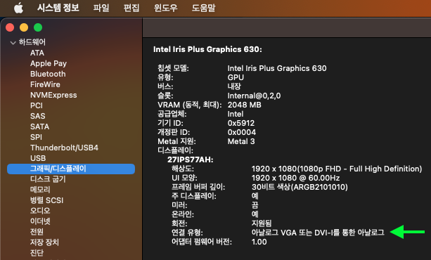

shl628 Posted May 16, 2023 Share Posted May 16, 2023 (edited) On 5/14/2023 at 11:22 PM, Mahant Verma said: I am trying to boot Catalina on vga display but getting black screen after verbose Try using igfxagdc=0 boot arg. I'm using an Intel HD 630 iGPU with QE/CI acceleration enabled with VGA output. Note, do not apply connector patches separately in Framebuffer, but leave the default DP(00040000) type. Edited May 16, 2023 by shl628 Quote Link to comment https://www.insanelymac.com/forum/topic/356708-catalina-on-vga/#findComment-2804671 Share on other sites More sharing options...
