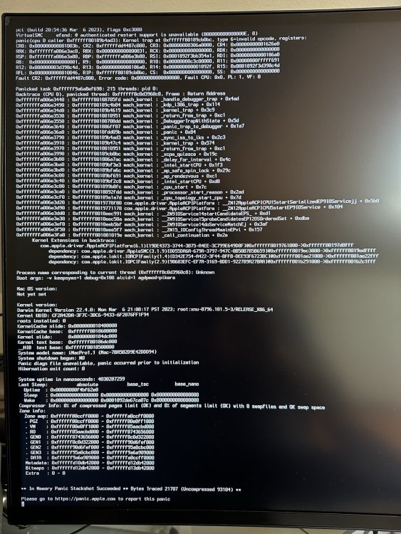

Jener Posted May 3, 2023 Share Posted May 3, 2023 Hello Everyone, I'm trying to get Ventura installed on my PC via Opencore but can't figure out how to solve a Panic issue. I've followed the Dortania guide at https://dortania.github.io/OpenCore-Install-Guide/config-HEDT/haswell-e.html for my Haswell-EP CPU. My config is: Motherboard: ASUS Z10PE-D8 WS CPU1: Intel Xeon E5-2697 v3 CPU2: Intel Xeon E5-2697 v3 Audio: Internal Realtek ALC1150 LAN: Internal Intel I210 I'm attaching the OpenCore EFI and Log as well as a screen shot of the boot panic. Appreciate any help. opencore-2023-05-03-111737.txt EFI.zip Link to comment https://www.insanelymac.com/forum/topic/356590-opencore-091-on-asus-z10pe-d8-ws-ventura-install/ Share on other sites More sharing options...

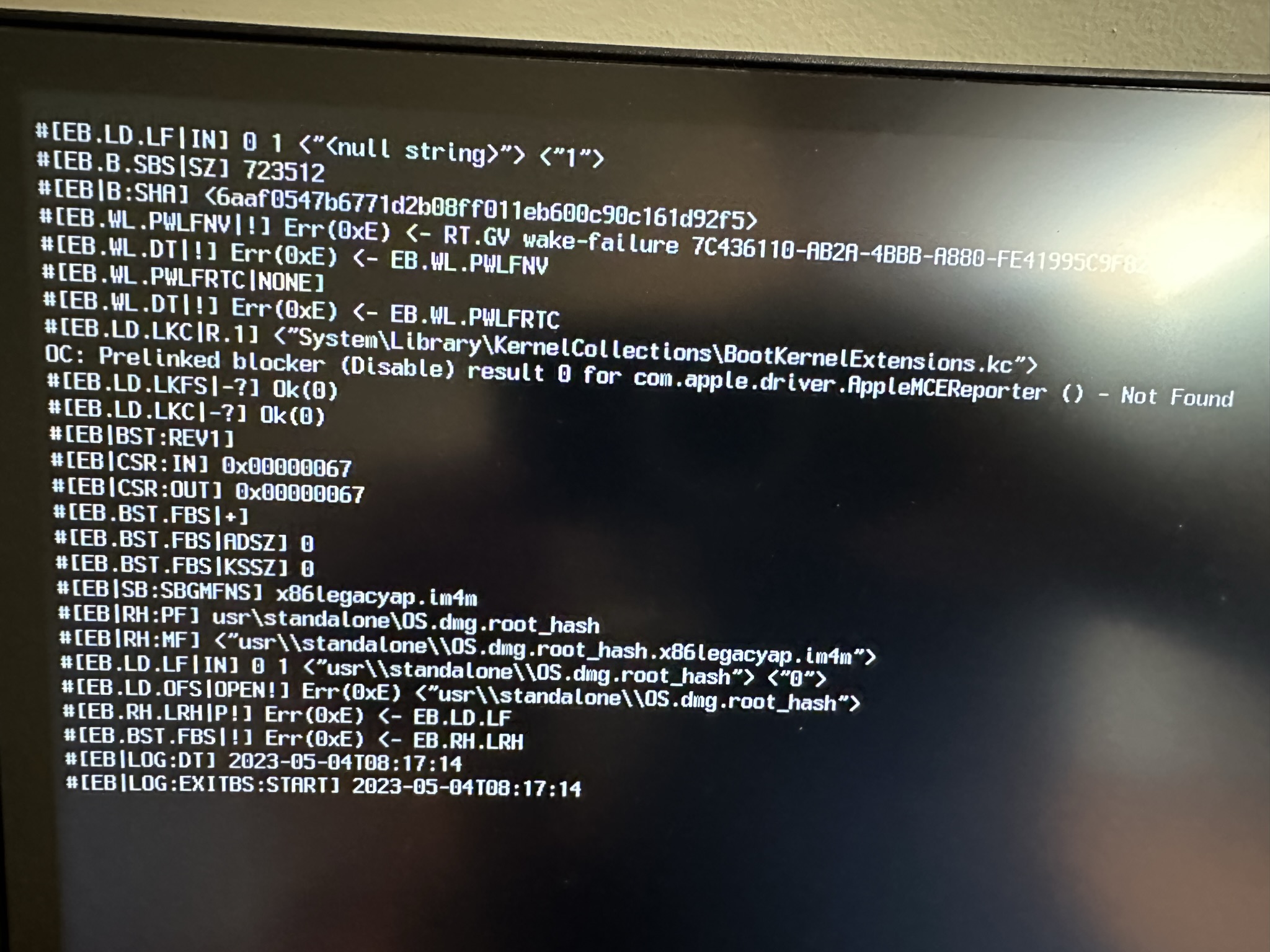

Jener Posted May 4, 2023 Author Share Posted May 4, 2023 eSaF, Your last EFI did not work at all, OpenCore freezes. 😢 Ellybz, I did change some settings in the Bios, however it does not have Speedstep or MSR/CFG options. Here is the Bios manual for my motherboard: https://www.manualowl.com/m/Asus/Z10PE-D8-WS/Manual/466430?page=77#manual Link to comment https://www.insanelymac.com/forum/topic/356590-opencore-091-on-asus-z10pe-d8-ws-ventura-install/#findComment-2804294 Share on other sites More sharing options...

Slice Posted May 5, 2023 Share Posted May 5, 2023 @Jener I also had problems with Xeon CPU on my comp#3. Three things you should do 1. Edit DSDT to correct number of CPU cores. Usually it contains much more than macOS can eat. 2. Use VoodooTscSync.kext 3. Choose right set of Quirks. One of them is TscSyncTimeout. Link to comment https://www.insanelymac.com/forum/topic/356590-opencore-091-on-asus-z10pe-d8-ws-ventura-install/#findComment-2804322 Share on other sites More sharing options...
etorix Posted May 5, 2023 Share Posted May 5, 2023 On 5/3/2023 at 7:46 PM, Jener said: I'm trying to get Ventura installed on my PC via Opencore but can't figure out how to solve a Panic issue. I've followed the Dortania guide at https://dortania.github.io/OpenCore-Install-Guide/config-HEDT/haswell-e.html for my Haswell-EP CPU. You have a USB map with more than 15 ports and custom SSDTs, including one which disables the EC device but does not provide a fake one for macOS. How have you generated these? Do you have a dump of the ACPI tables? 1 Link to comment https://www.insanelymac.com/forum/topic/356590-opencore-091-on-asus-z10pe-d8-ws-ventura-install/#findComment-2804336 Share on other sites More sharing options...
