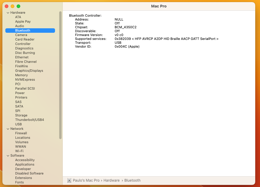

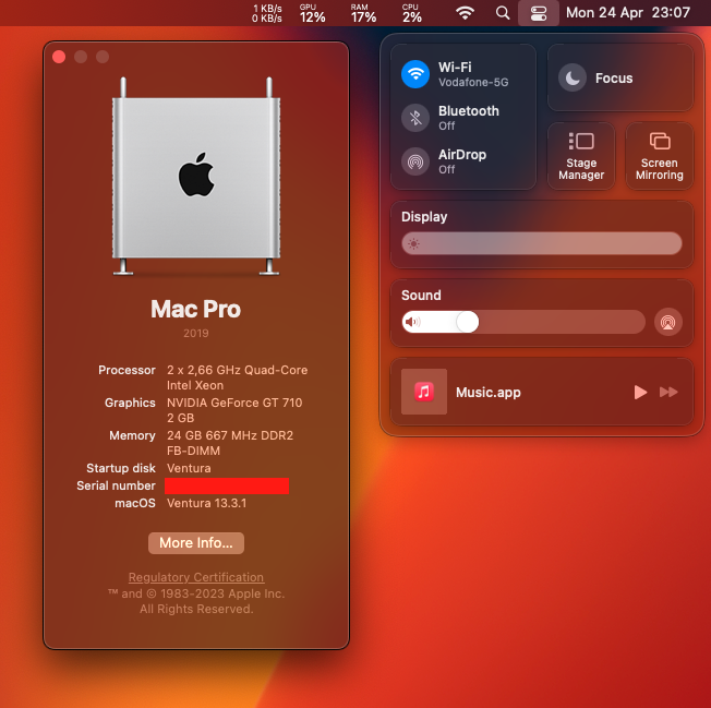

analise Posted April 25, 2023 Share Posted April 25, 2023 Hi all, I finally managed to install Ventura 13.3.1 in my HP OLD rig, see below, I have the same card as you(T919), and my problem is not Wifi, but Bluetooth. I have Monterey in the same machine, different SSD and it works fine with the USBMap done for this machine in Catalina. My supposition is that the internal USB that I think it's USB1.1 is the problem, although I have USB1.1-Injector.kext in the config. Any help would be appreciated. Thanks. Quote Link to comment https://www.insanelymac.com/forum/topic/356486-wifi-crashes-the-system-in-monterey-with-the-fenvi-t919/#findComment-2804004 Share on other sites More sharing options...
analise Posted April 25, 2023 Share Posted April 25, 2023 1 hour ago, eSaF said: USB Mapping or lack of is possibly the problem here. As an experiment, if you have USBPort.kext, disable it and add the USBInjectAll.kext, reboot reset Nvram and see if the B/Tooth is activated/available once you reach the Desktop. Thanks for your reply. I have USBMap.kext, the same I use in the Monterey without any problems. I already done that test using USBInjectAll instead, but no go! Quote Link to comment https://www.insanelymac.com/forum/topic/356486-wifi-crashes-the-system-in-monterey-with-the-fenvi-t919/#findComment-2804011 Share on other sites More sharing options...

analise Posted April 25, 2023 Share Posted April 25, 2023 3 hours ago, eSaF said: If as you say B/Tooth works in Monterey, then obviously something is amiss in Ventura why it's not working. My first thought was a USB Mapping problem but you dispelled that notion as the result was the same with USBInjectAll.kext. This maybe a bit out there so to speak but try if you can move the card to another Slot if available, mine is situated in the last Slot of the Motherboard. Definitely is something to try, mine is in the first slot. But one of the experiences I already done was changing the graphic card to the other slot and an USB3 expansion card to other, and Ventura stopped to boot, every USB port was dead. After return everything to initial position, booted again... well I know it's a bit odd but that's what happened. This problem didn't happened with the Monterey. Some kext must be interfering with bluetooth. I upload my EFI/config.plist if you wish to take a peek. And thanks for the help. config.plist 1 Quote Link to comment https://www.insanelymac.com/forum/topic/356486-wifi-crashes-the-system-in-monterey-with-the-fenvi-t919/#findComment-2804026 Share on other sites More sharing options...

analise Posted May 5, 2023 Share Posted May 5, 2023 On 5/1/2023 at 11:21 PM, eSaF said: That is truly baffling, through every OS X version my T-919 Combo card worked OOB without any tinkering from version to version and up-grades to up-grades. I know this may sound a bit far fetched but at this point, I would personally do a complete reinstall considering all possible options has been exhausted trying to solve the problem to no avail. My thinking is B-Tooth works OOB in a previous OS X version so theoretically it should also work in Ventura OOB as well. Finally, after update to the last OCLP 0.6.5, BT started. As we all suspected this was a problem with USBs, a problem that this version addressed. So now I have a full hack working! Thanks again for your support! 1 Quote Link to comment https://www.insanelymac.com/forum/topic/356486-wifi-crashes-the-system-in-monterey-with-the-fenvi-t919/#findComment-2804359 Share on other sites More sharing options...
