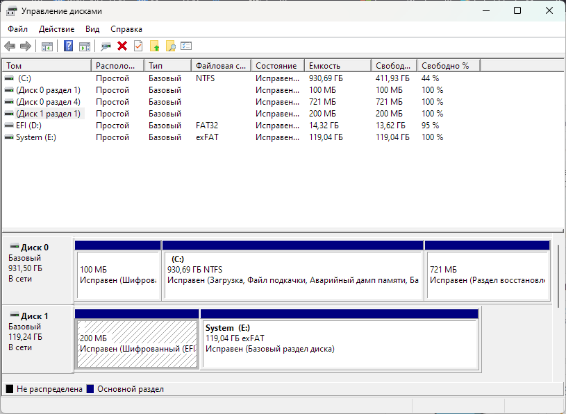

ONATHEMA Posted April 6, 2023 Share Posted April 6, 2023 Hello! After making EFI by dortania's guide stuck on usb installation, macOS installing not starts only reboots afte lines goes down. My hardware: CPU Ryzen 7 3800x GPU XFX radeon 6600xt two m2 SSD nvme one with Windows, second was EndeveaourOS (macOS gonna be there) 32 GB ram aourus pro ax b550 Open core 0.9.2 DEBUG release What's it could be? I suspect it's related to No EFI partition on the second disk (where I plan to install Ventura) ? Because hardware was recognized successfully. attaching my log opencore-2023-04-05-232839.txt Quote Link to comment https://www.insanelymac.com/forum/topic/356278-reboot-loop-while-tryin-install-macos-133/ Share on other sites More sharing options...
ONATHEMA Posted April 6, 2023 Author Share Posted April 6, 2023 I unplugged the first disk (with windows11), and the situation has changed: now after a quick run of lines, there is no signal on the monitor and just a black screen (as if the computer fell asleep). BTW, i've format second disk and make special partition EFI. opencore-2023-04-06-221530.txt Quote Link to comment https://www.insanelymac.com/forum/topic/356278-reboot-loop-while-tryin-install-macos-133/#findComment-2803231 Share on other sites More sharing options...
Slice Posted April 7, 2023 Share Posted April 7, 2023 But you can't install macOS on exFAT partition. You should reformat it to APFS. Quote Link to comment https://www.insanelymac.com/forum/topic/356278-reboot-loop-while-tryin-install-macos-133/#findComment-2803266 Share on other sites More sharing options...
ONATHEMA Posted April 7, 2023 Author Share Posted April 7, 2023 (edited) 51 minutes ago, Slice said: But you can't install macOS on exFAT partition. You should reformat it to APFS. After added to boot-args agdpmod=pikera I've got an install menu, then via disk utility format disk with apfs and installed Ventura. After that in OpenCore booter I've got "macOS", then I picked it, again goes lines of debug and reboot loop. THIS VIDEO OF ISSUE opencore-2023-04-07-032755.txt Edited April 7, 2023 by ONATHEMA log attaching Quote Link to comment https://www.insanelymac.com/forum/topic/356278-reboot-loop-while-tryin-install-macos-133/#findComment-2803274 Share on other sites More sharing options...
