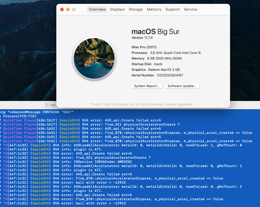

jalavoui Posted March 3, 2023 Share Posted March 3, 2023 (edited) Can we use an unsupported IGPU and GFX0 ? IGPU = 0x15d8 GFX0 = 0x6611 Credits to https://github.com/NootInc/WhateverRed Tks Some minor bugs : rip GVA Edited March 6, 2023 by jalavoui 1 Link to comment Share on other sites More sharing options...

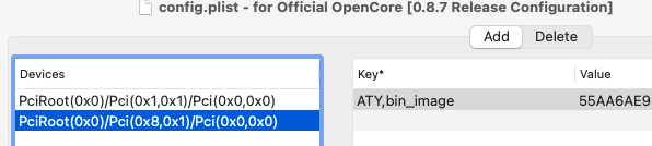

jalavoui Posted March 6, 2023 Author Share Posted March 6, 2023 (edited) This text editor crashes the graphics https://www.sublimetext.com guess dual graphic card issue ? fix is add this setting to ST "hardware_acceleration": "none" This fix power sleep issues: In order to fix boot I used the linux bios dump and injected it on opencore Edited March 6, 2023 by jalavoui Link to comment Share on other sites More sharing options...

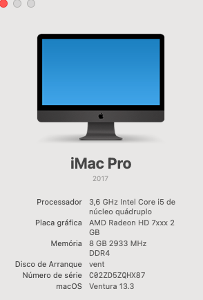

jalavoui Posted March 29, 2023 Author Share Posted March 29, 2023 (edited) both cards might work in ventura 13.3 using OCLP the gfx0 works the IGPU as a funny bug: (AMDRadeonX5000HWLibs) [8:0:0] AMD Error: (AMDRadeonX5000HWLibs) Unable to find matching firmware device type for device ID: 0x15D8 this is very good news \ the update i used on OCLP installed monterey 12.5 kexts (without 6000 kexts) Edited March 31, 2023 by jalavoui Link to comment Share on other sites More sharing options...

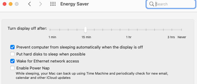

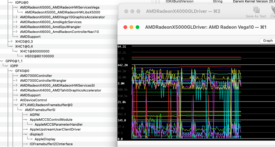

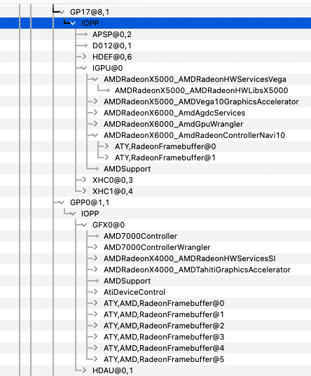

jalavoui Posted April 2, 2023 Author Share Posted April 2, 2023 (edited) Crossfire on hackintosh ? lol this kext allows booting with external gpu (GFX0) and use the accelerator provided by internal gpu (IGPU) it disables the 4000 kext accelerator What I'm doing here is booting with the external gpu and using the faster IGPU for metal/opengl btw for devs code is this void WRed::wrapSetupAndInitializeHWCapabilities(void *that) { FunctionCast(wrapSetupAndInitializeHWCapabilities, callbackWRed->orgSetupAndInitializeHWCapabilities)(that); getMember<uint32_t>(that, 0x98) = 0; } this is applied to the booting card, i.e., the card u physical plug your screen only ofc if you have a working "offcard" that loads the accelerator driver this wont work with Nootedred or any kext that patches this function maybe this helps for older macs? WhateverRedo2.kext.zip Edited April 3, 2023 by jalavoui Link to comment Share on other sites More sharing options...
