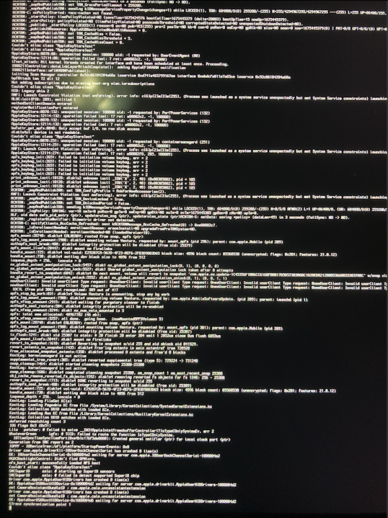

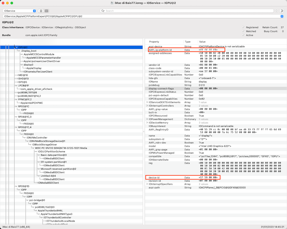

Baio77 Posted February 3, 2023 Share Posted February 3, 2023 I have the above laptop, I can't get the built-in screen video. I tried many solutions but to no avail. I attach a link to the Github repository, where the debug + EFI + Ioreg files are attached. If something is missing I will make sure to leave whatever you ask in order to fix it. https://github.com/Baio1977/Lenovo-ThinkPad-X1-Tablet-Gen3-Kabylake-r 1106525732_X1TabletOutputvideoONTB3dock.ioreg Link to comment https://www.insanelymac.com/forum/topic/355560-lenovo-thinkpad-x1-tablet-gen3-display-3k-3000x2000-black-screen-i5-8250u/ Share on other sites More sharing options...

Baio77 Posted February 3, 2023 Author Share Posted February 3, 2023 (edited) I have tested ALL of these IG-Platforms and also the Coffelake CPU ones in no case is the built in screen working. At the end of the verbose, the integrated display turns off and video appears on HDMI TB3. If I connect no devices instead of turning off the built in monitor , it stays fixed with verbose . I think it's a strange problem, not usual, on the net I find only 2 posts similar to my problem and nobody has solved it. You need a WEG and patch expert. Verbose crash when booting without connecting HDMI to external monitor Edited February 3, 2023 by Baio77 Link to comment https://www.insanelymac.com/forum/topic/355560-lenovo-thinkpad-x1-tablet-gen3-display-3k-3000x2000-black-screen-i5-8250u/#findComment-2800959 Share on other sites More sharing options...
aben Posted February 4, 2023 Share Posted February 4, 2023 Are you able to get output to internal display without accel. i.e -igfxvesa Have you tried boot-args (with WEG): -igfxtypec -disablegfxfirmware Link to comment https://www.insanelymac.com/forum/topic/355560-lenovo-thinkpad-x1-tablet-gen3-display-3k-3000x2000-black-screen-i5-8250u/#findComment-2800972 Share on other sites More sharing options...
Baio77 Posted February 4, 2023 Author Share Posted February 4, 2023 I did a lot of tests are 2 days go crazy on this problem. I also read it could be DVMT seen has bios locked. The question is this: If it was DVMT how come I can display on HDMI Video connector From TB3??? How come if I start without connecting video TB3 it doesn't go to KP and remains on verbose??? Link to comment https://www.insanelymac.com/forum/topic/355560-lenovo-thinkpad-x1-tablet-gen3-display-3k-3000x2000-black-screen-i5-8250u/#findComment-2801004 Share on other sites More sharing options...
