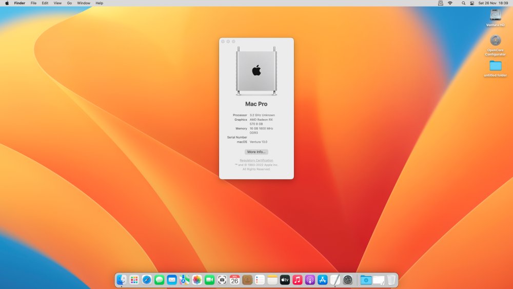

DMhackintosh Posted November 26, 2022 Share Posted November 26, 2022 (edited) Hey guy I installed Ventura successfully on ivy bridge but msi rx 570 doesn't work, anyone have a solution? thanks in advance 1155 ivy bridge Intel Core i5 3470 Ventura beta 4 OC 0.8.5 Edited November 26, 2022 by diamondhackintosh Link to comment Share on other sites More sharing options...
aben Posted November 26, 2022 Share Posted November 26, 2022 (edited) AMD Polaris cards are still supported in Ventura natively (Metal 2) however you will lose acceleration if these GPUs are paired with a CPU that lacks AVX2.0 instruction set (pre Haswell). To restore QE/CI support, you will need to migrate to OpenCore Legacy Patcher v0.5.0 and above. More info here Please note that OCLP project is mainly developed for real Macs, not hackintoshes, and thus lacks proper documentation for PC users, you'll have to research this bit on your own. (P.S: Do utilize the search bar above and you should find lots of helpful posts/threads here from users who have reported/documented their successful Ventura installs with help of OCLP) Edited November 26, 2022 by aben 1 Link to comment Share on other sites More sharing options...
DMhackintosh Posted November 26, 2022 Author Share Posted November 26, 2022 2 minutes ago, aben said: AMD Polaris cards are still supported in Ventura natively (Metal 2) however you will lose acceleration if these GPUs are paired with a CPU that lacks AVX2.0 instruction set (pre Haswell). To restore QE/CI support, you will need to migrate to OpenCore Legacy Patcher v0.5.0 and above. More info here Please note that OCLP project is mainly developed for real Macs, not hackintoshes, and thus lacks proper documentation for PC users, you'll have to research this bit on your own. (P.S: Do utilize the search bar above and you should find lots of helpful posts/threads here from users who have reported/documented their successful Ventura installs with help of OCLP) Thank you very much bro I will try it Link to comment Share on other sites More sharing options...

CrashMidnick Posted November 28, 2022 Share Posted November 28, 2022 You need to patch from Ventura itself, not from the boot loader or any boot device. Boot devices are made for real Macs, not hackintoshes. 1 Link to comment Share on other sites More sharing options...
DMhackintosh Posted November 29, 2022 Author Share Posted November 29, 2022 14 hours ago, CrashMidnick said: You need to patch from Ventura itself, not from the boot loader or any boot device. Boot devices are made for real Macs, not hackintoshes. I've successfully patched Ventura, but at first I was confused how to create a Bootable USB with OCLP only. I've created a Bootable USB by other means and only using OCLP Patch, success happened. 1 Link to comment Share on other sites More sharing options...
