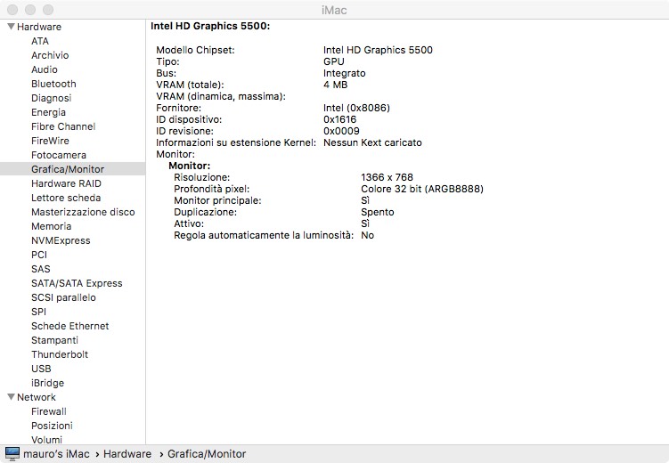

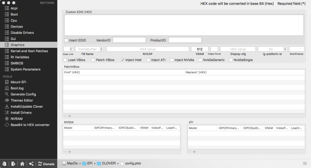

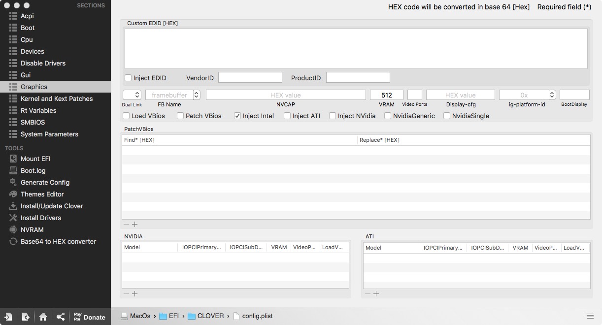

mauro26 Posted November 19, 2022 Share Posted November 19, 2022 (edited) Hi all, I'm dealing with my first days in Hackintosh installation, Sierra 10.12.6. After having solved ethernet card detection for connection (and previously by Android driver for USB cellphone hotspot thanks to Horndis driver), now I just obtained my gpu chipset detection selecting INTEL INJECTION on Clover Configurator. There, I also tried to increase the VRAM size with only shows 4 Mb, by setting 512 in the VRAM field but after reboot could not see a different value, still 4 Mb: I'd like to expand my graphics capacity , can suggest me how to proceed? Also attach here my iorey and bootlog. Thank you all 1435000487_maurosiMac.ioreg bootlog.log.txt Edited November 19, 2022 by mauro26 Quote Link to comment https://www.insanelymac.com/forum/topic/354834-sierra-gpu-intel-hd5500-detected-but-vram-4-mb-unchangaeble/ Share on other sites More sharing options...

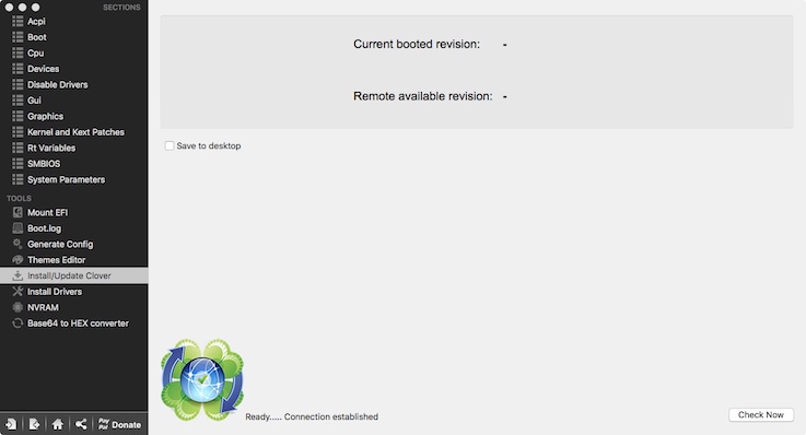

mauro26 Posted November 20, 2022 Author Share Posted November 20, 2022 (edited) 14 hours ago, Slice said: 1. Why Clover 4012? I don't remember how it works. 2. Why legacy boot? The computer is able to boot UEFI. 3. Why Sierra? You can boot Ventura. Hi Slice, thank you for answering. I haven't chosen the actual version-configuration of my Hackintosh which was the only one I could install on my laptop -specifications in signature- , but trying to get in a more handleable situation acting as the beginner that I am, that's why I'm here. So, my answers are: 1 you already answered to me in another post here about the need to update Clover version in order to upgrade the macOS Sierra to a newer one, I have difficulties in this, as the Clover Configurator in Clover Install-Update section does nothing; not showing actual version, not finding updates as click in check now gadget 2 I installed this Hackintosh on a USB pen drive and boot from there, don't know how/if UEFI vs LEGACY mode can be modified 3 reason why Sierra, is -repeat- that I found this Hackintosh as the only fitting an installation for my laptop configuration and now I'm trying to evolve in a better situation starting from here. If you say that I can operate to install Ventura version on the USB Pendrive meeting my laptop specs I'm the first one interested and happy for this. My limit is the knowledge on MacOs environment being very basic but I'm so much curious since I've realised something with my actual installation. Edited November 20, 2022 by mauro26 Quote Link to comment https://www.insanelymac.com/forum/topic/354834-sierra-gpu-intel-hd5500-detected-but-vram-4-mb-unchangaeble/#findComment-2797508 Share on other sites More sharing options...
Slice Posted November 20, 2022 Share Posted November 20, 2022 Clover Configurator can't update Clover 4xxx. Actual revision 5150 is far from here. https://github.com/CloverHackyColor/CloverBootloader/releases When you choose booting device USB you may also choose UEFI boot from USB. See carefully. Quote Link to comment https://www.insanelymac.com/forum/topic/354834-sierra-gpu-intel-hd5500-detected-but-vram-4-mb-unchangaeble/#findComment-2797522 Share on other sites More sharing options...

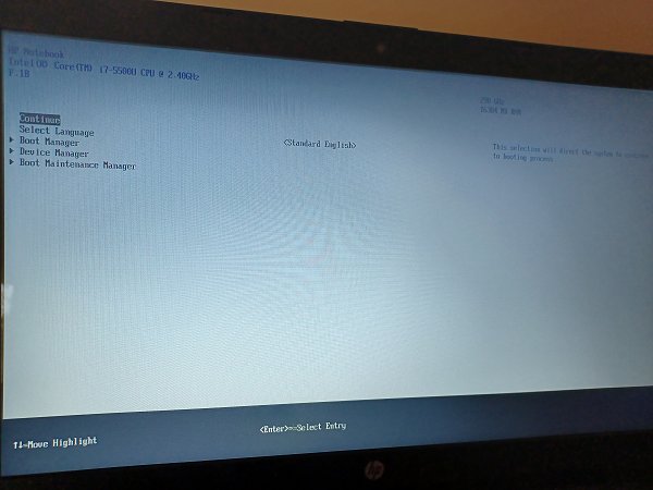

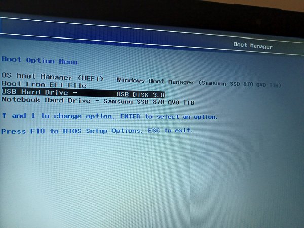

mauro26 Posted November 25, 2022 Author Share Posted November 25, 2022 (edited) ok, installed Clover 5150 , at reboot I'm stuck because as select like before the USB volume containing MacOs , now I land in a next UEFI menu which does not contain any useful option/item to boot from that USB, I've explored all menu's option. Luckily I've a backup USB pendrive for cloning and reinstate the previous situation on the other one. I need more knowledge and a bit of more encouraging help, as tried to say before Edited November 25, 2022 by mauro26 Quote Link to comment https://www.insanelymac.com/forum/topic/354834-sierra-gpu-intel-hd5500-detected-but-vram-4-mb-unchangaeble/#findComment-2797768 Share on other sites More sharing options...
Slice Posted November 25, 2022 Share Posted November 25, 2022 You see this menu because the boot file can't find the file /EFI/CLOVER/CLOVERX64.EFI on the same drive. Quote Link to comment https://www.insanelymac.com/forum/topic/354834-sierra-gpu-intel-hd5500-detected-but-vram-4-mb-unchangaeble/#findComment-2797774 Share on other sites More sharing options...

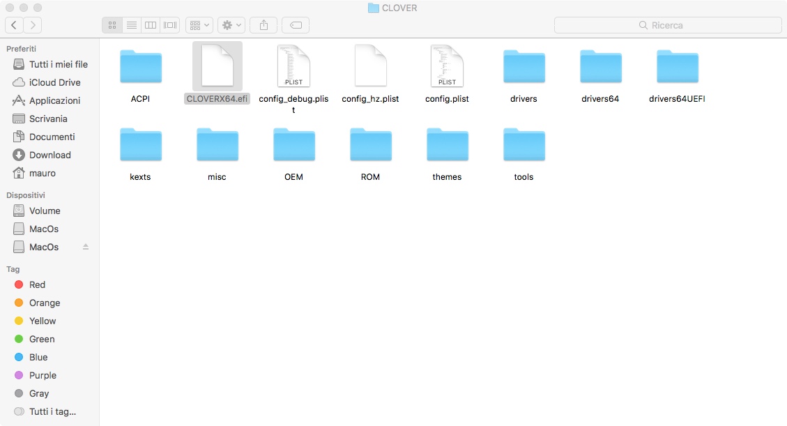

mauro26 Posted November 26, 2022 Author Share Posted November 26, 2022 (edited) ok, by booting from the backup usb volume I then can plug the other volume and browse its folders after Clover 5150 installation. /EFI/CLOVER/CLOVERX64.EFI is there. Also attach the Clover install log found in /EFI Clover_Install_Log.txt Edited November 26, 2022 by mauro26 Quote Link to comment https://www.insanelymac.com/forum/topic/354834-sierra-gpu-intel-hd5500-detected-but-vram-4-mb-unchangaeble/#findComment-2797808 Share on other sites More sharing options...
Slice Posted November 26, 2022 Share Posted November 26, 2022 Look misc folder. Quote Link to comment https://www.insanelymac.com/forum/topic/354834-sierra-gpu-intel-hd5500-detected-but-vram-4-mb-unchangaeble/#findComment-2797827 Share on other sites More sharing options...
mauro26 Posted November 26, 2022 Author Share Posted November 26, 2022 15 minutes ago, Slice said: Look misc folder. it's empty Quote Link to comment https://www.insanelymac.com/forum/topic/354834-sierra-gpu-intel-hd5500-detected-but-vram-4-mb-unchangaeble/#findComment-2797828 Share on other sites More sharing options...

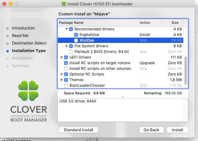

mauro26 Posted November 27, 2022 Author Share Posted November 27, 2022 well I have downloaded Clover 5150 from the link you provided. No different folder chosen while installing, left standard option. If something different had to be done I can turn back in initial situation and reinstall Clover as due Quote Link to comment https://www.insanelymac.com/forum/topic/354834-sierra-gpu-intel-hd5500-detected-but-vram-4-mb-unchangaeble/#findComment-2797851 Share on other sites More sharing options...

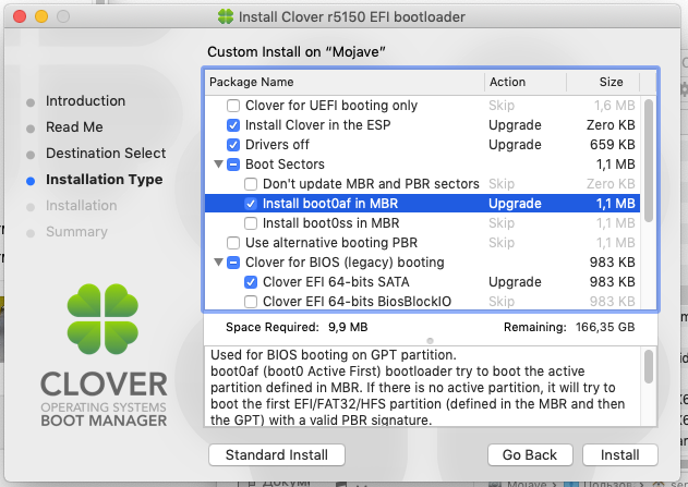

Slice Posted November 27, 2022 Share Posted November 27, 2022 2 hours ago, mauro26 said: well I have downloaded Clover 5150 from the link you provided. No different folder chosen while installing, left standard option. If something different had to be done I can turn back in initial situation and reinstall Clover as due Check these options 1 Quote Link to comment https://www.insanelymac.com/forum/topic/354834-sierra-gpu-intel-hd5500-detected-but-vram-4-mb-unchangaeble/#findComment-2797862 Share on other sites More sharing options...
Slice Posted November 27, 2022 Share Posted November 27, 2022 May be you have bad partitionned disk1? Quote Link to comment https://www.insanelymac.com/forum/topic/354834-sierra-gpu-intel-hd5500-detected-but-vram-4-mb-unchangaeble/#findComment-2797863 Share on other sites More sharing options...

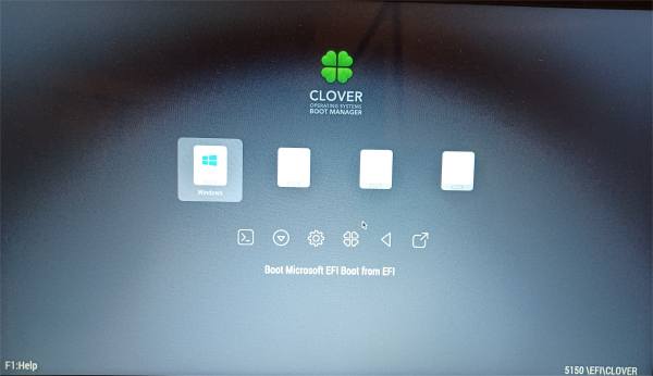

mauro26 Posted December 19, 2022 Author Share Posted December 19, 2022 (edited) On 11/27/2022 at 10:57 AM, Slice said: Check these options back again after sometime, main Windows system restored from an image saved with Rescuezilla. Ok, now I've made the C 5150 installation otions changes you suggested in the images. Clover 5150 starts in EFI mode but without detecting/showing the MacOS volume from where it runs , only Windows/NTFS volumes recognized (in the picture: one Windows partition and the other three NTFS related to it) Edited December 19, 2022 by mauro26 Quote Link to comment https://www.insanelymac.com/forum/topic/354834-sierra-gpu-intel-hd5500-detected-but-vram-4-mb-unchangaeble/#findComment-2799026 Share on other sites More sharing options...

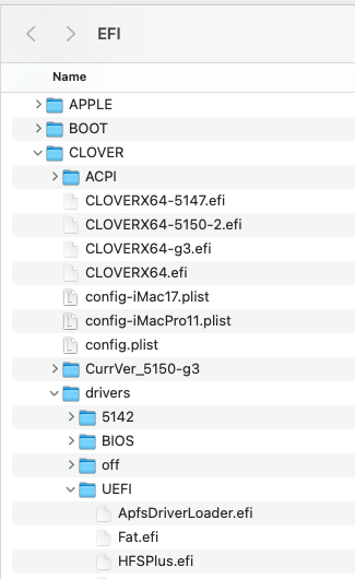

Slice Posted December 19, 2022 Share Posted December 19, 2022 41 minutes ago, mauro26 said: back again after sometime, main Windows system restored from an image saved with Rescuezilla. Ok, now I've made the C 5150 installation otions changes you suggested in the images. Clover 5150 starts in EFI mode but without detecting/showing the MacOS volume from where it runs , only Windows/NTFS volumes recognized (in the picture: one Windows partition and the other three NTFS related to it) Clover didn't see HFS+ partitions if there is no driver VboxHFS.efi. As well it will not see APFS partitions if there is no apfs.efi. See my list Quote Link to comment https://www.insanelymac.com/forum/topic/354834-sierra-gpu-intel-hd5500-detected-but-vram-4-mb-unchangaeble/#findComment-2799028 Share on other sites More sharing options...
mauro26 Posted December 20, 2022 Author Share Posted December 20, 2022 ok, see. But need instructions on next to do, as I don't understand myself how it is working then how fix it. If VboxHFS.efi is related to Virtualbox (Vbox prefix seems that) , I'm not using a virtual machine, I'm booting the system installed in an USB. Thank you Quote Link to comment https://www.insanelymac.com/forum/topic/354834-sierra-gpu-intel-hd5500-detected-but-vram-4-mb-unchangaeble/#findComment-2799049 Share on other sites More sharing options...
Slice Posted December 20, 2022 Share Posted December 20, 2022 You just need one driver for HFS+ file system. We know three variants 1. HFSPlus.efi found somewhere. 2. VboxHFS.efi distributed in Clover release. 3. OpenHFS... distributed with OpenCore. Quote Link to comment https://www.insanelymac.com/forum/topic/354834-sierra-gpu-intel-hd5500-detected-but-vram-4-mb-unchangaeble/#findComment-2799052 Share on other sites More sharing options...
