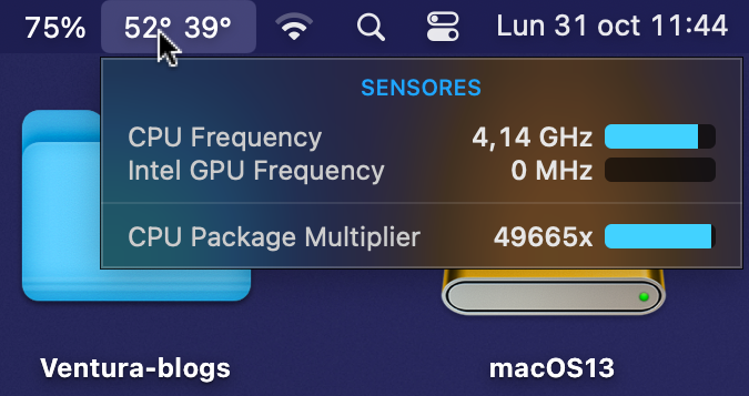

miliuco Posted October 31, 2022 Share Posted October 31, 2022 (edited) Good morning, when using Clover I see in the menu bar (iStat Menus sensors) an item CPU Package Multiplier with a value of 49665x (it changes but always with this format). This value is a bit strange for me. Can it be changed in any way to see values more understandable? Spoiler Edited October 31, 2022 by miliuco Link to comment https://www.insanelymac.com/forum/topic/354628-cpu-package-multiplier-in-clover/ Share on other sites More sharing options...

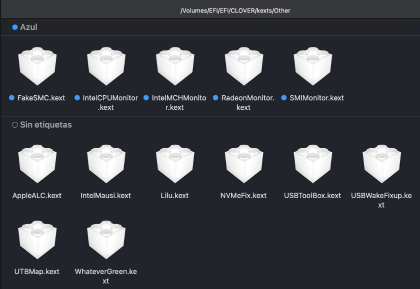

miliuco Posted October 31, 2022 Author Share Posted October 31, 2022 Yes, these are in use, last FakeSMC release with plugins. Spoiler Link to comment https://www.insanelymac.com/forum/topic/354628-cpu-package-multiplier-in-clover/#findComment-2796320 Share on other sites More sharing options...

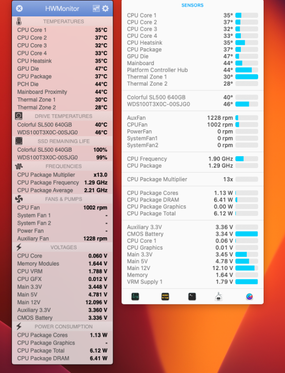

naiclub Posted October 31, 2022 Share Posted October 31, 2022 (edited) Spoiler Mine is using RehabMan-FakeSMC-2018-0915. is the latest version And it's showing the most direct value. Edited October 31, 2022 by naiclub Link to comment https://www.insanelymac.com/forum/topic/354628-cpu-package-multiplier-in-clover/#findComment-2796321 Share on other sites More sharing options...

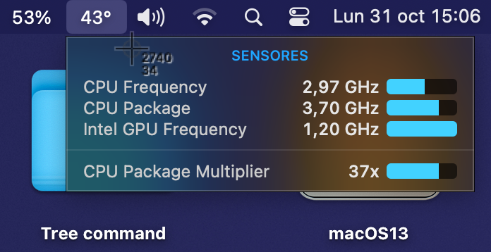

miliuco Posted October 31, 2022 Author Share Posted October 31, 2022 (edited) @naiclub I see, changing to RehabMan release and plugins the multiplier value is right. Spoiler Edited October 31, 2022 by miliuco 1 Link to comment https://www.insanelymac.com/forum/topic/354628-cpu-package-multiplier-in-clover/#findComment-2796323 Share on other sites More sharing options...

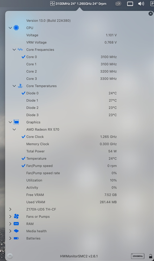

Slice Posted October 31, 2022 Share Posted October 31, 2022 This is my way and my sensors There is no multiplier because of confusion with other sensors. But different applications has different interpretations of this SMC key. May be depends on SMBIOS model. 2 Link to comment https://www.insanelymac.com/forum/topic/354628-cpu-package-multiplier-in-clover/#findComment-2796330 Share on other sites More sharing options...
