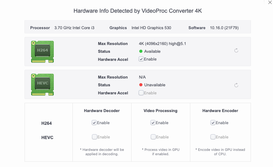

ichelash Posted October 29, 2022 Share Posted October 29, 2022 (edited) Hey, can someone HELP me out here, can't quite figure how to fix this HEVC on my rig, Skylake Intel core i3-6100 Intel HD 530 My EFI EFI.zip Edited October 29, 2022 by ichelash Quote Link to comment https://www.insanelymac.com/forum/topic/354617-monterey-fix-hevc/ Share on other sites More sharing options...
Anto65 Posted October 29, 2022 Share Posted October 29, 2022 try remove the line : AAPL,slot-name ... Internal@0,2,0 https://dortania.github.io/OpenCore-Install-Guide/config.plist/skylake.html#add-2 2 Quote Link to comment https://www.insanelymac.com/forum/topic/354617-monterey-fix-hevc/#findComment-2796239 Share on other sites More sharing options...

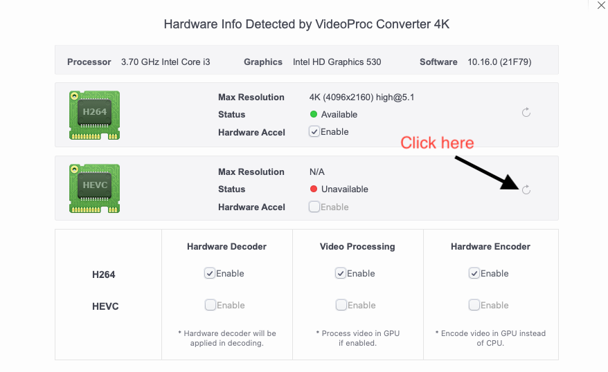

Slice Posted October 30, 2022 Share Posted October 30, 2022 13 hours ago, ichelash said: Hey, can someone HELP me out here, can't quite figure how to fix this HEVC on my rig, Skylake Intel core i3-6100 Intel HD 530 What if you click here? Quote Link to comment https://www.insanelymac.com/forum/topic/354617-monterey-fix-hevc/#findComment-2796246 Share on other sites More sharing options...
ichelash Posted October 30, 2022 Author Share Posted October 30, 2022 48 minutes ago, Slice said: What if you click here? It didn't work @Slice 12 hours ago, antuneddu said: try remove the line : AAPL,slot-name ... Internal@0,2,0 https://dortania.github.io/OpenCore-Install-Guide/config.plist/skylake.html#add-2 Thanks Solved the issue with this 2 Quote Link to comment https://www.insanelymac.com/forum/topic/354617-monterey-fix-hevc/#findComment-2796247 Share on other sites More sharing options...
