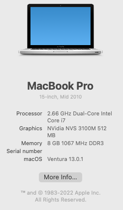

deeveedee Posted November 13, 2022 Author Share Posted November 13, 2022 (edited) I upgraded this old Dell Latitude E6410 to Ventura 13.0.1. I'm amazed! Ventura runs better on this old hack than Monterey. I have rebooted Ventura a few times and have not experienced the boot issue that I see with Monterey. @Stefanalmare - you were right! Ventura does work well! I'm using the same EFI that I posted here for Big Sur and Monterey. About this Mac: Ventura 13.0.1 Spoiler EDIT: As is the case with Monterey, the webcam and bluetooth are not yet working in Ventura. EDIT2: While it's nice to have the "bragging rights" and to be able to say that I'm able to boot and run Monterey and Ventura on a 2010 Dell laptop, by far the best user experience is with Big Sur. Big Sur is more responsive, has working bluetooth and webcam and still runs current apps. The only current app that I'd want to run but can't with Big Sur is Xcode 14. EDIT3: It appears that Nvidia graphics acceleration is still a work-in-progress for OCLP / Ventura. I applied Post-install patches to Ventura using OCLP 0.5.1 [RELEASE] and OCLP 0.5.2 [DEVELOPMENT]. I am unable to open Microsoft Word in Ventura. Still, just the fact that Ventura installs, boots flawlessly and runs is significant progress. OCLP status does report that work on MBP6,2 is on-going. Edited November 13, 2022 by deeveedee 2 Link to comment https://www.insanelymac.com/forum/topic/354497-guide-dell-latitude-e6410-nvidia-hackintosh-big-sur-monterey-ventura-sonoma-sequoia-tahoe-installations-with-open-core-legacy-patching/page/3/#findComment-2797157 Share on other sites More sharing options...
Stefanalmare Posted November 13, 2022 Share Posted November 13, 2022 "EDIT: As is the case with Monterey, the webcam and bluetooth are not yet working in Ventura." Congrats! For sure bluetooth works with another SMBIOS. 1 Link to comment https://www.insanelymac.com/forum/topic/354497-guide-dell-latitude-e6410-nvidia-hackintosh-big-sur-monterey-ventura-sonoma-sequoia-tahoe-installations-with-open-core-legacy-patching/page/3/#findComment-2797179 Share on other sites More sharing options...

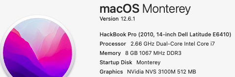

deeveedee Posted November 23, 2022 Author Share Posted November 23, 2022 I changed my hack's CPU description so that "About This Mac" shows that my hack is a Dell Latitude E6410. About This Hack: Monterey 12.6.1 Spoiler If you want to change the CPU description of your hack, you can follow my instructions here. Note that instructions for Ventura are different. 1 1 Link to comment https://www.insanelymac.com/forum/topic/354497-guide-dell-latitude-e6410-nvidia-hackintosh-big-sur-monterey-ventura-sonoma-sequoia-tahoe-installations-with-open-core-legacy-patching/page/3/#findComment-2797625 Share on other sites More sharing options...

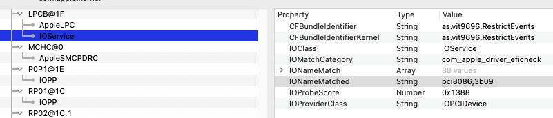

deeveedee Posted December 2, 2022 Author Share Posted December 2, 2022 Since OCLP adds RestrictEvents.kext, I have enabled RestrictEvents.kext in my BigSur EFI. With RestrictEvents.kext, I no longer need EFICheckDisabler.kext, so I have removed EFICheckDisabler.kext from my BigSur EFI. This change will be included in the next EFI that I post for Big Sur. Spoiler 1 Link to comment https://www.insanelymac.com/forum/topic/354497-guide-dell-latitude-e6410-nvidia-hackintosh-big-sur-monterey-ventura-sonoma-sequoia-tahoe-installations-with-open-core-legacy-patching/page/3/#findComment-2798177 Share on other sites More sharing options...

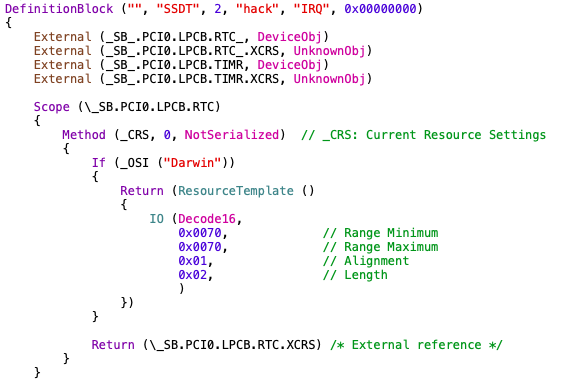

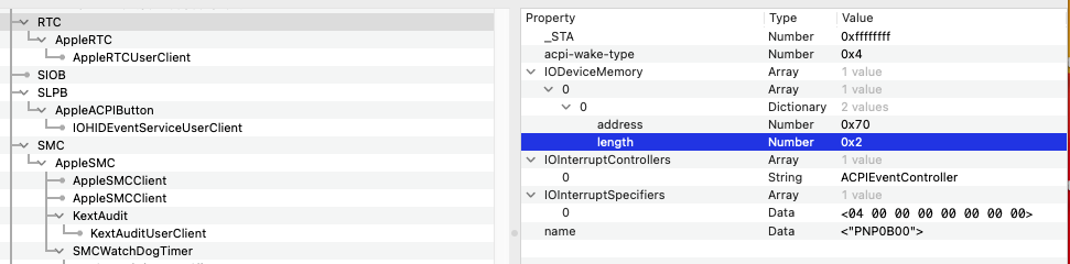

deeveedee Posted December 2, 2022 Author Share Posted December 2, 2022 (edited) My HackBookPro6,2 EFI includes a redefinition of RTC._CRS to change RTC memory length from 8 to 2 and to remove IRQNoFlags. My SSDT includes an External declaration of the original (renamed) RTC.XCRS as UnknownObj as shown below. I don't know how to explicitly declare a ResourceTemplate object for External reference. Does anyone know the proper External declaration type for a ResourceTemplate object (e.g., something like ResTmpObj)? External declaration of ResourceTemplate object: What should I use instead of UnknownObj? Spoiler Edited December 2, 2022 by deeveedee Link to comment https://www.insanelymac.com/forum/topic/354497-guide-dell-latitude-e6410-nvidia-hackintosh-big-sur-monterey-ventura-sonoma-sequoia-tahoe-installations-with-open-core-legacy-patching/page/3/#findComment-2798181 Share on other sites More sharing options...
Slice Posted December 3, 2022 Share Posted December 3, 2022 9 hours ago, deeveedee said: My HackBookPro6,2 EFI includes a redefinition of RTC._CRS to change RTC memory length from 8 to 2 and to remove IRQNoFlags. My SSDT includes an External declaration of the original (renamed) RTC.XCRS as UnknownObj as shown below. I don't know how to explicitly declare a ResourceTemplate object for External reference. Does anyone know the proper External declaration type for a ResourceTemplate object (e.g., something like ResTmpObj)? External declaration of ResourceTemplate object: What should I use instead of UnknownObj? Hide contents Replace the whole Device(RTC). (For my mind Acidanthera's strategy to make changes in DSDT by SSDTs is wrong ab ovo) 1 1 Link to comment https://www.insanelymac.com/forum/topic/354497-guide-dell-latitude-e6410-nvidia-hackintosh-big-sur-monterey-ventura-sonoma-sequoia-tahoe-installations-with-open-core-legacy-patching/page/3/#findComment-2798195 Share on other sites More sharing options...
deeveedee Posted December 3, 2022 Author Share Posted December 3, 2022 (edited) @Slice My SSDT RTC patch works (see IORegistry screenshot below), so my question is one of curiosity and not to fix a problem. The UnknownObj declaration does not prevent the patch from working. I'm just wondering if there is an explicit External declaration type for ResourceTemplate. I have a feeling we'll be debating custom DSDT vs. SSDT until Apple completely discontinues Intel support. Maybe longer. I don't use SSDTs because of Acidanthera - I started using them when I learned that Rehabman switched from Custom DSDT to SSDT hot patches. EDIT: Note that my External declaration of XCRS is required only when not running macOS ( !_OSI("Darwin") ). I only boot macOS with OC, so my SSDTs really don't need the If (_OSI("Darwin")) conditions. I only added them in case others used my EFI. EDIT2: I don't think that making ACPI changes with SSDTs can be considered as wrong. It's simply another completely viable technique that works well. I find that making the changes with SSDTs is more challenging than making them via direct edits of the DSDT and I enjoy the challenge. The changes require much more thought which requires me to more fully understand the changes. For me, the initial SSDTs are more difficult to produce than editing the DSDT, but the end result with SSDTs is more readable and my changes are easier for me to maintain. It's just my personal opinion. IORegistry: RTC Spoiler Edited December 3, 2022 by deeveedee 1 Link to comment https://www.insanelymac.com/forum/topic/354497-guide-dell-latitude-e6410-nvidia-hackintosh-big-sur-monterey-ventura-sonoma-sequoia-tahoe-installations-with-open-core-legacy-patching/page/3/#findComment-2798210 Share on other sites More sharing options...
Slice Posted December 3, 2022 Share Posted December 3, 2022 I think ResourceTemplate can't be external declared. Moreover declare new ResourceTemplate you will not kill previous one. They both will be in place. Be careful. You should make new Method. One of them return one template and other one return other. 1 Link to comment https://www.insanelymac.com/forum/topic/354497-guide-dell-latitude-e6410-nvidia-hackintosh-big-sur-monterey-ventura-sonoma-sequoia-tahoe-installations-with-open-core-legacy-patching/page/3/#findComment-2798219 Share on other sites More sharing options...
deeveedee Posted December 3, 2022 Author Share Posted December 3, 2022 (edited) @Slice I see your point. I definitely need to give this more thought. Thank you. Edited December 3, 2022 by deeveedee Link to comment https://www.insanelymac.com/forum/topic/354497-guide-dell-latitude-e6410-nvidia-hackintosh-big-sur-monterey-ventura-sonoma-sequoia-tahoe-installations-with-open-core-legacy-patching/page/3/#findComment-2798230 Share on other sites More sharing options...
deeveedee Posted December 4, 2022 Author Share Posted December 4, 2022 (edited) I now understand why I could not find an External type declaration for ResourceTemplate. After further research of the ResourceTemplate (see ASL documentation here), a ResourceTemplate is a macro that converts a Resource to a Buffer. Since ResourceTemplate returns type Buffer, the correct External declaration of an object XCRS generated by ResourceTemplate (e.g., Name ( XCRS, ResourceTemplate () {....} ) is BuffObj. If I continue to include External declarations of XCRS (or any object generated by ResourceTemplate macro) in my SSDT-IRQ, the External declaration of XCRS would be BuffObj as follows: External (_SB_.PCI0.LPCB.RTC_, DeviceObj) External (_SB_.PCI0.LPCB.RTC_.XCRS, BuffObj) External (_SB_.PCI0.LPCB.TIMR, DeviceObj) External (_SB_.PCI0.LPCB.TIMR.XCRS, BuffObj) EDIT: I have applied the change above (UnkownObj -> BuffObj) to my SSDT-IRQ and am running Big Sur, Monterey and Ventura with this change. Edited December 4, 2022 by deeveedee Link to comment https://www.insanelymac.com/forum/topic/354497-guide-dell-latitude-e6410-nvidia-hackintosh-big-sur-monterey-ventura-sonoma-sequoia-tahoe-installations-with-open-core-legacy-patching/page/3/#findComment-2798238 Share on other sites More sharing options...
