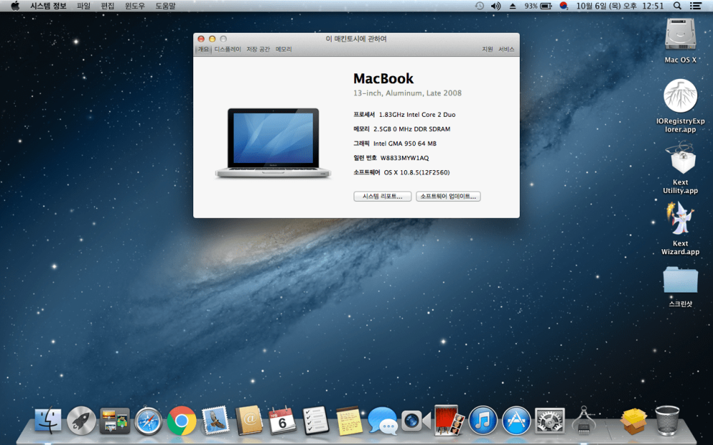

Then, when I installed mllegacygfx.pkg provided by the NexPostFacto patch tool, QE/CI acceleration of Intel GMA 950 graphics was enabled.
The minimum system requirements for OS X Mountain Lion 10.8.5 is MacBook 5,1 for the MacBook model series, so SMBIOS is set to MacBook 5,1 in Config.plist

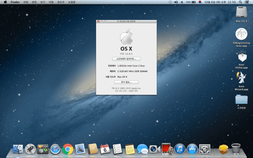

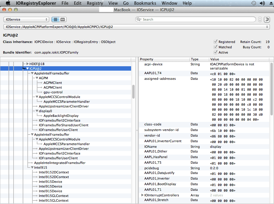

Add arch=i386 to boot-args of Config.plist to boot with 32 Bit Kernel, and set Graphics - Inject Intel to True.
Intel GMA 950 built-in graphics is recognized and Properties are automatically injected into the IGPU Device, and QE/CI is enabled.
OS X Mountain Lion 10.8.5 seems to be lighter and faster than Mac OS X Lion 10.7.5
In Lion 10.7.5, the Blur & Animation effect of Launchpad was slow and stuttered, but the Mountain Lion 10.8.5 is smooth.
